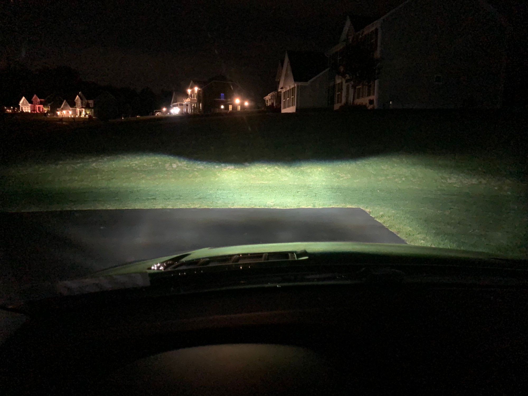

Following this thread closely. Could you please post pictures of the light cutoff, for example park your car 20ft from a wall to see if the light is controlled or scattered all over for the low beams.
Looking forward to your review!

I ended up going with the above poster’s solution as well from Aukey. Amazon link was hard for me to understand for the bulb adapters so I went on ebay instead and got it there.
I will post pictures later tonight, the light doesn’t scatter and the beam pattern and color is great!!

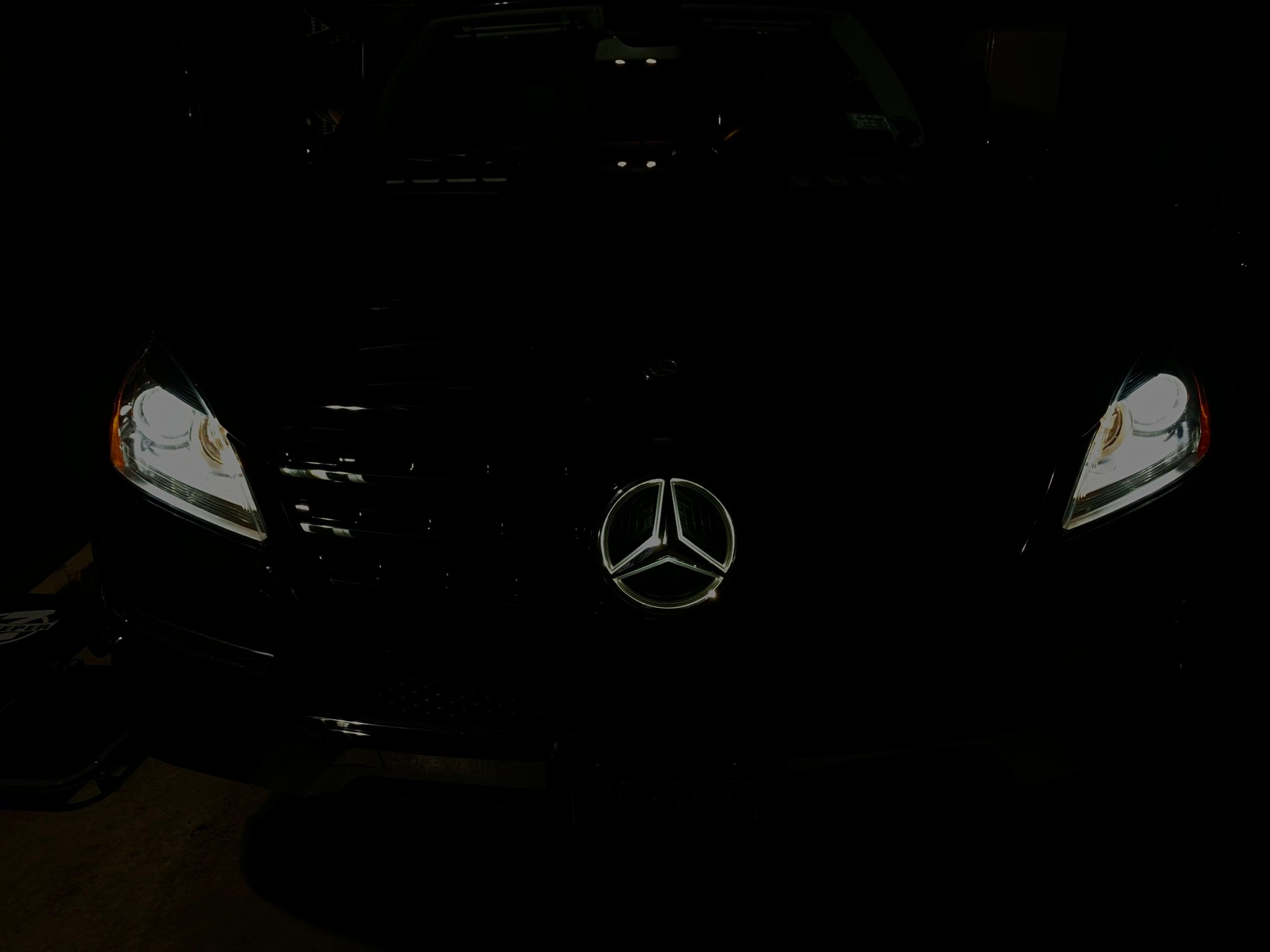

No, only the low beans and I also bought an illuminated star as well.
