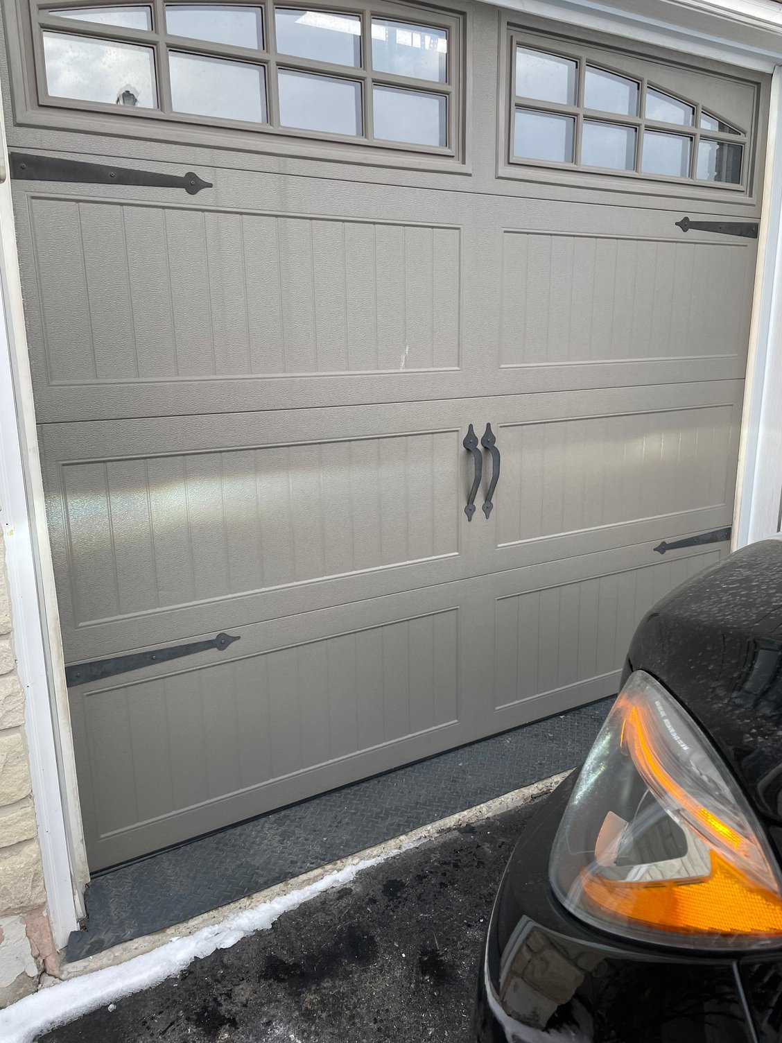

I recently upgraded my HID's to Morimoto D1s 5K, huge difference in brightness from the old bulbs:
