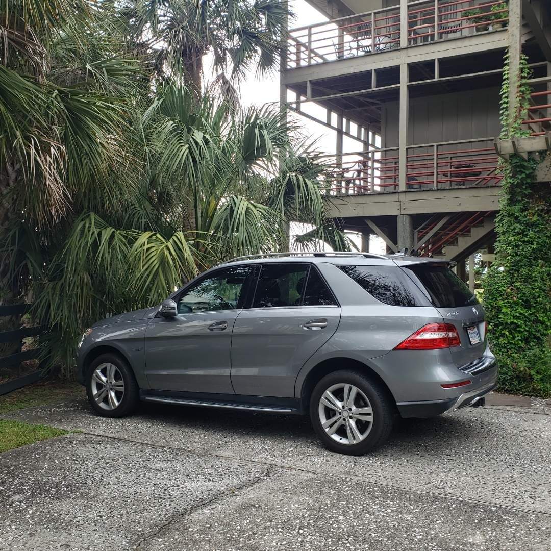

My ML-350 with 90K mikes
I really like mine but did have to take care of several things after I got it. Most notable was engine oil cooler seal leakage. At the MB dealer I was quoted $3600 to complete the repair. I imagine the bill would have been much high as I also had to air induction piping to the engine due to a worn out PCV assembly allowing excess oil to get into the air intake system. Soot and oil make a very sticky mess, but have completed all repairs myself and now have a very nice running car. Took it on the longest trip a couple of weeks ago and averaged over 34 MPG. Another repair I had to complete was replacing the rear suspension spring coils, both were broken. I really like this car thus far even with the repairs that I had to complete. I have had many Mercedes diesels and this by far is the nicest one I have owned. I have also added the OEM hitch package with factory electronic hardware and software.
