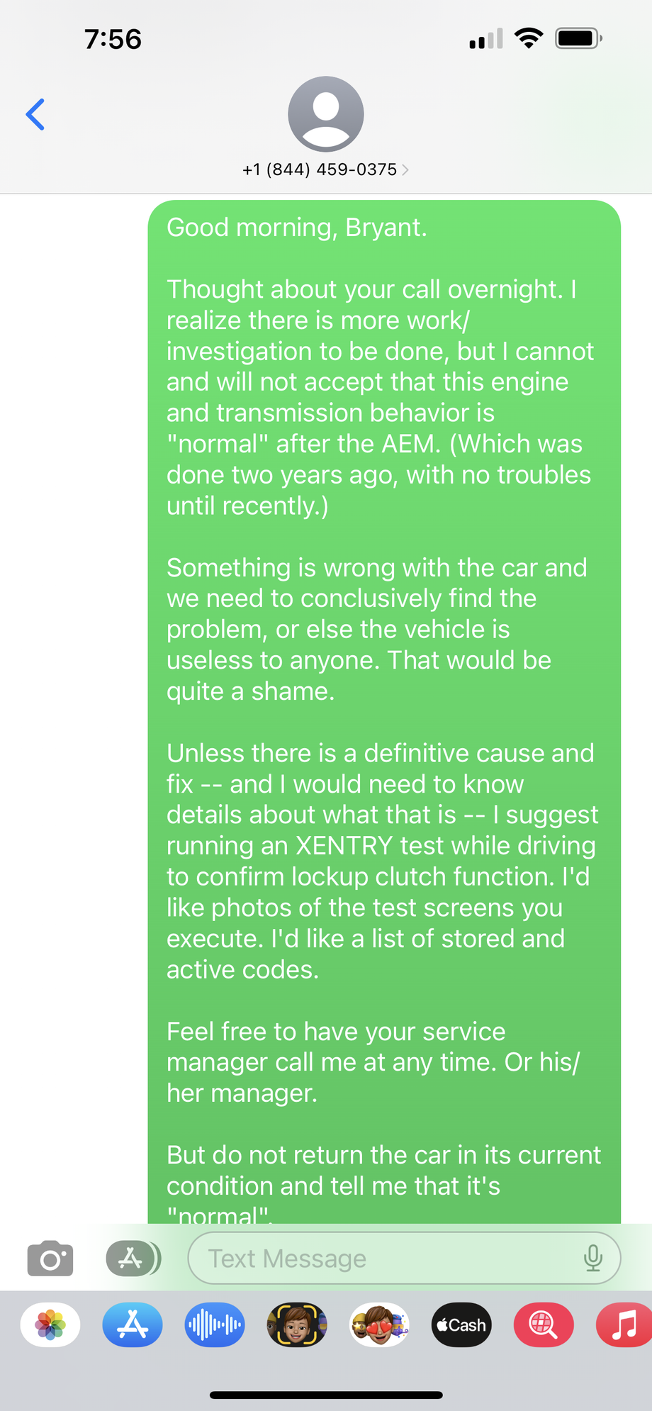

Well, okey-dokey. Let's see where this takes us: (Sorry the image is so large.)

Well, that text message seems to have worked. MB contacted me and said they found a problem, fixed it, and the car is ready for pickup.
Would someone care to review the following and see if it tracks to the problem? I realize that their note-taking leaves a lot to be desired.
For what it's worth, when they mention the regeneration of the DPF below, I find it hard to believe that over the past 8 years I've owned the car, I've not seen this type of behavior, except those times I had a similar but more acute issue that was eventually resolved and blamed on the DPF. In other words, we had multiple instances where, on trying to accelerate up a ramp onto a highway -- it always seemed to be at that kind of time -- RPMs would go way up, acceleration of any sort was very hard to achieve (limp mode?), and that behavior put us in some pretty dangerous situations... like 18-wheelers honking & wondering why we couldn't go over 20mph.
Related? "Normal"? Normal after the AEM in June of 2021?
I seek to understand what's (really) going on under the hood.

Good job on the text message to them.
The regeneration sounds plausible but I defer to others with experience with this engine and the field repair.
On the other hand, the dealer claims to have “fixed” your transmission problem by explaining an engine operating function (regen). Keep the bait-and-switch accusation ready at hand. It would be similar to a doctor telling you he solved your indigestion by explaining how your toenails grow.
@kajtek1 i think is a resident expert on MB diesels.
