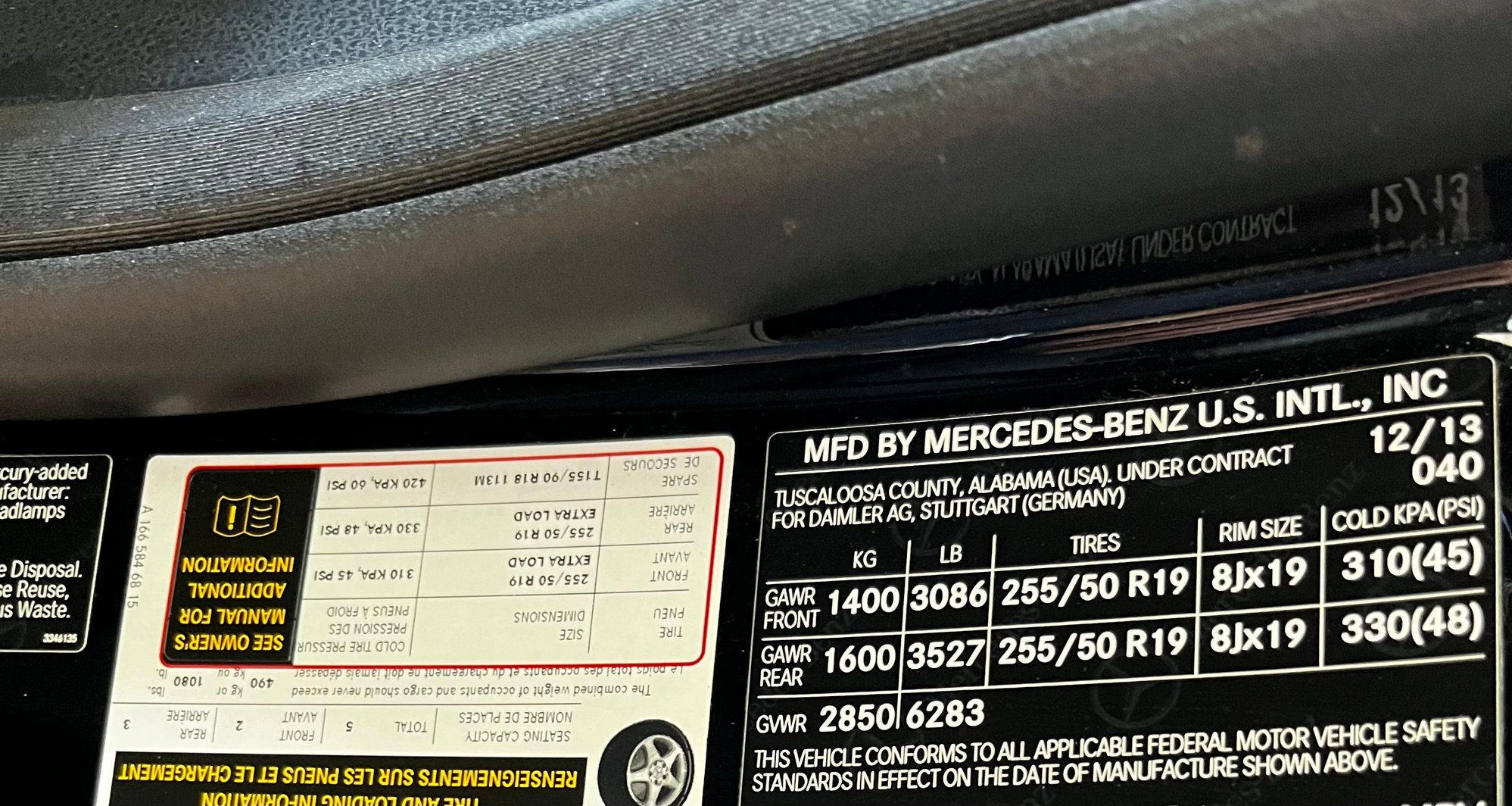

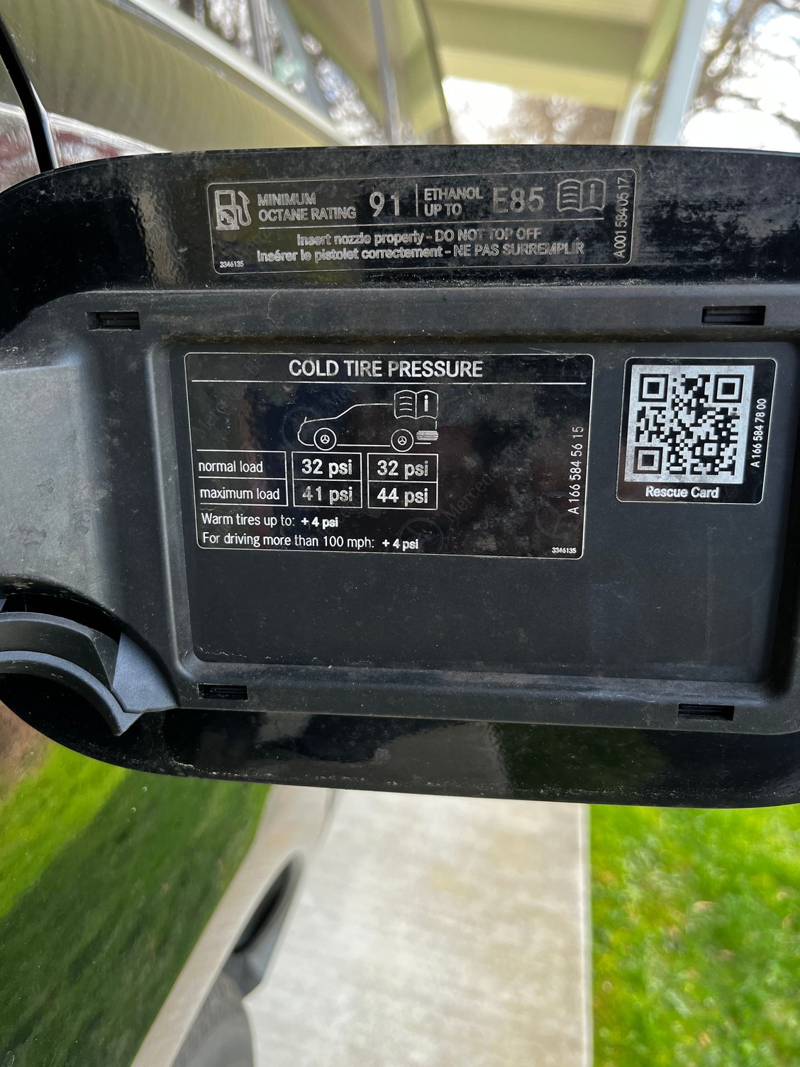

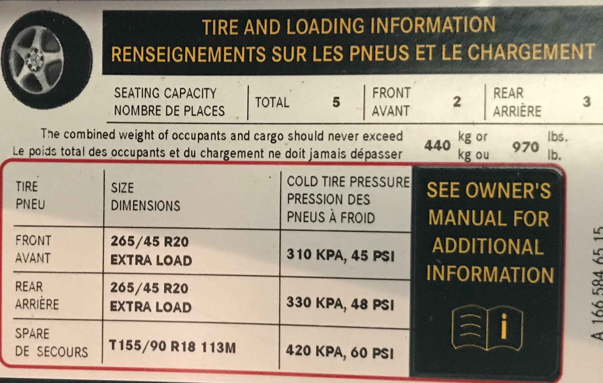

Hi, my 2014 ML350 4matic has two stickers with different tire pressure settings. The front sticker on the driver side door says cold psi 45 front and 48 rear, while the sticker on gas tank door says 32&32 cold. They differ so much that I don’t know which one to follow. I thought 45 is really high for most tires as I’ve seen most of them are 30-35 psi cold. Dealer mechanic set them as 46 &46 psi which makes me wonder if they made a mistake. I feel it’s a little bumpy on ride but not sure if that’s because it’s a heavy vehicle? My 2016 4Runner is the similar size and weight but only requires 32 & 32 psi.

The difference depends on how the vehicle is loaded. The ML350 is spec'd at 4751 lbs. curb weight and 6283 lbs. max gross weight. If you're carrying 5 passengers + cargo that approximates 1500 lbs., then go with the 45/48 psi. If you drive around alone most of the time, stick with the lower pressure (normal) at 32 psi. I don't know why the door stickers and gas flap stickers differ by 4 psi at max load. If you frequently carry a couple passengers, I'd go with an intermediate pressure.

I guess the first label is for max load + max speed.
