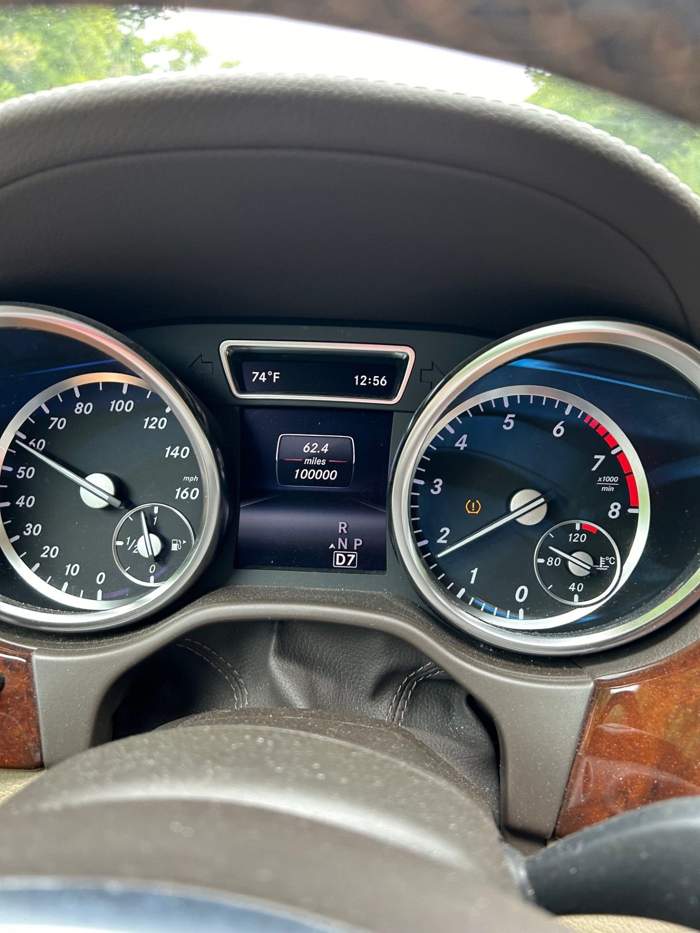

On my way to drop off my ML for brake work it reached 100,000 miles. This is the first time I've reached this milestone in a Benz; what services are recommended by MB?

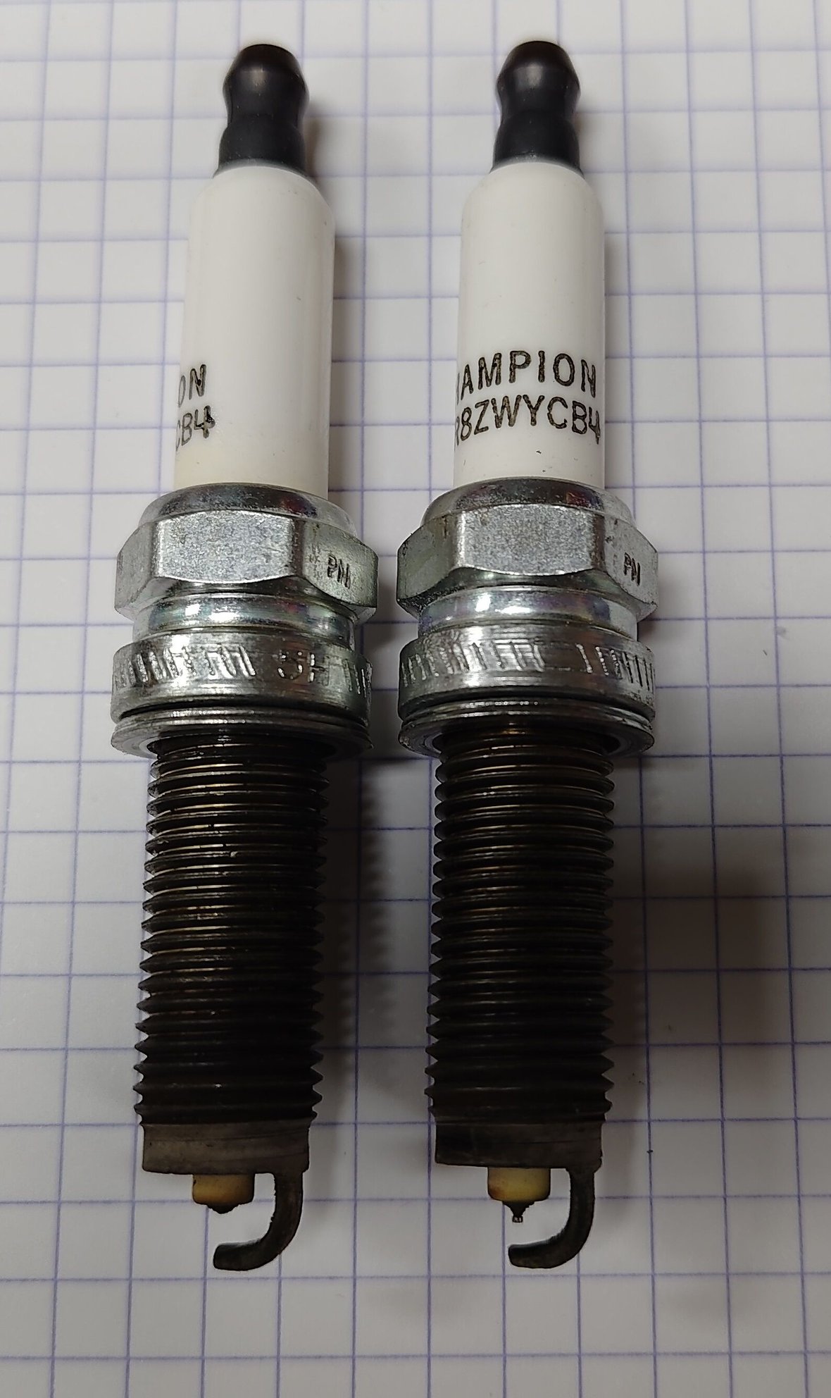

I recently did my Jeep Wrangler (Pentastar V6) OE sparkplugs at 60K, and think I should have done them a bit sooner. Half of them had eroded electrodes as shown in the pic below. Every engine is different, but sparkplugs don't last forever in any of them!
Now you have me thinking I need to do the wife's '12 grand cherokee. It's pushing 120K miles and is, I believe, on its first set of plugs. I see PB Blaster in my future.

The ones I changed in my GLS450 had very little wear at 50k miles. Uses the same engine as the ML400.
