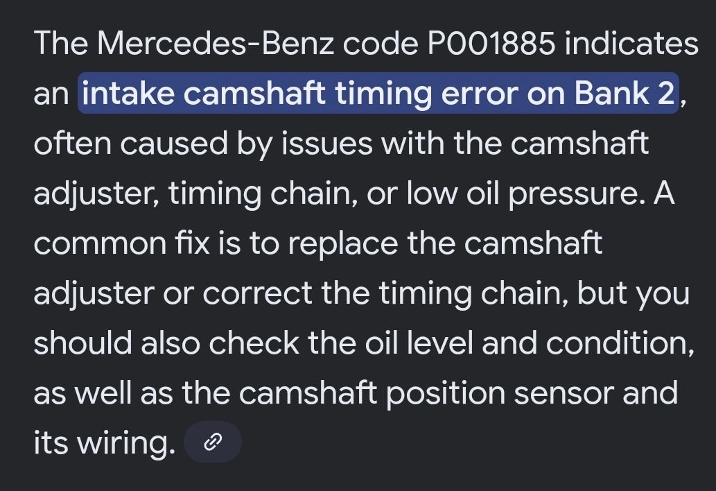

Has someone had code P001885 point to chain tensioners? It is a lot easier to replace the tensioner obviously than adjuster, but they're also not that cheap.
the answer is in part up to your testing of VVT Phaser. You say it is proven to lock well.
Now here are the other contenders :
VVT Phasers, CPS, Tensioner, bad oil pressure...
ECU can sees bad Position for multiple reasons.
Walk down the list.
