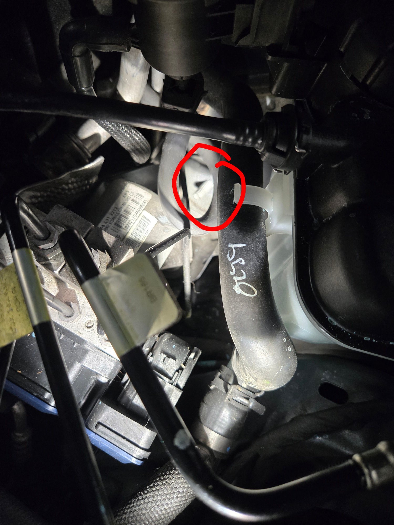

This one is relatively straightforward to get off, but getting your hand down in there to thread it back on was... it took some creativity. And determination. And luck.
You have to remove the airbox on the driver side to access it.

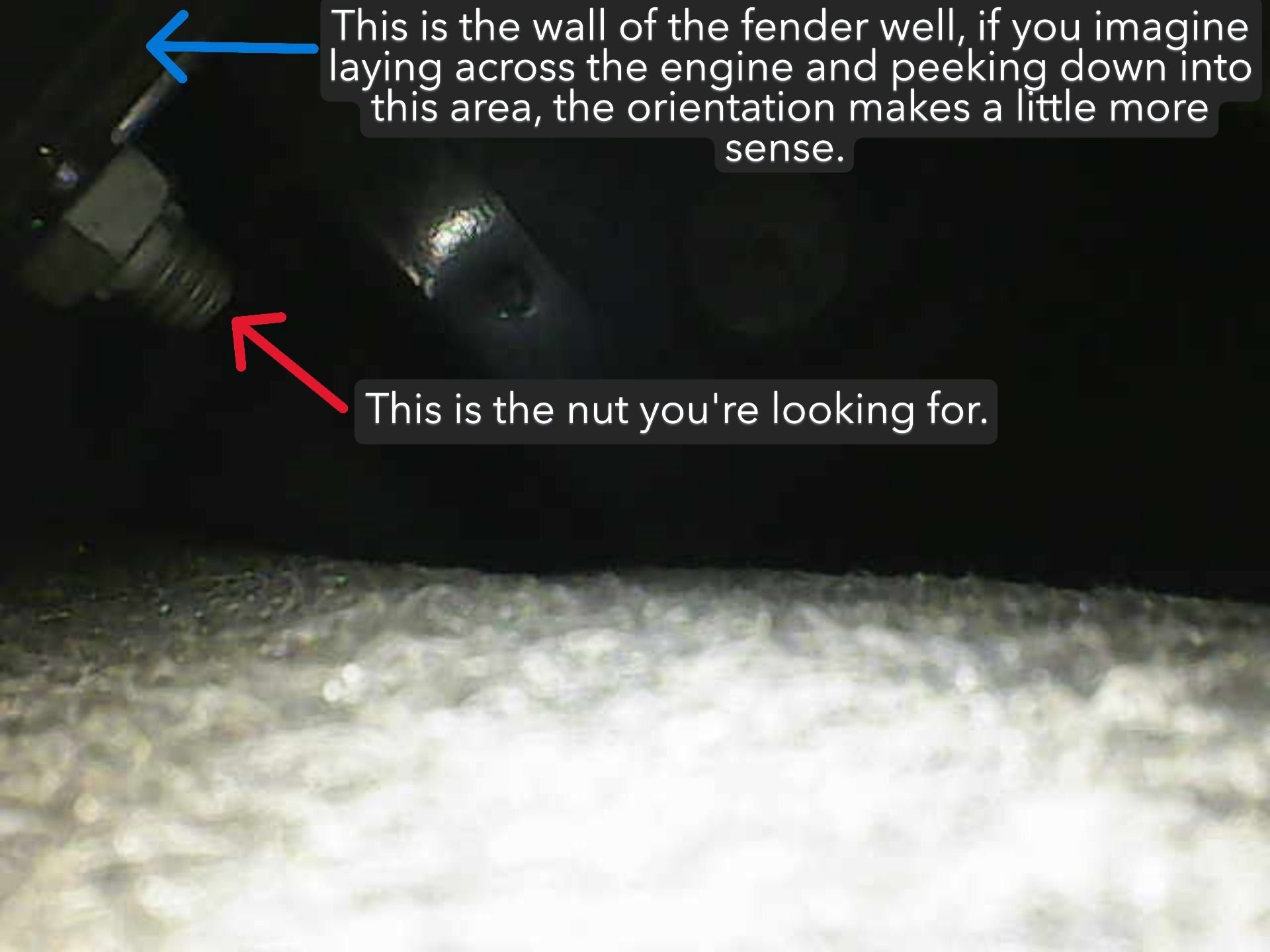

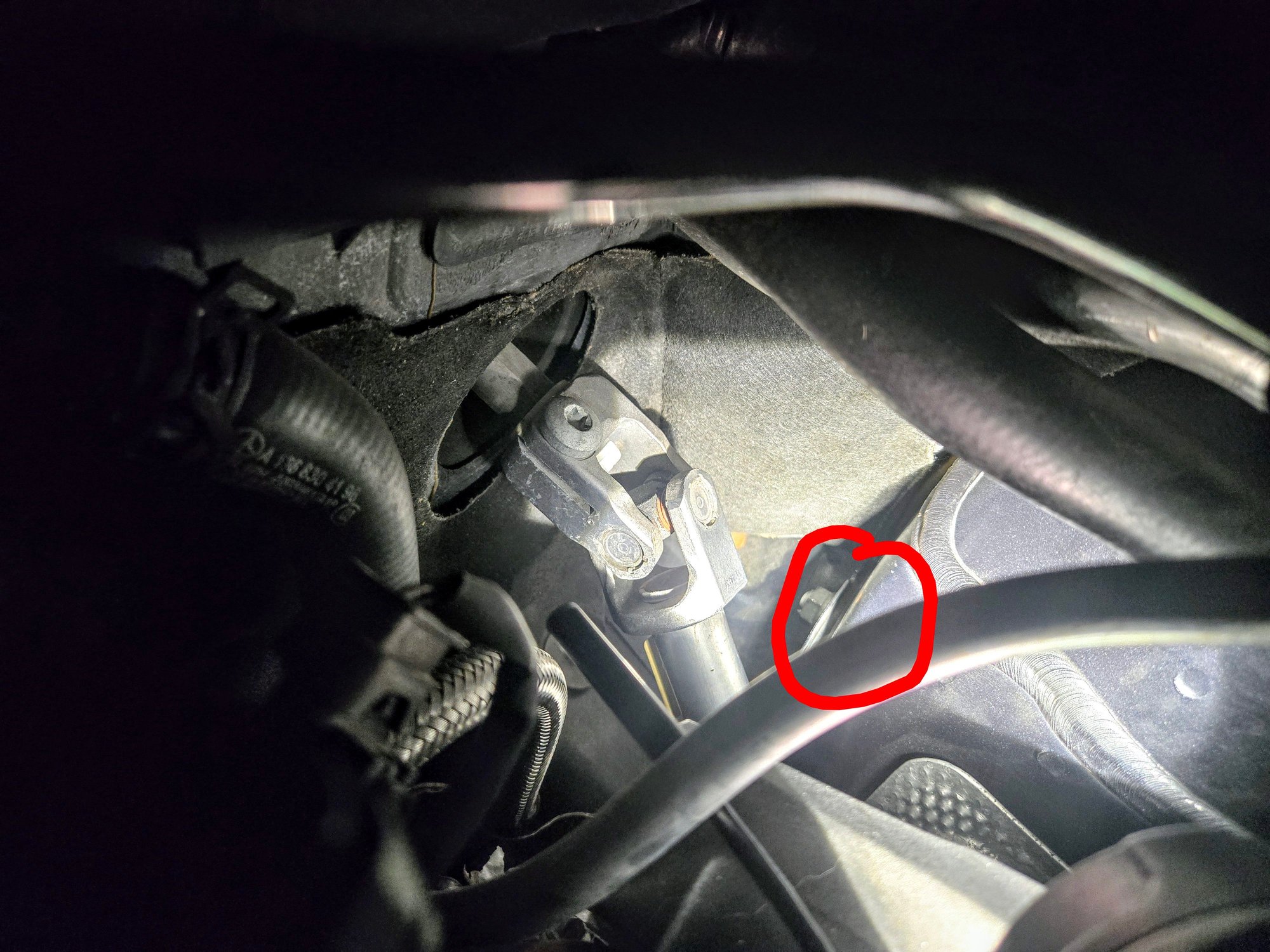

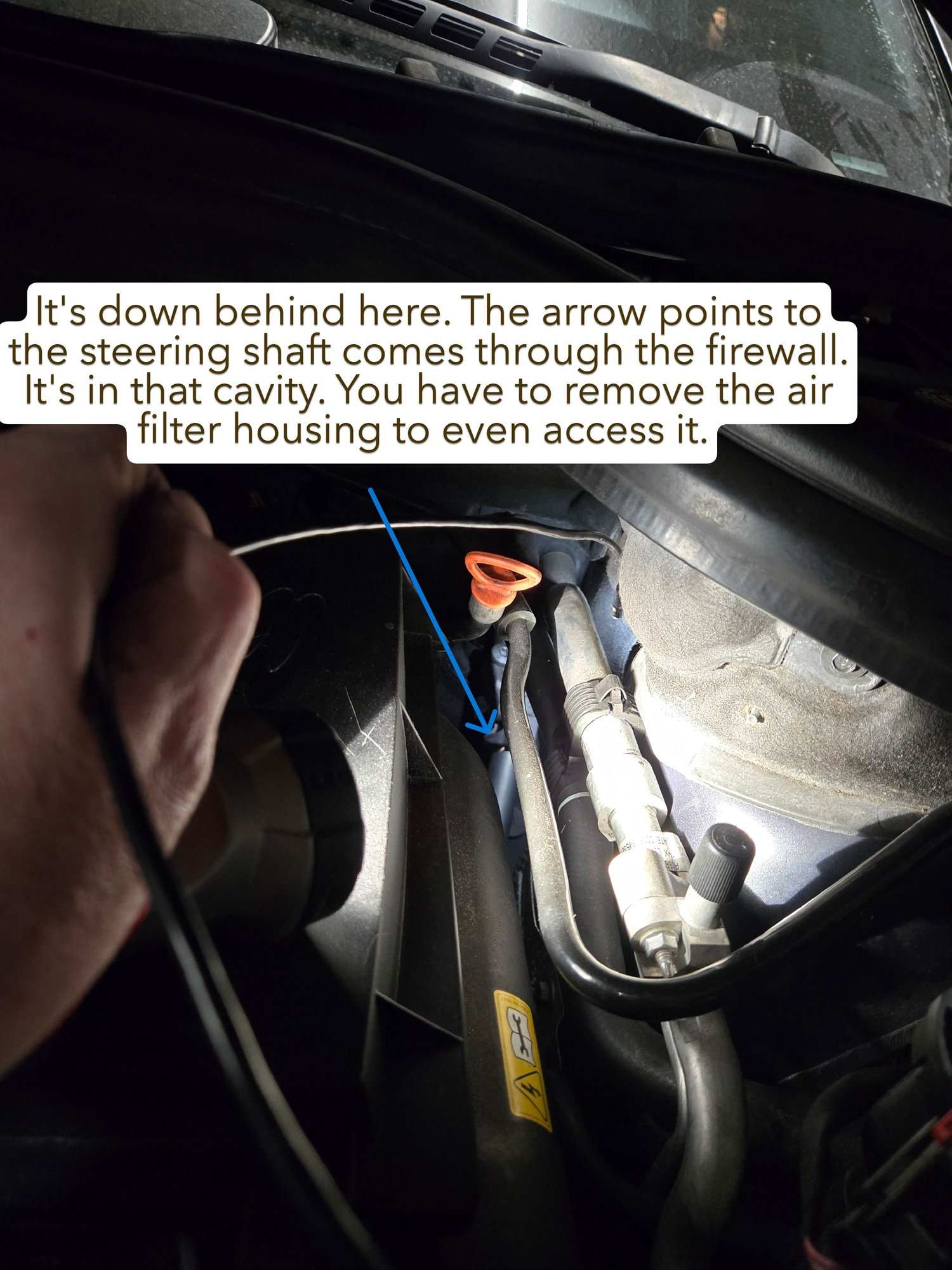

Crud, I forgot! For the driver's side, both are UCA nuts (16mm) are accessible in the engine bay, but I had to lay across the top of the engine to get to the rear nut. The pics below show the forward nut first. The only real issue there was getting a wrench down into the web of brake lines out of the ABS master cylinder and coolant hoses from the reservoir. I got one picture of the rear that is decent, and you can see how much fun it is. I actually got the wrench on the nut and then put a few neodymium magnets in to hold it in place while I did the E12 bolt from the wheel well. The passenger side was a piece of cake comparatively, for the rear nut, I took out the cabin air filter housing and it was plainly visible. I had taken out the wheel well liner to deal with the headlight, and the forward nut was almost too easy to get. I actually put my torque wrench on the nut because it was so much easier to do it that way.
I genuinely hope this is helpful. The driver's side took me probably 3 hours, but it would have been less if I hadn't had to hunt these down. The passenger side took 30 minutes, tops, and that includes the time to remove the fender liner.

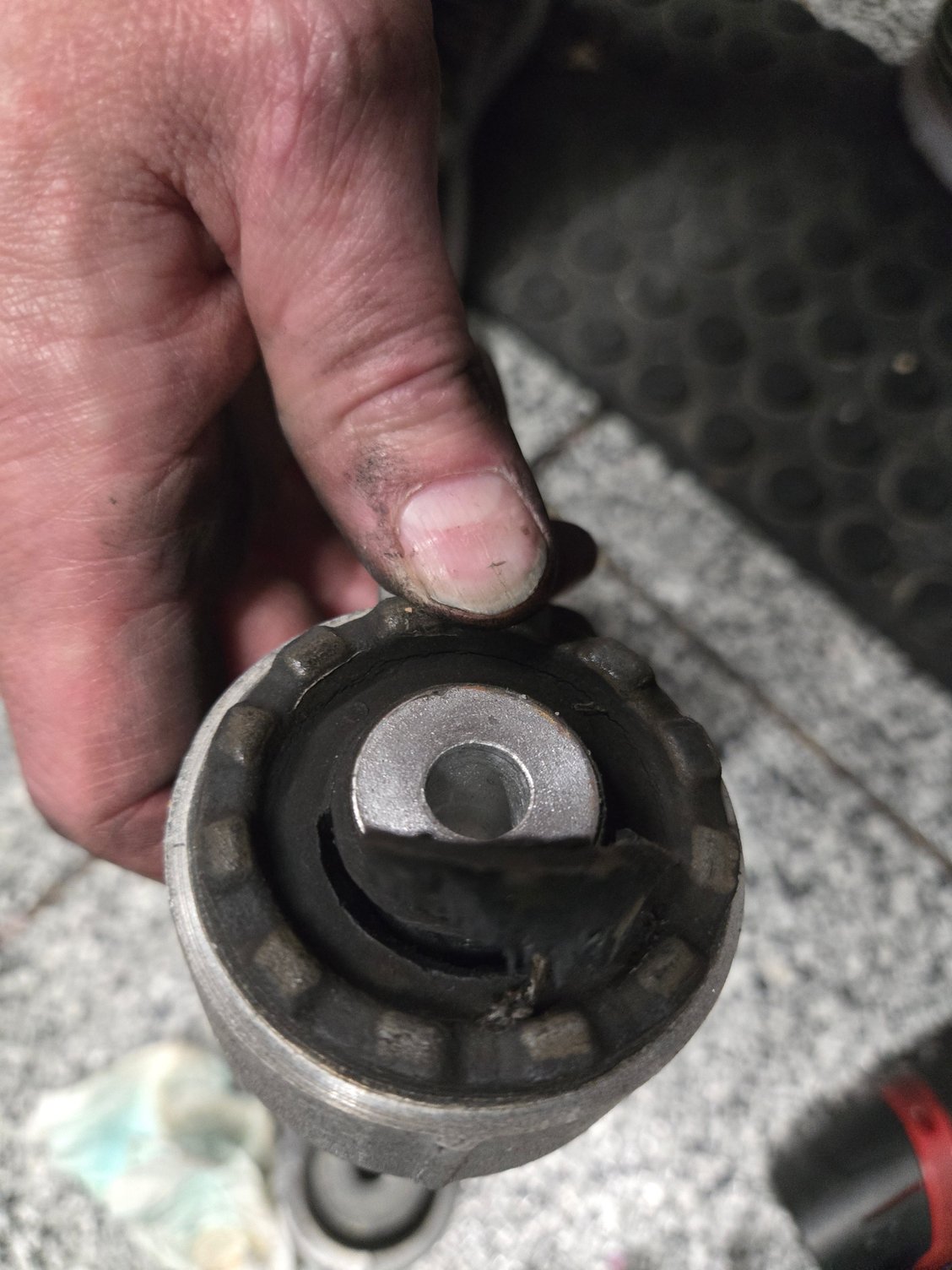

Here are a few more pics that help to paint the picture of just how much was involved.
This is a pretty good representation of the UCA bushings.

This is where I found most of the bump stop for the front passenger strut. This is a ledge in the wheel well.
Here is the remainder of the bump stop from that strut. The other one was completely dust. You can see inside the boot all of the dust pulverized from what was originally the bump stop.
Here is the scrap metal from the suspension components (and the water pump)
