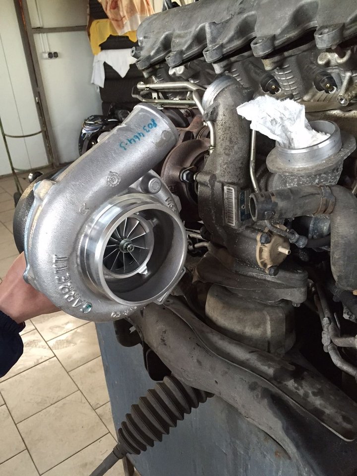

Now we are building my cl600 with new garrett gtx turbos with custom manifold, custom intake, cooling, bigger injectors, camshafts etc...

turbos garrett gtx3076r,
injectors bosch 443 cc + additional fuel pump,
Precision water intercooler cores,
Tial bov's,
Quaife LSD,
tranny upgrade,
Schrick making camshafts.
Now we are looking for place to put the new turbos with custom manifold (making new engine mounts). Hope will finished in next 6-8 weeks
