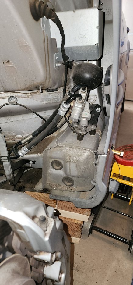

Well, I've started the process of changing every accumulator in my SL55. I've replaced the two in the driver's side front but both were fine. What was not fine were some of the hoses coming off of the return line. One of them was actually bulging. Two of them disappear over the transmission. Any idea how I can get these off so I can take them to a hose shop? Is it possible to cut the hard line and put in a disconnect? What do I need to do that? Some kind of flaring/ ferrule tool?

I don't know who the gorilla is that put these on but the swagelok on the hydraulic line is on so tight nothing I did will take it off. The return accumulator was the sabre way. I had to take the aluminum body that it connects to all the way out and put it in a vice to get it off.

I am doing the same thing you are right now. At least it makes me feel better I am not the only one with the same issue.
