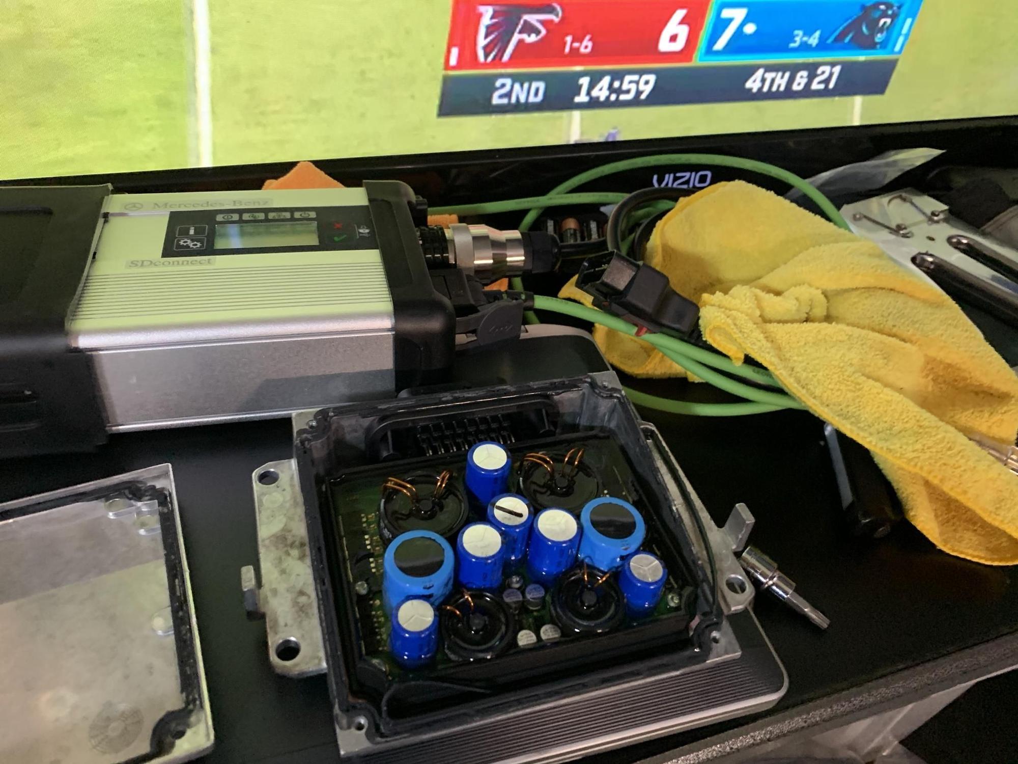

Swapped the voltage transformer with a MB reman unit - v12ci.com is out of upgraded units and is apparently going to release an all new, redesigned part.
This one was $500 shipped from Husker Benz in Lincoln, NE.
I see a fair amount of bubbling, is that enough to be sure it was my issue?

Absolutely, that is a problem. There's no such thing as "an acceptable amount of melting" when it comes to electronic components, ESPECIALLY capacitors (that is a capacitor).
Interesting that v12icpack.com is coming out with a redesigned/improved version - thanks for passing on that information.

it is easy to see most of the time
remove the black top and plastic and look at my pictures on the one I repaired
the top on the failing one is no longer flat

There's only one way to be sure that was the cause of your problem -- did the problem go away?
It did.
