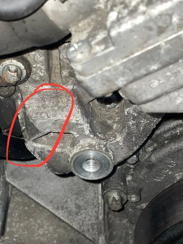

Here is a pic of the front cylinder head/timing cover, circled where there is interference when the idler bolt is tightened down:
The part number on my timing cover is A 275 010 07 35, which apparently has been updated to A 275 010 11 35, pictured here:
I can see a slight difference to the mounting point, but I really don't want to spend $400 on yet another part.
