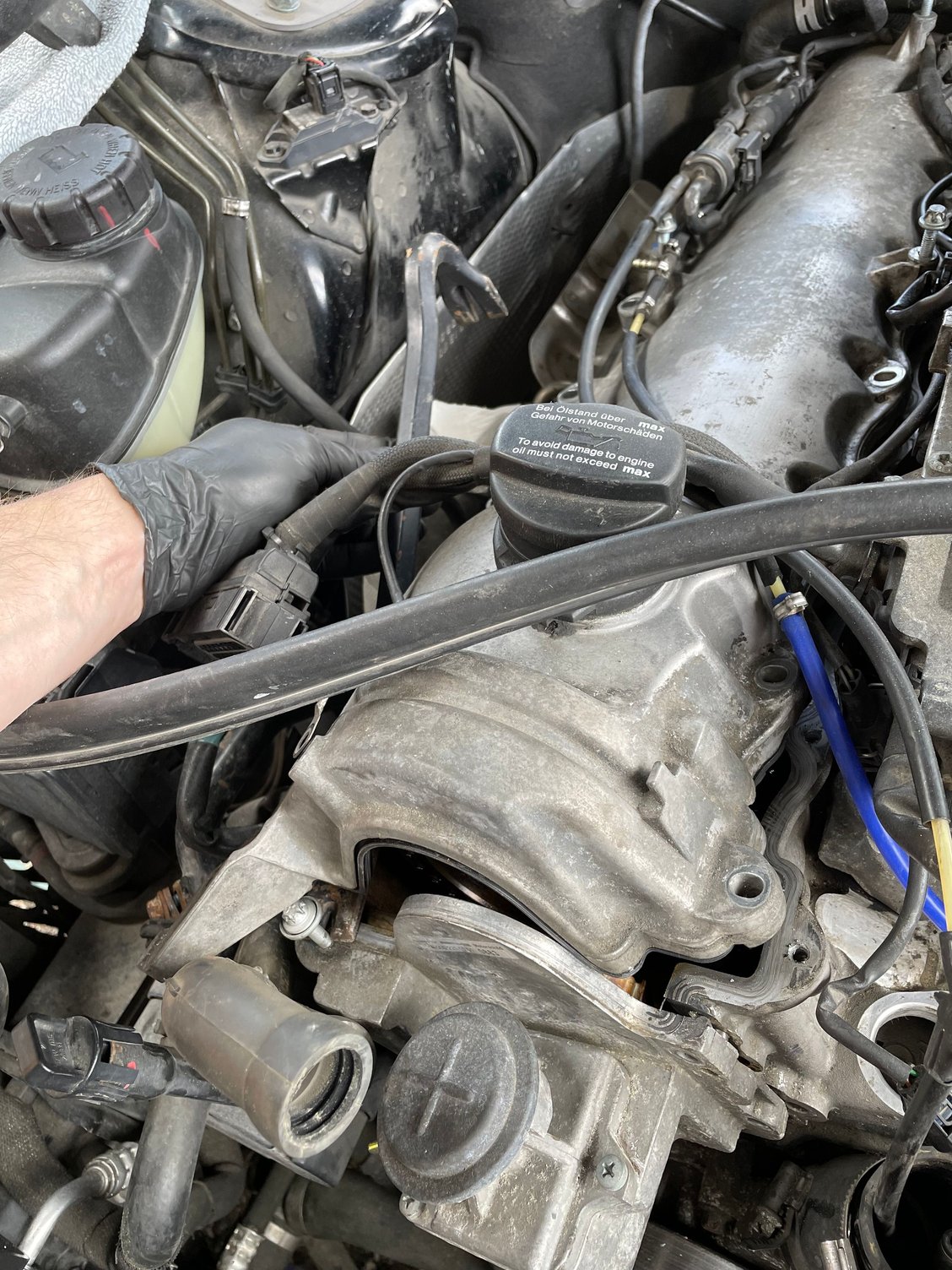

I ended up finding a good used end cover on eBay and installed it. My valve cover gasket was new and supple enough to warrant reuse - I lifted it only enough to clean the mating surface and allow the end cover to be removed.

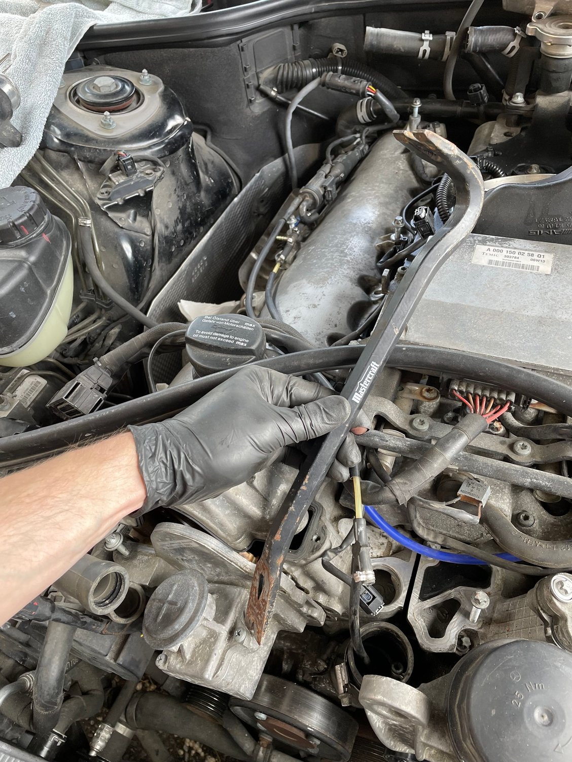

The end cover is pretty stubborn to remove, both due to the existing RTV and rusty dowel pins. It wouldn’t pull or pry off at all.
I threaded one valve cover bolt in, to use as a contact point for some careful use of force from the backside:
On the other side, one of the air injection valve bolts worked well as a striking surface. A few firm taps with a mallet and crowbar, and off she came.

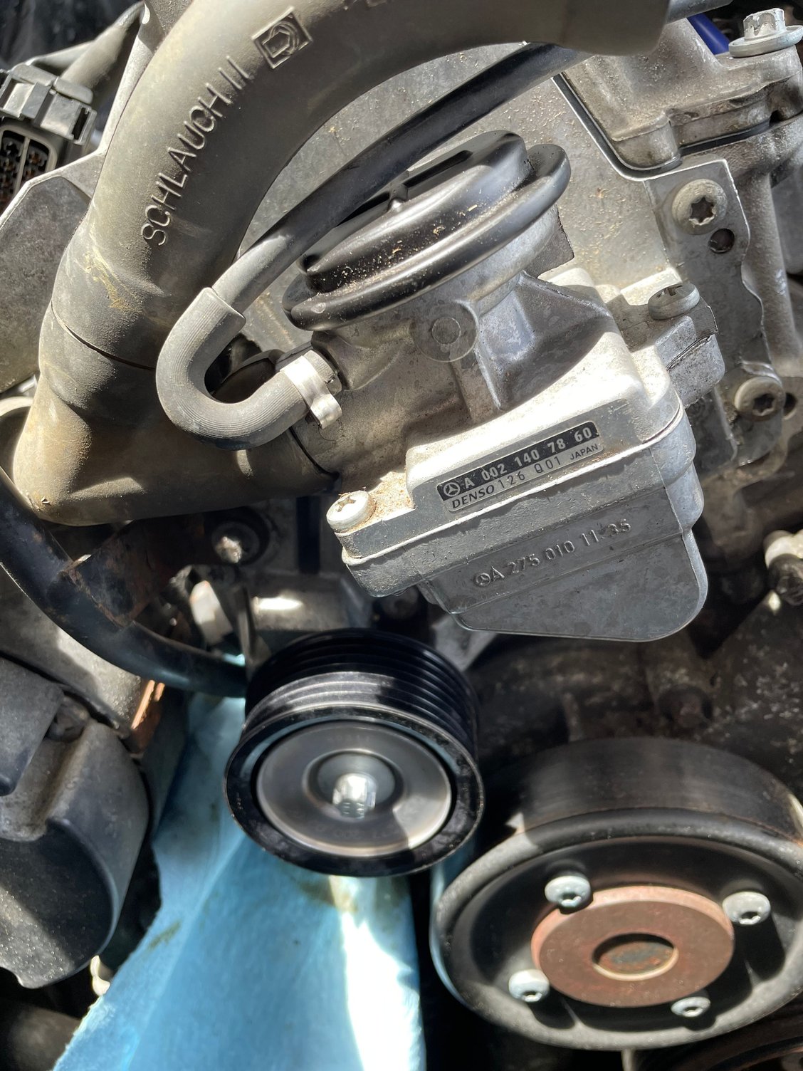

Updated end cover and pulley installed:

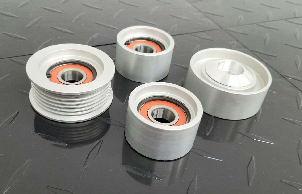

We make a complete Billet idler replacement set with top shelf NACHI bearings for the M275.
http://ultimatepd.com/2005-21-upd-me...idler-kit.html

Our kit comes with the correct spacer behind the 7 ribbed idler for 2005-2012 models.
