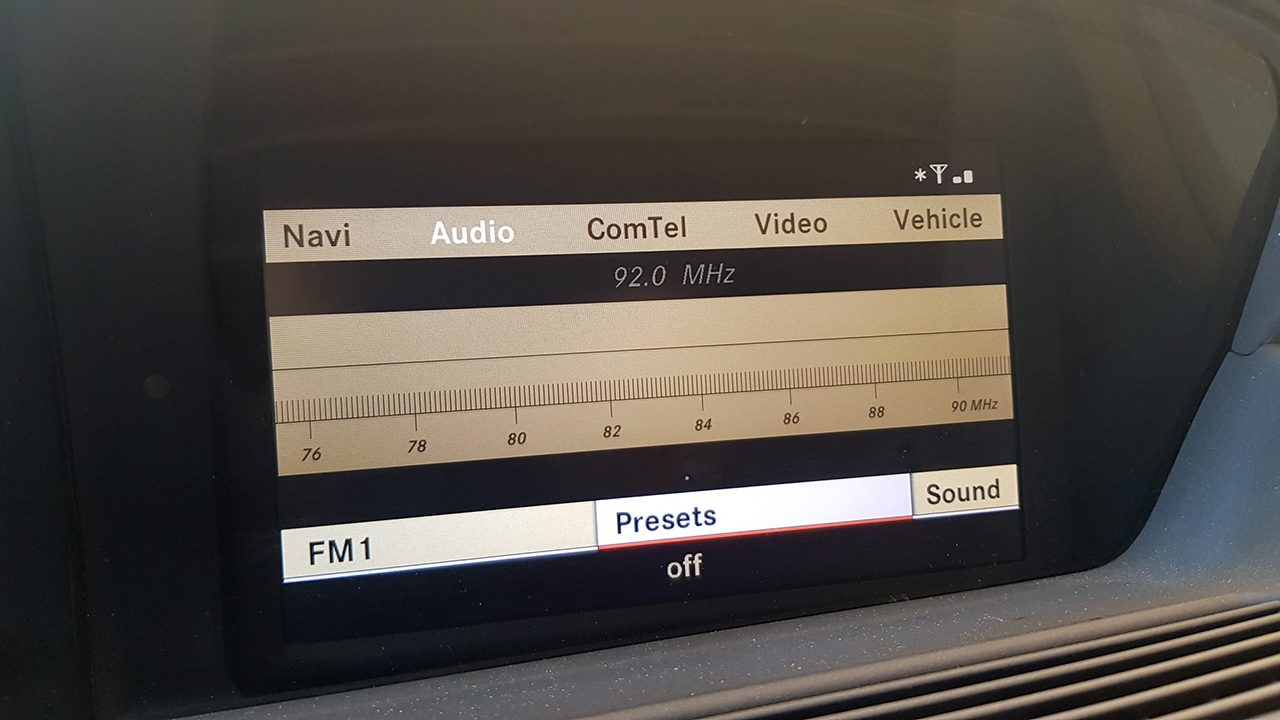

Comand issues in my S63
Originally Posted by amgs63dxb
So far I managed to brick the radio playing with adaptation and trying software upgrades from shady places... :P It just won't work. Luckily I had 3 other JP spec units, so it was pain free experimenting. The best I can do here is:
1/ change coding to Rest of the world (Changing it to Europe in my case freezes entire FM band for some reason, but ROW works)
2/ when changed, the control wheel cannot be used anymore (it locks the "needle" on the far right side of the screen and allows only to move between 85 to 89MHz), but: using steering wheel controls you can go above the limitation (needle dissappears, while you can adjust the FM frequency). Thanks @hussein_abumaas for the hint! When you adjust the frequency up, the dashboard cluster stops at 90MHz, but the radio keeps going... 91...92...93 until 100MHz. Then it looses the first digit and keeps going up until (1)01.3 or something like that. And this is where the weird thing happens - when you keep scrolling above the 103, it goes back to 76 and keeps going up. And in that range from 76 to 85 it keeps finding stations that are not supposed to be there (almost as if it was 104,105 and so on). The minute you try to adjust it with the wheel, it comes back to the real 85-90 band. But if you fix it with steering wheel controls - you are home...
That's the best I was able to set right now.
@hussein_abumaas mentioned also you could do presets, but when I try to do auto search, presets gets cleared up and nothing can be store. Not sure if this is my unit or are there other coding that affect the behavior...
But that's officially it. I'm not going to waste any more time nor energy on that crappy old radio which I don't even listen to in the first place ;-) Next step would be to use can hacker to isolate signal codes from the steering wheel controls and use it to control external audio source.
So i guess just replace the comand unit with a GCC one. i got a quote of 4,500AED plus 2,500AED for installation for a used unit. my problem is am OCD and i get annoyed easily, i bought the car assuming everything can be fixed easily, alas there is a price to be paid.

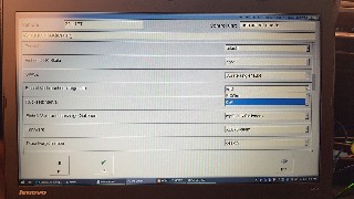

2008 S63 Jap specs
It took a while, but I finally managed to sort out some of the Japanese quirks - but to get there you need to dig a bit deeper Actuation -> User-defined actuation -> Check coding and correct if necessary -> Variantenkodierung (and all below is in German). Google translate with live picture translation helps a lot here :-)
1/ You can adjust if high beams are allowed in the region or not - apparently in JP these are not allowed, that's why my car was only using flaps to run high beams out of the xenon. Now it's doing the both H3 + Xenon when running high beams... (which is pretty funny why such a configuration even left the factory - two lenses per lamp out of which the inner ones are not operational by default)
2/ Changing consumption from km/l to l/100km - also there (Einheit Verbrauchsanzeige Liter)
3/ Turning off the reverse camera gong - I found it under these German settings too... There are at least 6 places where I changed it - bottom line changing only memory settings does not turn it off, but when you open something that was named after translation "module default settings", you will find "Rückfahrkamera"-something (damn, I got excited and didnt make a screenshot, but I'll dig it up next time I work on somebody's car). From there you can turn this crap off...
https://www.youtube.com/watch?v=cWGvet2h-LA
And one more thing - changes take place only after rebooting the cluster...
bonus - if your lamps have ILs, you can turn the LHD to RHD with a switch - just dig into control module of lamps. You only need to change coding for one lamp although both modules are visible separately, second will inherit.
Next step will be to fix the radio. I managed to do a test where I can pick up random FM frequency outside of the Japanese 75 to 90, e.g. 104.4, and the test works - I can hear the music. So now I need to figure out what exactly do I need to change and how - firmware upgrade? SCN? Not sure. Reconfiguration of the unit alone to Rest of The world allows me to test higher frequencies, but the display is still fixed with the low range (75-90), while the knob only allows me to select frequencies from 88 to 90 (making it pretty useless at the moment).
Any ideas?

@Nadimos 2009 can get aux activated via vediamo / das / monaco.
has anyone got AUX activated on a facelifted NTG3 Japan spec? DAS says that units with digital TV must set the AUX function to PRESENT and the car comes with analog chinch set in the glove box... but how to use this archaic setting to get the Android to work? I mean - how to get the sound into the MB unit and play the music from external source on this facelift Comand?
