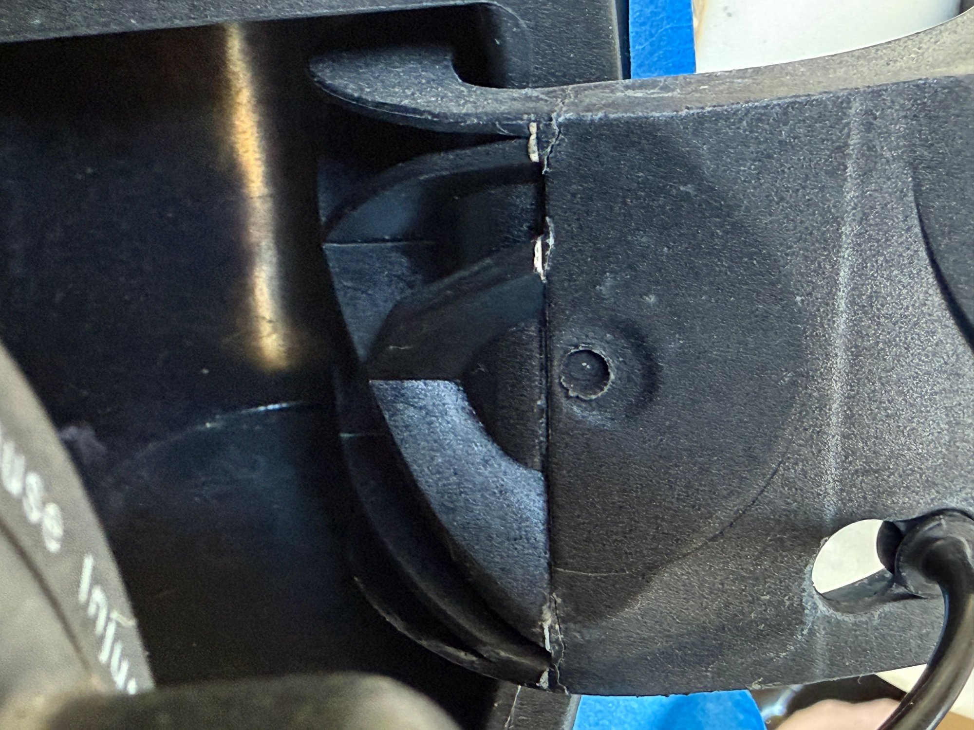

Anyone else have this happen ? How simple to replace ? Assuming the assembly just pops out ?
going to see if the dealer will warranty it , otherwise order a new one. I wondered why my door always tapped against the car when fueling (bought cpo a few months ago) , so today I looked closer.

Update. They replaced it, but didn't order the stickers. if I wanted those, it was another day and $36 + tax. I said leave the stickers off. MBUSA called, they offered a 50% goodwill credit. Dealer insisted on damaged - so I asked to keep the old part. Looking at it, the cracks are starting right at a sharp edge and the crack growth is very smooth compared to the area where the door broke off in the process of them replacing it. Oh yeah, in the process they dinged the panel with the door and then claimed it was there when I dropped off. I argued, got them to get their PDR guy to come fix it. There is a slight scuff on the new ceramic coating - have an apt with the detailer this weekend and will get that polished out and possibly recoated locally.
What a pain. What pissed me off the most about this is the part is designed poorly (looks like it to me at least with my engineer eyes) and it's still somewhat out of pocket, but then the dealer thought I was lying about the dent being new. I had asked to see the guy who checked the car in because I pointed out specifically to him that I wanted it replaced because I didn't want to scratch or dent the car if it swung open. I saw him come back from lunch and he said he didn't pay attention but didn't remember seeing the dent.. but either way, they pulled the dent and the scuff in the coating will be taken care of this weekend (my expense).

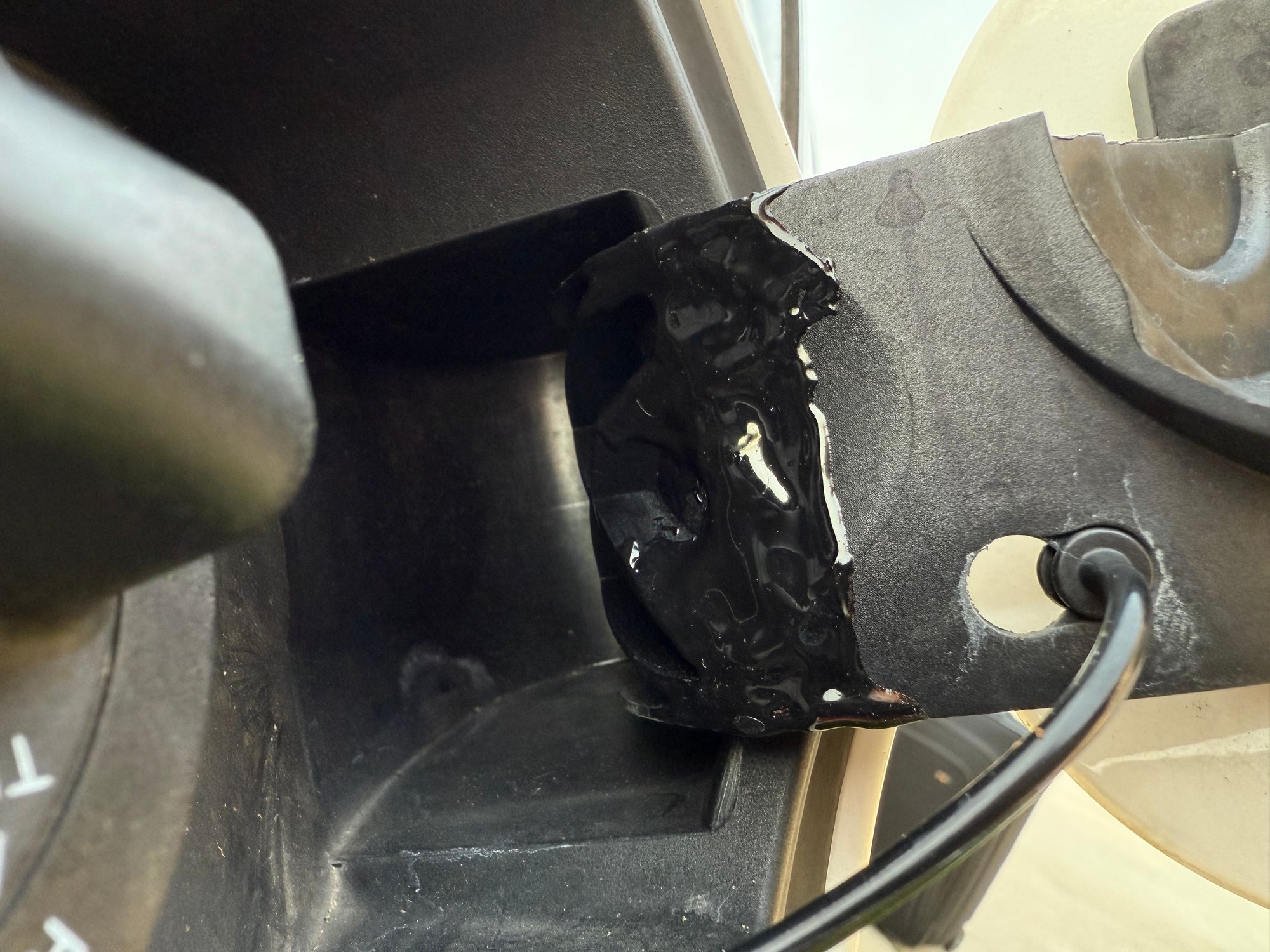

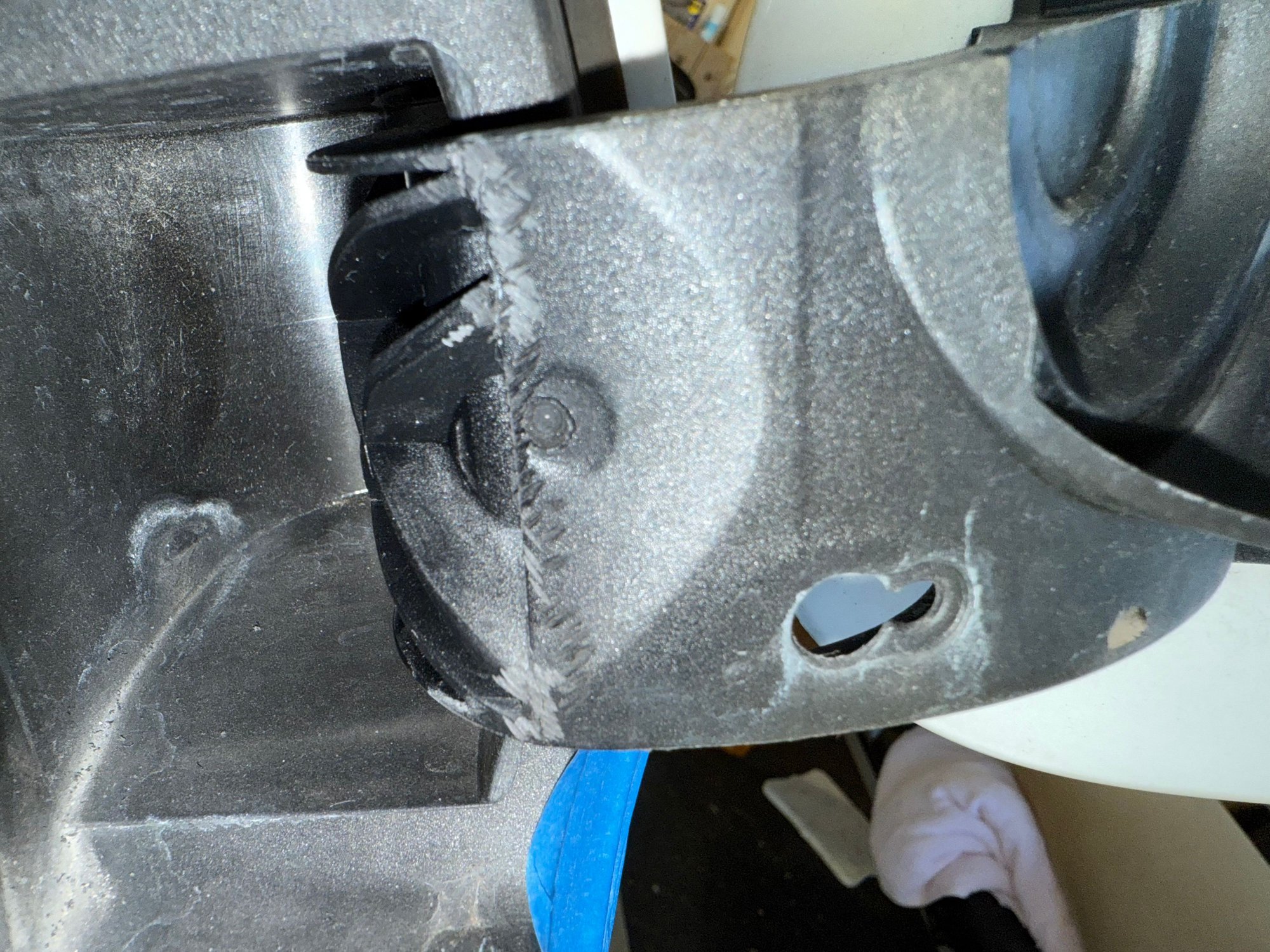

Well, I spoke with the service advisor who I have a good relationship with. He suggested the plastic weld epoxy. I went with JB Weld. I carefully used a Dremel to very lightly score around the crack, then wiped clean with alcohol, trying to give the world clean, rough surface to adhere to. I spread it conservatively between the void and around. A few days later repeated this time actually sanding on the epoxy. Then extending where it was applied. It seems pretty solid.

I wonder if there is enough material for something like this to work. For $21 it's certainly worth a try. You can always go the expensive route later. The JB Weld does look strong, though.

I too would've chosen the repair option. No way I'm giving them $300+ for a new one. Even if that breaks off one day I'd simply make the repair stronger, with pins and/or a brace. The melting option Red suggested is great for many plastics, but the two times I tried with other plastics on my car it was a fail. It was the turn to smoke and carbon before it melts kinda plastic, and based on the pix Cameroguy posted it looks the same. Only one way to find out for sure though.
Excellent work, sir. Which epoxy did you end up using? Hope you're not OCD or those Dremel marks will keep you up at night :p

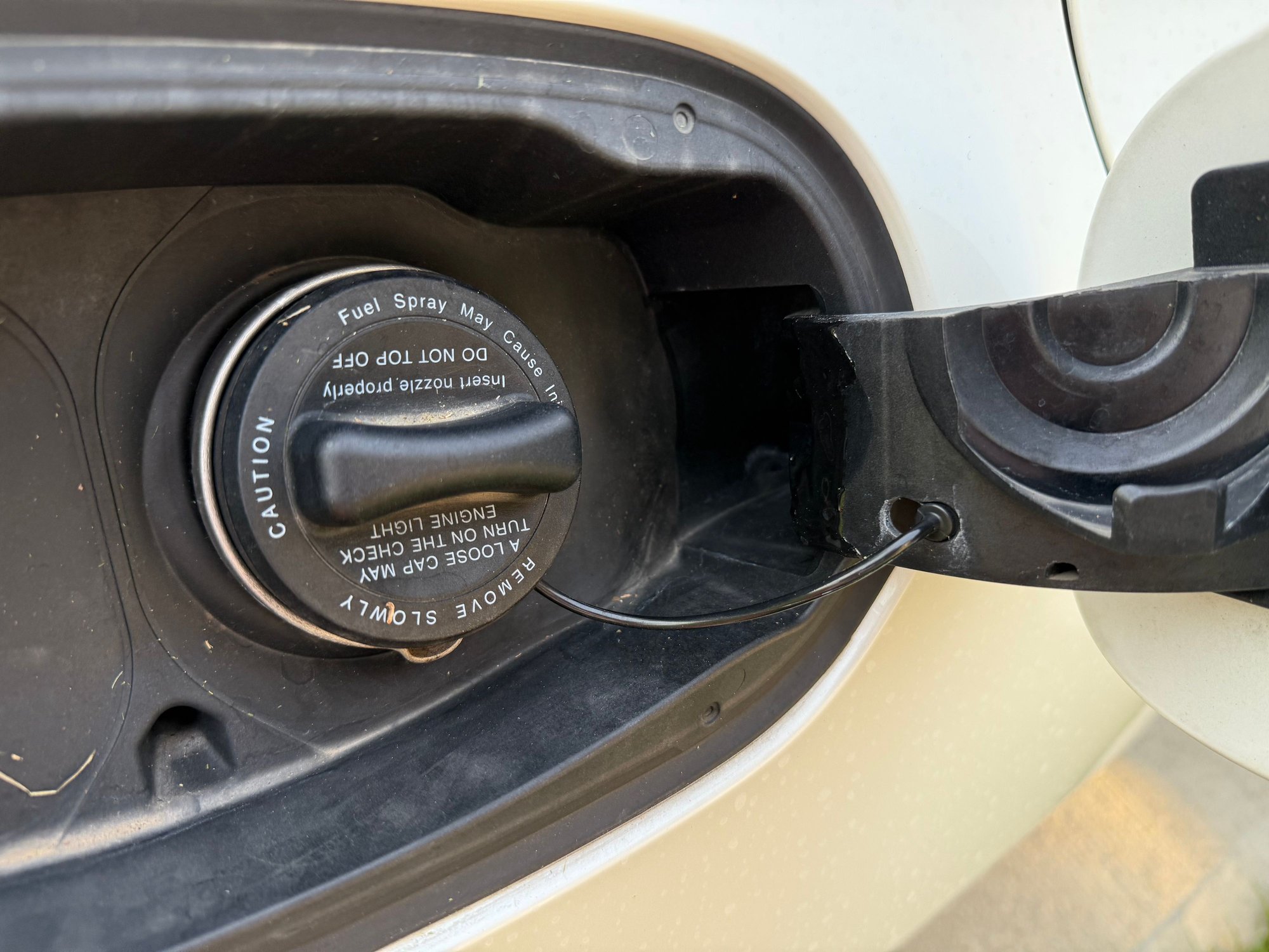

Forgot to post after pics.

Oh, crap! Your gas cap is upside down now. Thank goodness they aren't expensive to replace!
