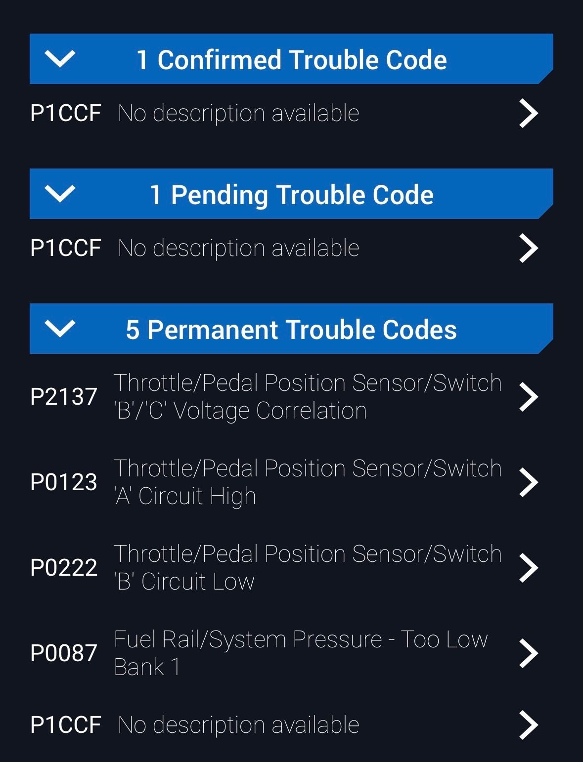

Hi any updates on this? My daily is having this problem after changing the PCV. I can’t get the car to stay started. So it’s not drivable.
It cranks, turns over and stalls.
Codes I’m getting.
Codes I’m getting.

scanner stall DTC
Codes I’m getting.
Codes I’m getting.
You have two killer codes shown by scanner:
  1. the throttle body connection
  2. the fuel rail is too low P0087
Double check these items.
did that yesterday too, the killer is the P1CCF
that's ECU calling a fault on low fuel pressure.
This issue happening right AFTER PCV service is likely an unusual cause... meaning double-check recent work for loose connections.
