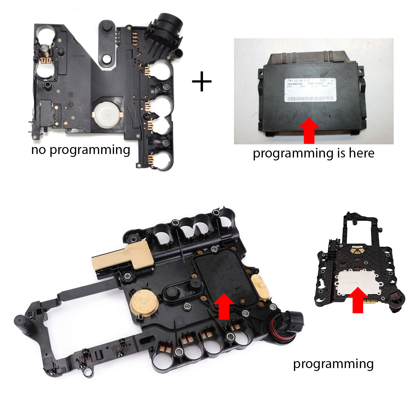

Old Feb 13, 2024 | 05:10 AM
BenzNinja's Avatar
Former Vendor
iTrader: (5)
Posts: 2,973
Likes: 958
Old Feb 13, 2024 | 09:33 AM
JettaRed's Avatar
Veteran: Army
iTrader: (1)
Joined: Nov 2016
Posts: 7,847
Likes: 3,497
From: Maryland
@BenzNinja To be clear, the 722.6 transmission has a separate TCU, while the 722.9 has an integrated TCU? If the conductor plate for the 722.6 is replaced, does the new plate need to be coded to the TCU or does the TCU need to be "adapted" to the new conductor plate speed sensors?
Old Feb 13, 2024 | 10:48 AM
BenzNinja's Avatar
Former Vendor
iTrader: (5)
Posts: 2,973
Likes: 958
With separate TCU nothing needs to be programmed
