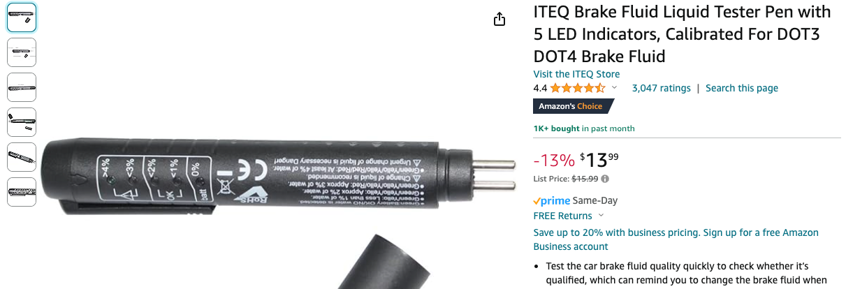

- Do brake fluid every two years -- mileage is irrelevant. You change the brake fluid because it is hydrophilic and can lead to corrosion in the brake lines if too much water (from the air) is absorbed. You can always check with an inexpensive brake fluid tester that measures water/moisture content.

Did a brake fluid flush on my G a couple months ago. Bought one the $20 moisture testers. It could tell the difference between new fluid and tap water, but seemed worthless for determining 1% - 3% water. Also bought a package of the test strips that purport to measure water content by measuring copper content in the extracted fluid. Theory is that water oxidizes the copper in brake lines. Test strips showed less than 1% water, and barely distinguishable from new fluid. It's all hocus pocus -- easier to just replace the fluid and call it a day.Originally Posted by JettaRed;893942 Do [b

Correct. However, if the tester does show above the safe level, then you know it needs to be changed.Originally Posted by streborx
