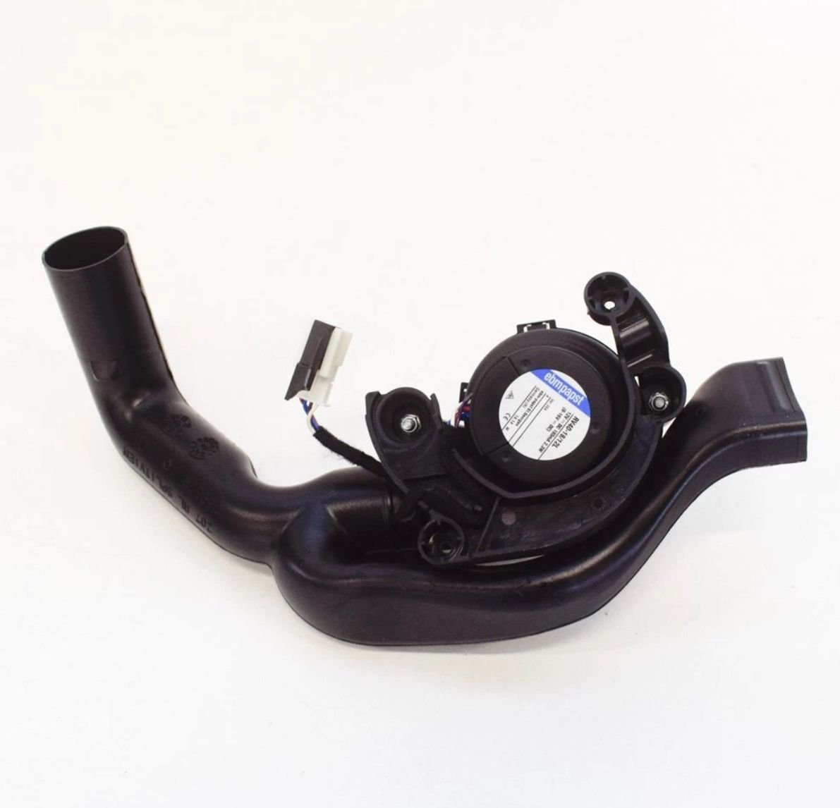

Hi all,
Hi Richard,
I’ve managed to retrofit ntg 4.0 in my W207 but only thing outstanding is the cooling fan you mentioned. Can you please advise what parts I need and how to wire it accordingly. I found on ebay fan with conduit, where do I go from there?
