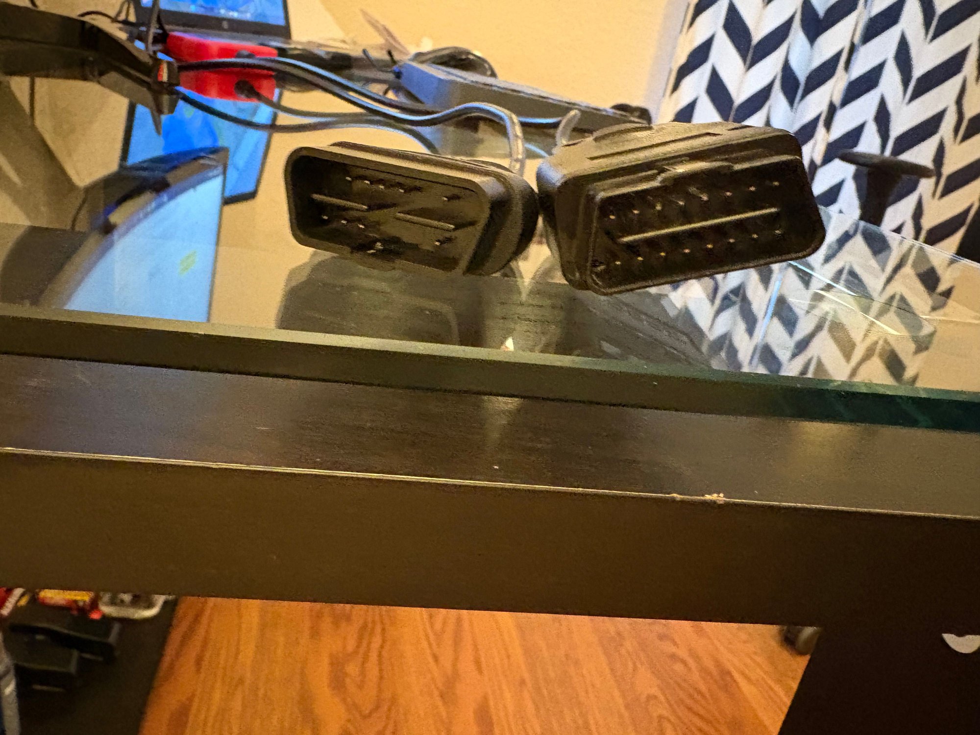

Thank you for the reply. These are the two scanners I've tried. One has 16 pins the other has 9. Both can read speed sensor codes, but can not reset the TCM. I've tried disconnecting the battery and touched the cables together to force a capacitor drain. It didn't help. The YOUCANIC bi-directional scanner is around $450-$500 which is out of my price range. Looks like the only way to get the TCM reset is to find a local garage and pray this is the problem.
