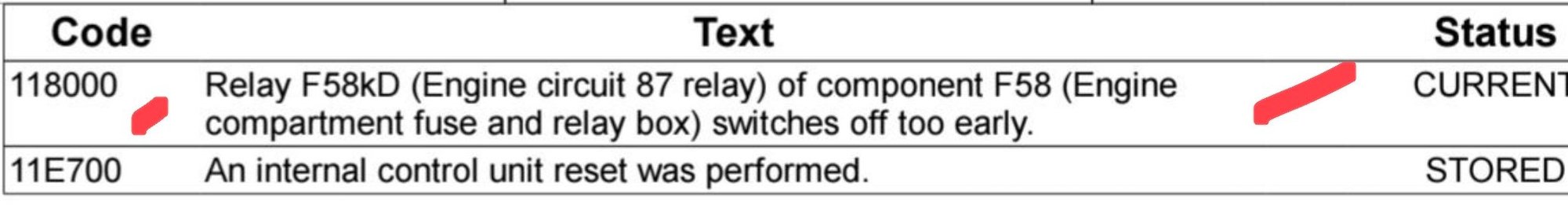

The issue hasn't come up today, but this is the code from when it did come up. I could not find any info on this. Can someone explain what this could be?
Great, you're one step closer to a fix.
Fault#2 STORED: "The internal control unit reset..." may be caused by the same unstable power. A shadow of main fault!!
bad power relay
power relay switching early in F-SAM box
Can you source the diagram showing what is "relay F58kD"
- There's a chance something is causing it to act up... ie. don't rush at replacing untested parts.
It may be a bad connection....
Let's understand what this circuit does.
Is this about your glow plug ... starter gets cuts off when glowing stops prematurely ??

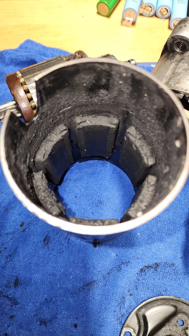

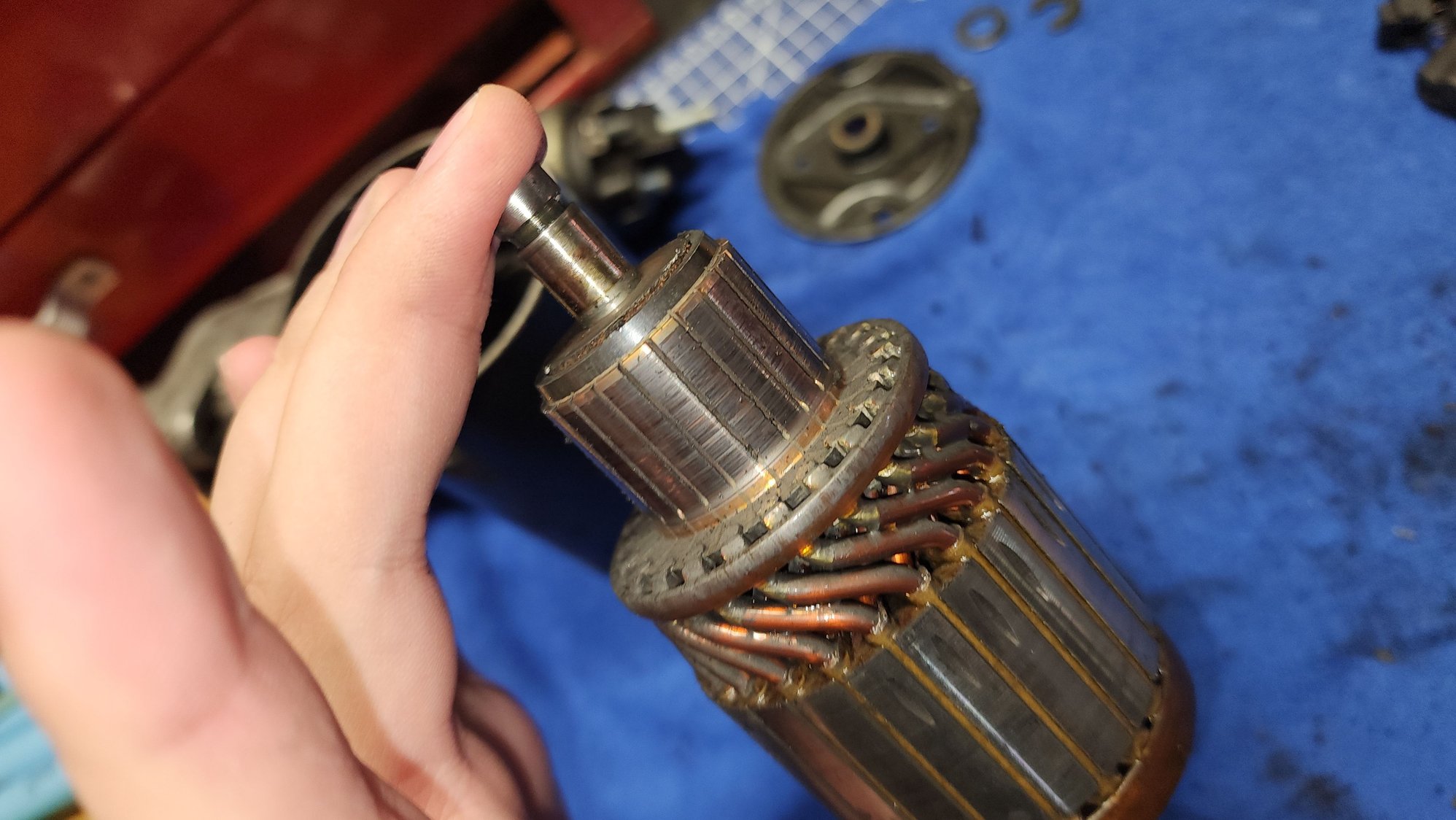

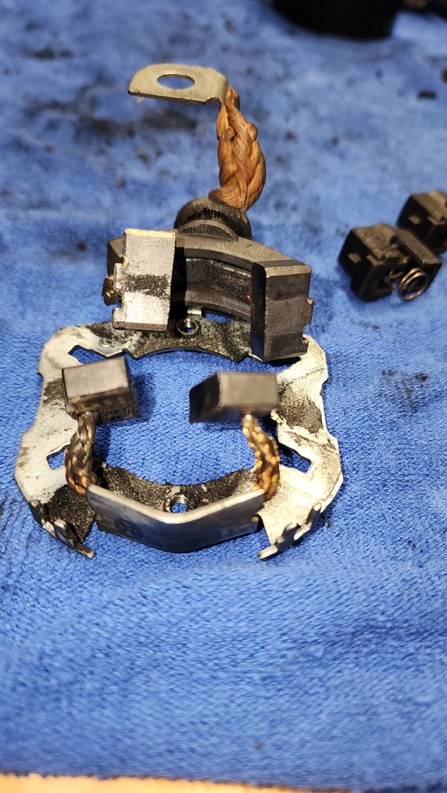

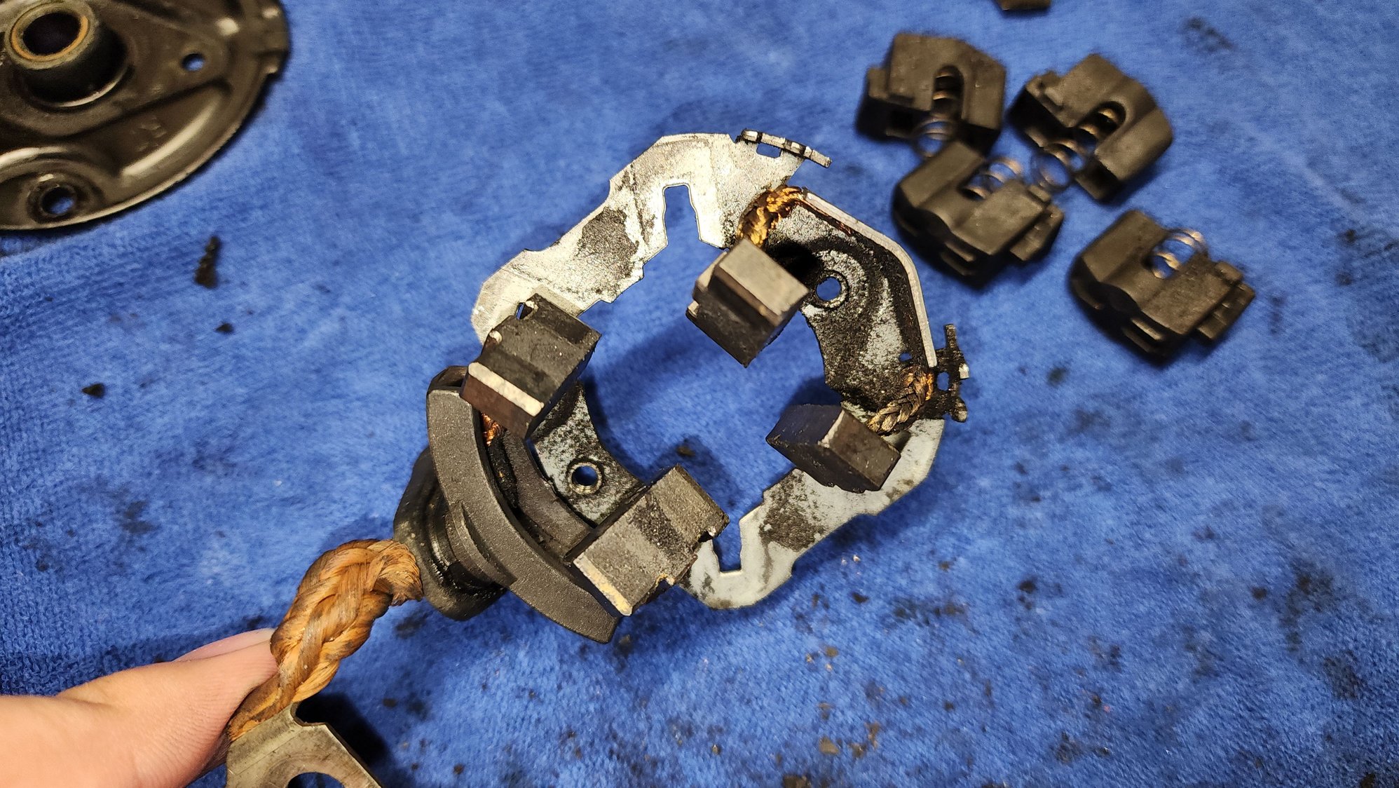

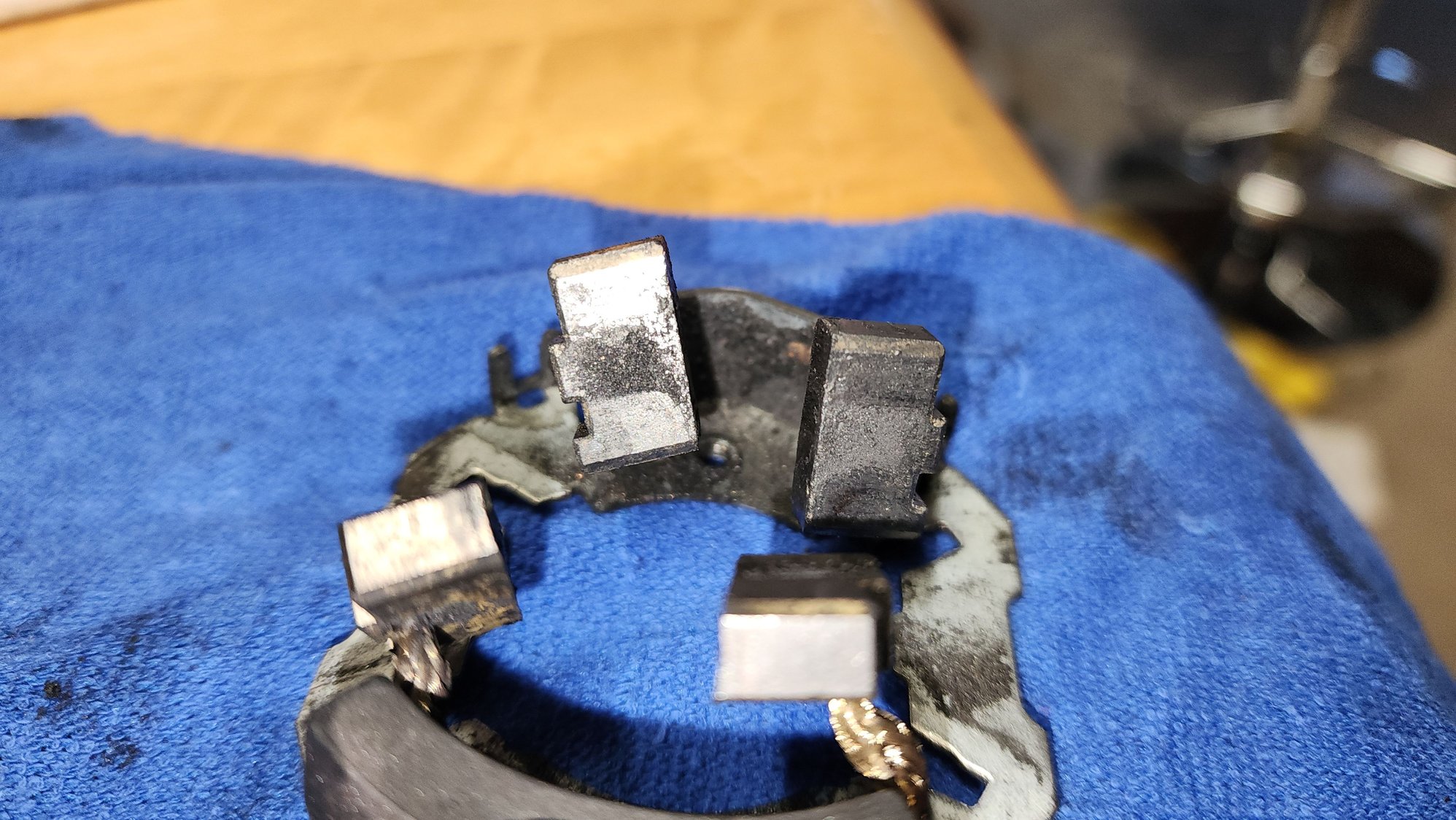

I had pushed the issue back a bit because of time constraints and other projects. But the issue is still happening with both keys. It has started to become worse as the temperatures get colder in the morning. There is times where I have to start it 8-20 times before it gives me a full crank and starts. As soon as I get a proper longer crank, it does start immediately with no issues. The issues are the half cranks im getting. I just removed the started as @CaliBenzDriver suggested it could be the brushes and disassembled it to investigate.
I found that its very dirty of graphite inside (which I assume is normal for a GL with 190,xxx km). I cant tell if the brushes are bad. Can someone tell me if they are bad an need to be replaced? My plan was to clean everything up, put it back together, and hope for the best. I did this with my Polaris ATV and it started to work after. But on the GL its a pain to remove, you have to raise the engine to get the starter out.
If someone could tell me if the brushes are good or bad, I can bring it to my local Alternator/Starter repair shop for a repair, before putting it back together. I appreciate all the help and input from everyone in this forum.
Housing 1
Housing 1

Brushes 1
Brushes 1
Brushes 2
Brushes 2
Brushes 3
Brushes 3

Bingo, you car in in good hands: you nearly have yourself a starter fix!
these 4 brushes just got too short
these 4x brushes are worned short... replace brushset!
Now buy a brush-set for that alternator presumably made by BOSCH/VALEO and specifically NOT a "compatible" no-name from China.
I don't believe Mercedes retail these components. Perhaps FCP-Euro, Amazon or Google search.
Be sure it's made by the starter company not made for starter type by a misc supplier.
excellent shape like-new rotor rings
Cheap compatible "brush copies" work but kill the starter soft copper rings with hard carbon brushes.
The original use extra-soft carbon over soft copper rotor. A perfect match!
brushset example
Source the right OE brushset for your starter model number.
Spend one hour poking around the Internet for genuine parts only.
If not available buy a new starter to not have to deal with starter repair of bad brushes + copper rings again.
Now schedule a Visit with your Alternator for exactly the same brushset issue maintenance item at your mileage...
Include a serpentine kit including mandatory tensioner + idlers.

Excellent advice as always, CaliBenzDriver!
Definitely change the brushes or replace the whole thing.
Remember to clean everything well. Clean between the copper bits too. Otherwise, get a whole new one. That one has seen its day.

Thanks for the great advice @CaliBenzDriver ! I am going to see my local Alternator/Starter repair shop after the holidays to see if he can change the brushes, then gonna give it a hood clean and reassemble. I will post an update after this has all been done.

I have yet to find a part number for the brush set. I have found some familiar looking ones from BOSH, which may fit. But the shipping is too long, and I really dont want to resemble it just to redo this painful process again when the new set comes in. The Engineers really couldn't find a better place to put the starter. You really have to raise the engine to remove it like the manual says, and trust me. I really tried to avoid that step.
