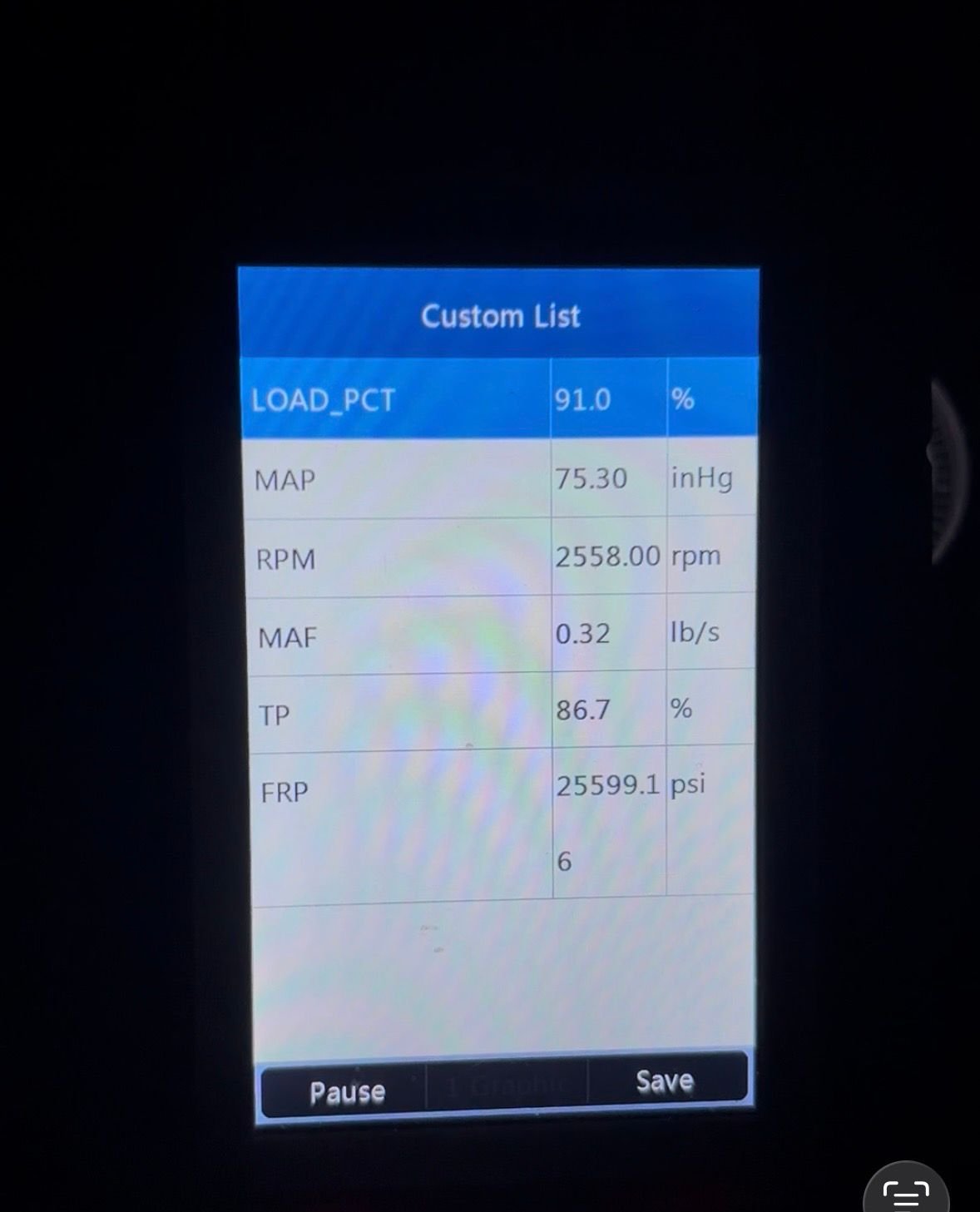

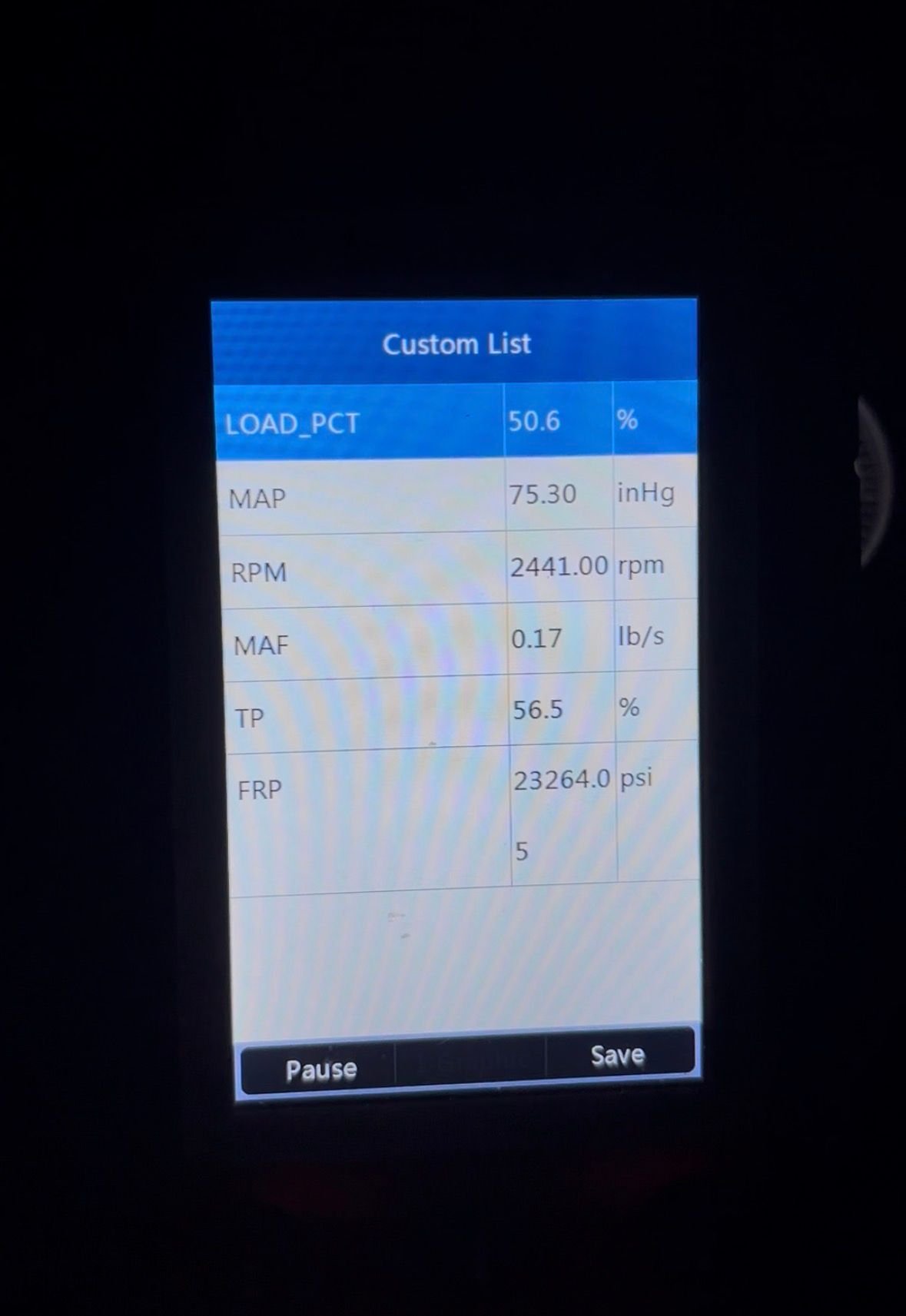

Anyways ive been troubbleshooting some more and Ive come to the conclution that the code for the fuelrail sensor only comes when the ECU has been dissconected.
And ive checked live data from the fuel preassure and its seems to be working as it should. Ill post some pics from the live data.
Now im leaning towards a fualty MAF sensor or something else with the airflow. Still get no codes when its in Limpmode and it only happens when you press the gas hard at higher speed and rpms.

Idle.
Idle.
Before it enters limpmode.
Limpmode.
Limpmode.

Good job: you have captured data supporting your issue...
is 25kPsi good pressure ??
Get the fuel rail SENSOR circuit looked at - It is feeding bad voltage that ECU reads as wrong pressure.

Theese are screenshots from a video, its hard to pause it on the highest readings. The railpressure gets up to 29k psi.
Could it not be that the MAF sensor is going bad and reads faulty airmass and that makes the ECU compensate with lower railpressure? And then the car enters limpmode.
In the video the MAF reads 0,32lbs/s just before limpmode and it goes down to 0.17 before the railpressure goes down. And then enters limp.
Ive read that its suppose to be higher than 0.32lbs/s and that could cause the ECU go loco.
And since when i tried driving without the MAF connected and the ECU was forced to read the ”defualt” airmass it didnt go into limp.
Im willing to try swapping the MAF for 100$ to be sure that thats not it. Since you cant just switch the railsensor.

I had overlooked... this is a diesel with rail presure way up to 1600.Bar (23k.Psi)
Your good back probing work confirms a working harness connection to ECU +5VDC.
