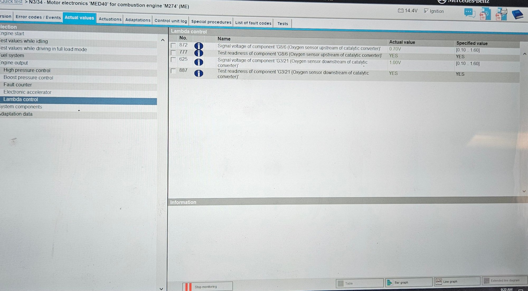

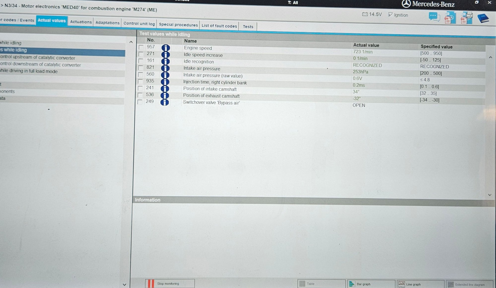

Currently working on a 23 metris m274 with the P017285, with 40K for mileage. Has anyone else experienced this code with the M274? It runs great at anything above idle. But slowly leans rich at idle to a point where it stumbles a lil. I have replaced the following parts....

Checked amperage and circuit for wiring issues on the O2 sensors per WIS diagnostic procedure. Both look good. I dont see any other data related to Fuel regulation or lambda control that seems wrong other than the upstream O2 senor slowly goes down at idle, the downstream stays consistent around.0.95.
I am fairly new to the Xentry , so maybe im missing something The Xentry is a great tool but does lack on data of some Pids.
