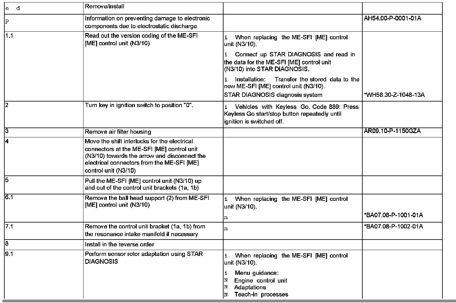

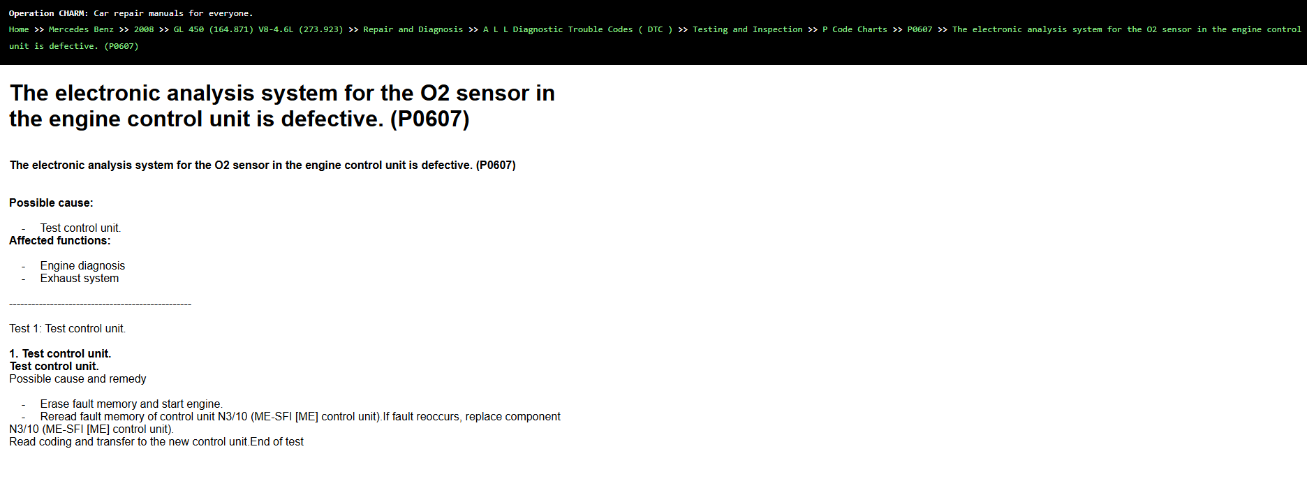

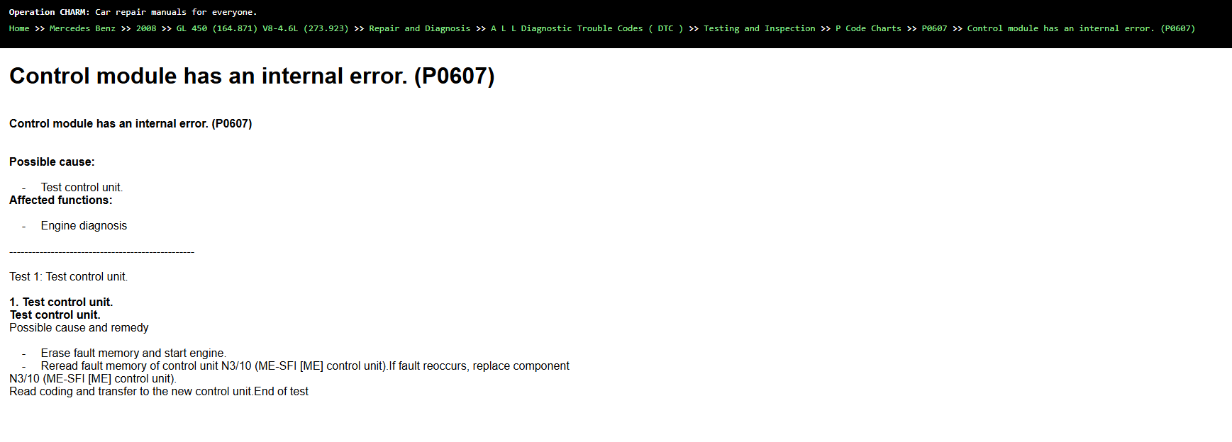

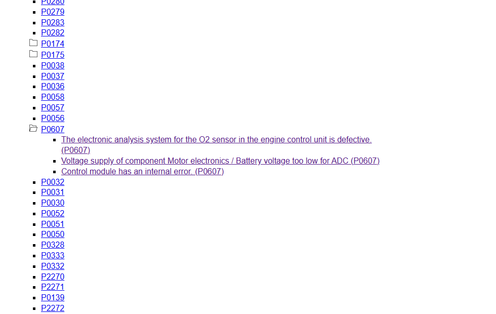

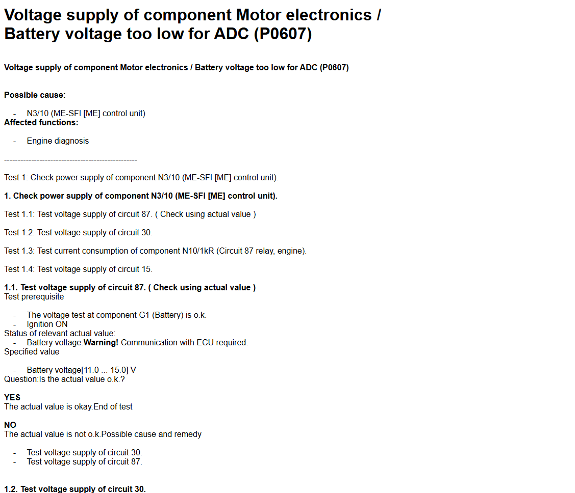

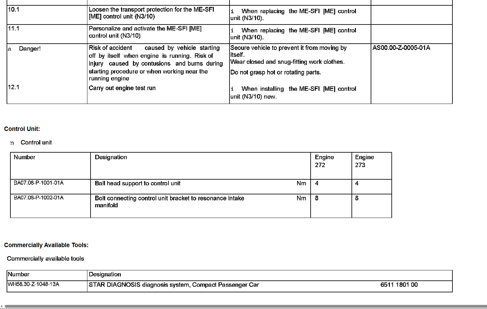

Strange that it was seemingly working fine for a year until now. Looking up the P0607 code its showing three scenarios. Two say replace ECU and the third shows all types of testing.
Heres a link to the online manual I was looking thru: https://charm.li/Mercedes%20Benz/200...d%20Diagnosis/
For info on the ECU go to Powertrain management > Computers and control systems > Engine control module. There a some TSB's though they may not apply to your situation.
For the codes go to the top selection A L L Diagnostic Trouble Codes (DTC).
I never programed or reprogramed anything before.
