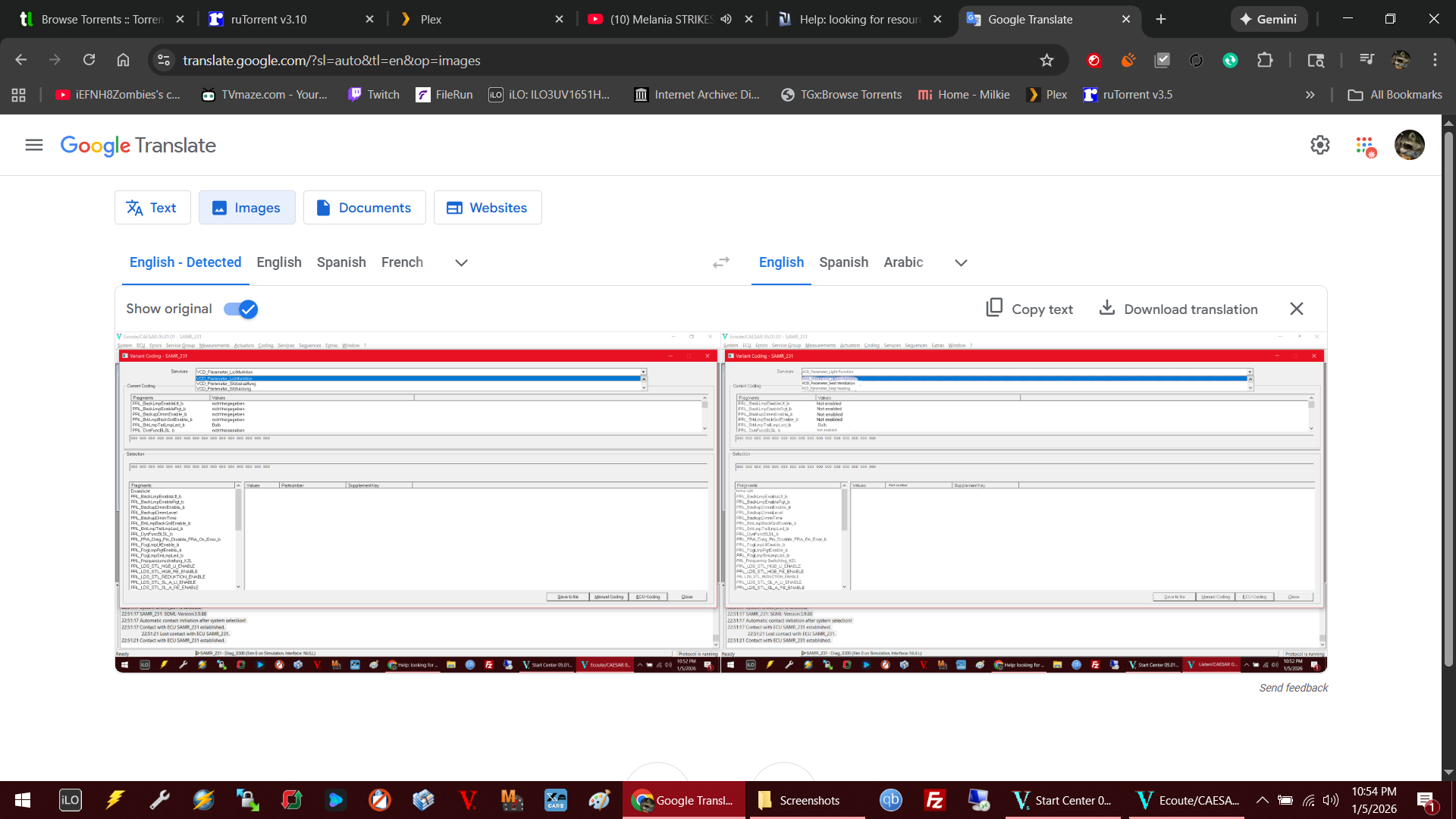

Below is a example of how I use Google translate although I dont usually do the original and translation. I just did that to help clarify what I'm meaning.
Attached Thumbnails Help: looking for resource to explain module/variant coding-screenshot-275-.png
