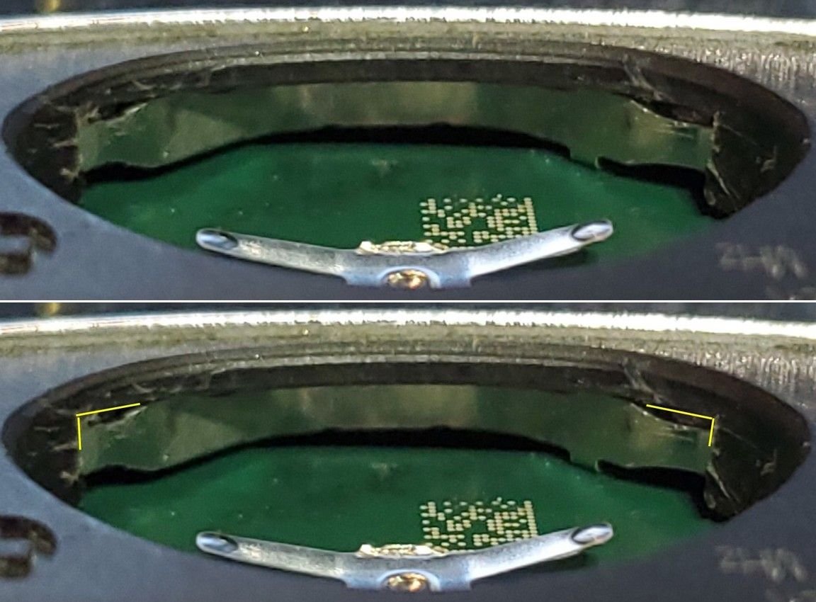

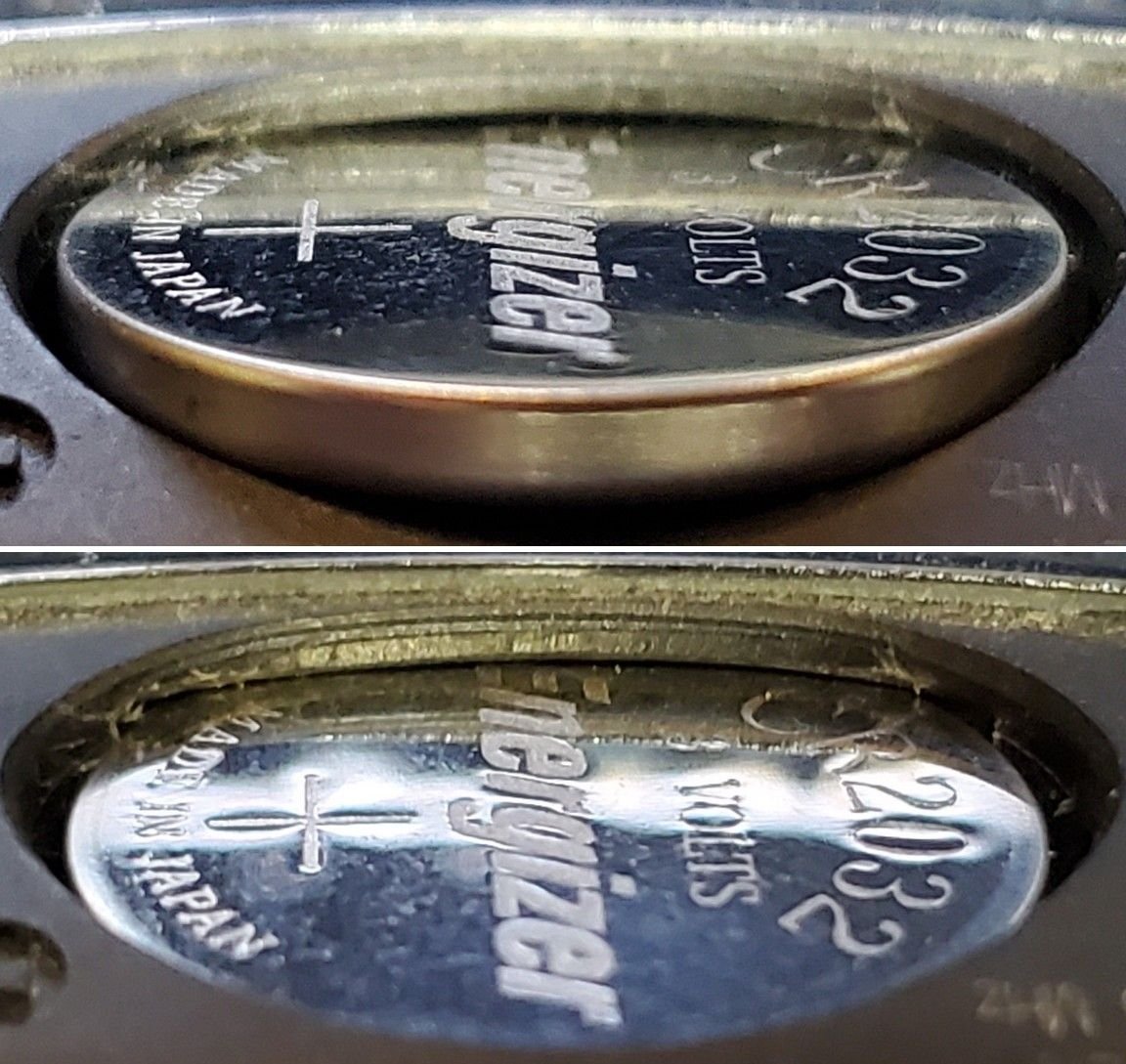

The pix below shows the mod to accept the 2032. Note the little yellow lines noting the plastic I removed.
There is no rubber seal, it's more of a cushion hold the batt in place. The cover will bulge a bit, which I found annoying, so I used a Dremel and a sanding disc to thin the rubber cushion that presses on the batt and problem solved. I can take a pix if you/anyone want to see mine.
