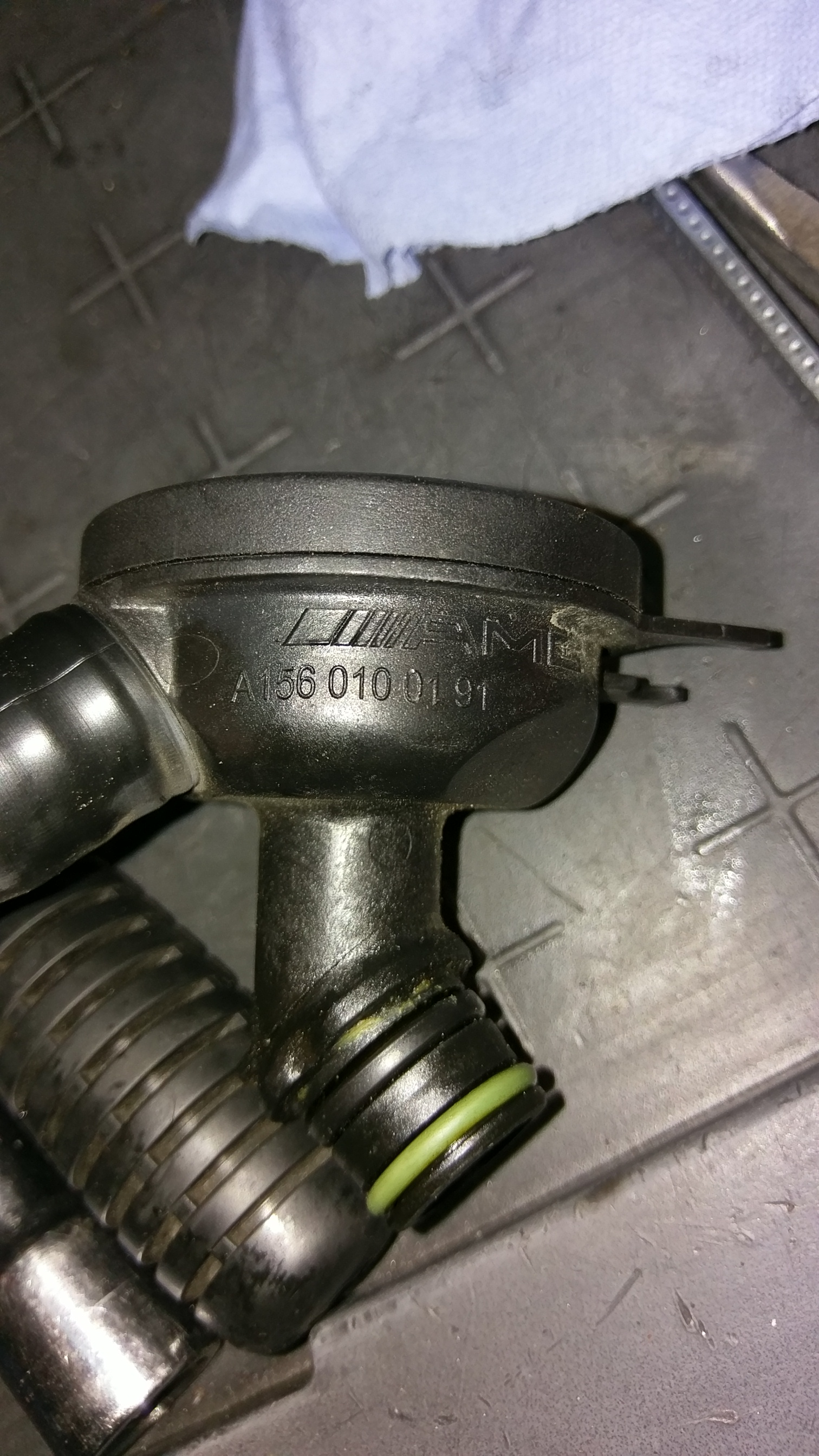

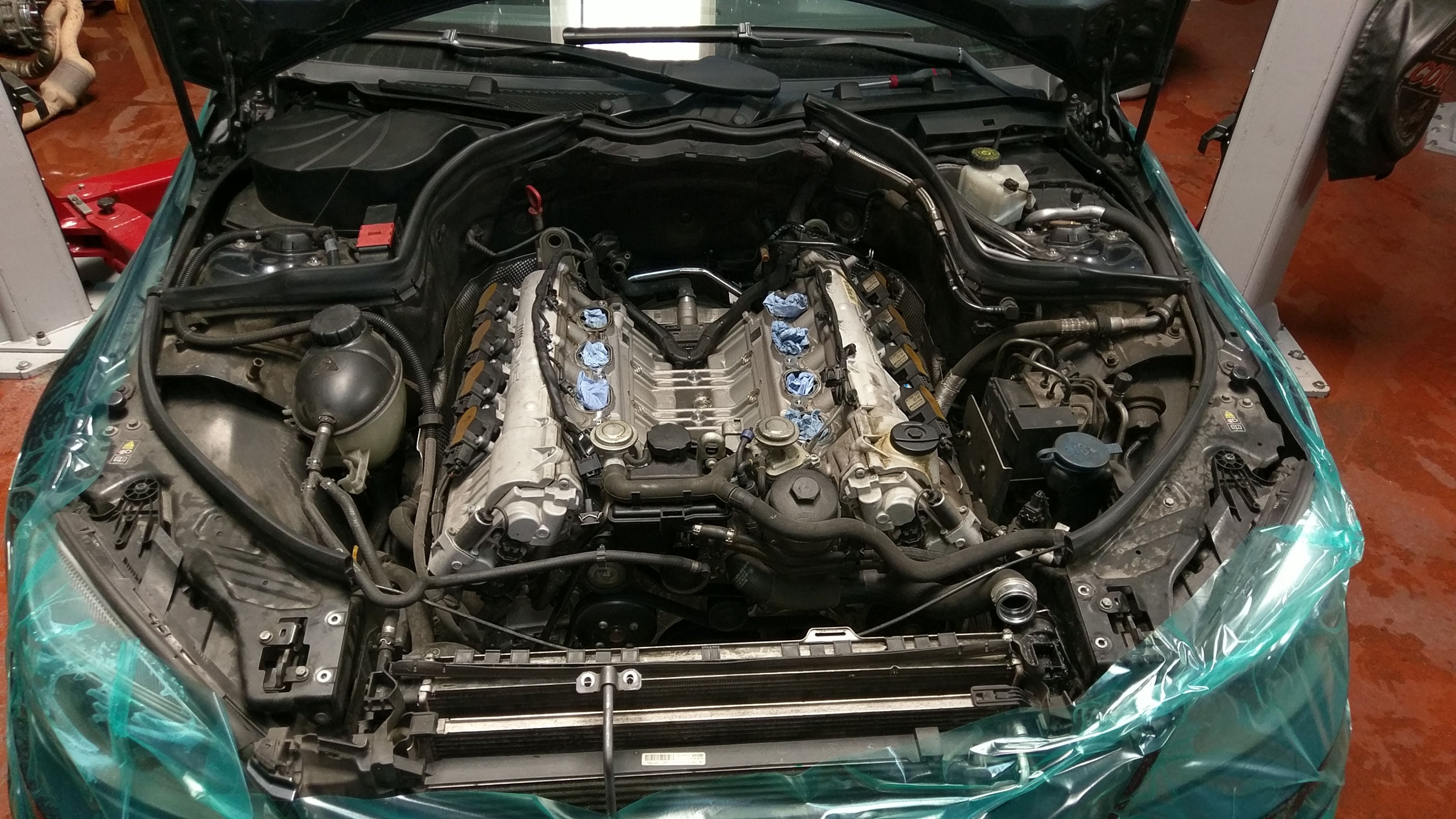

Jul 9, 2017 | 09:35 AM
Thank you very much
I am trying to upload some photos to confirm that the valve but I am not able. How to do it?
Whistling sound engine compartment-imag3961.jpg   Whistling sound engine compartment-imag3960.jpg
Reply 0
Jul 9, 2017 | 09:41 AM
In the end I managed to upload the photos !! Hahaha
Is this valve failing ?? I have a video of the whistle, I'll try to upload it ..
Reply 0
