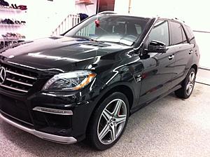

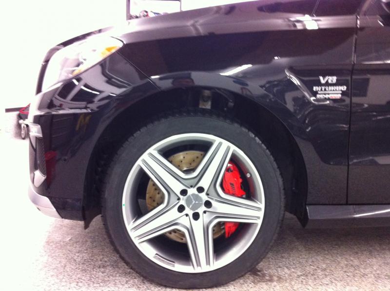

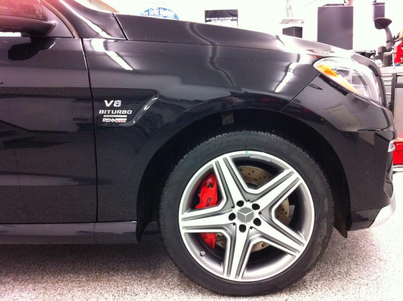

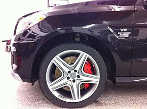

winter wheels
Originally Posted by EVOII_Racer
Thanks a lot for the posts Sir very interesting info
What rims/tires do you have for winter? How does your tuned ml63 handles in the snow?
I have the recommended MB wheels. 20" winter AMG rims and Pirelli Winters.
I love the wheels, they look and work amazing. I like the rims as much as the stock 21".
The Pirelli's are excellent in the snow and ice. Initially I was skeptical as I didn't care for the Pirelli Ice & Snow, and I am a die hard Blizzak fan. But I heard some good reviews on Pirelli's new Winter's and after trying them, I have no regrets. Handling, stopping, etc is excellent.
Here are some pics, although not great quality as I did a quick wash...
Attached Thumbnails m157 ml63 transmission-5.jpg   m157 ml63 transmission-8.jpg   m157 ml63 transmission-10.jpg
