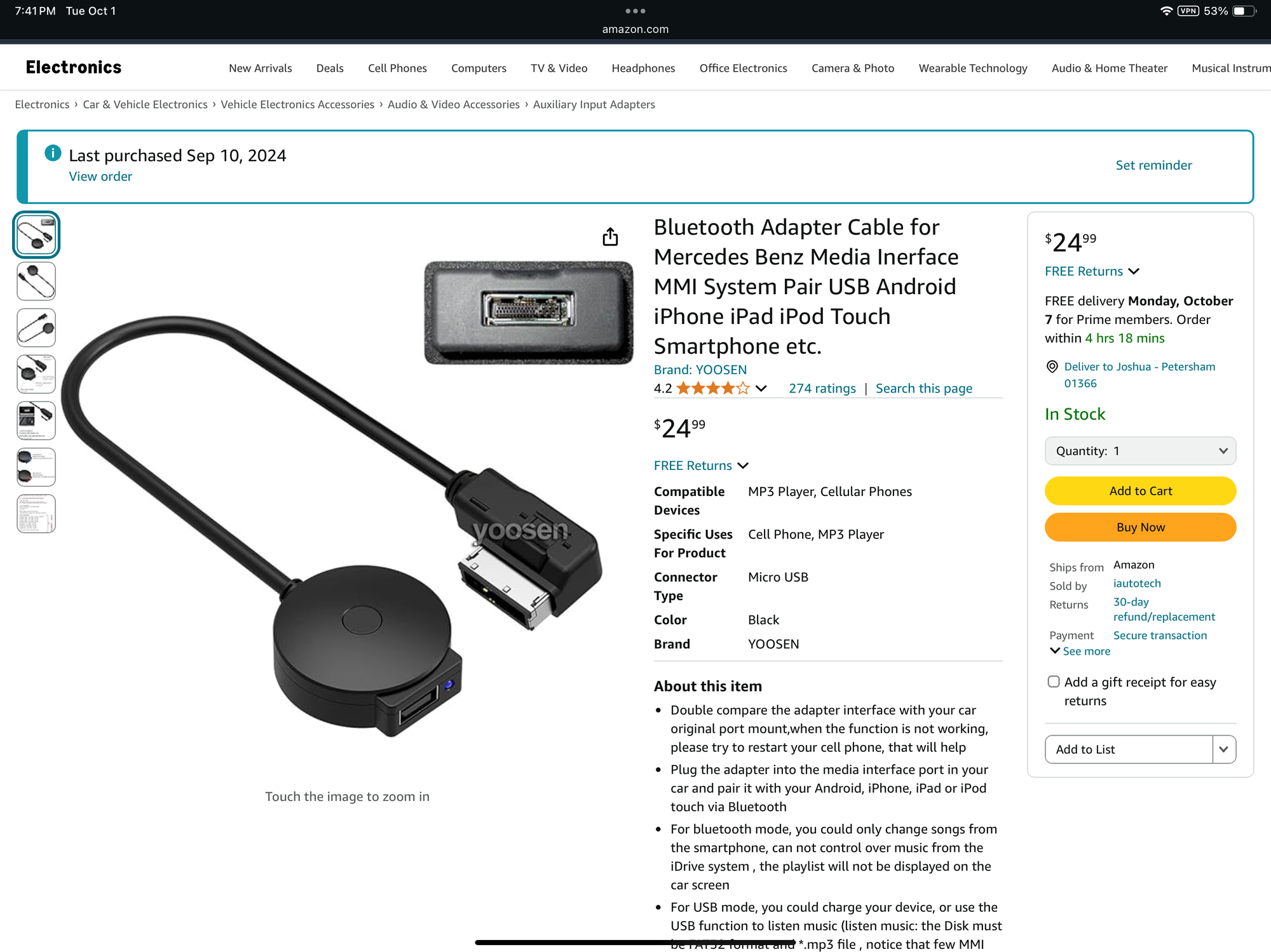

So my Sirius XM receiver in the ML just keeps conking out. It’ll say “no service” for long periods of time… and then start playing music when I’m 5 minutes from home. 😂 Since I’d rather be able to just stream from my iPhone anyway, I started looking for something reasonably priced and easy to use. I found this adapter on Amazon and for $25 it was worth a try. I’m happy to report that the adapter plug fits perfectly into the glovebox aux port, connects quickly and easily to your phone, and still lets your phone connect to the truck for phone calls. Audio quality of the music is much better than the typical Sirius XM satellite reception too. 👍

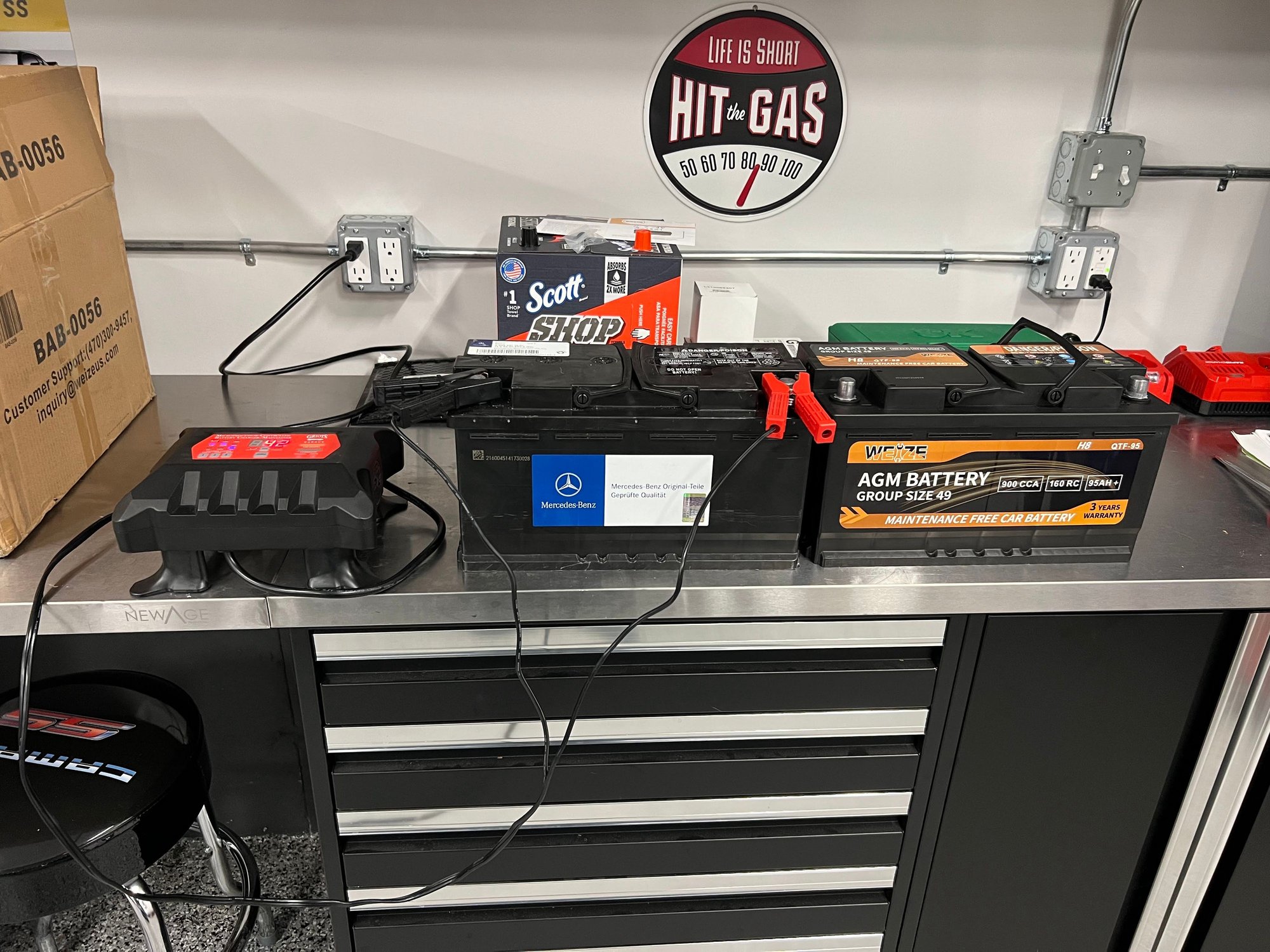

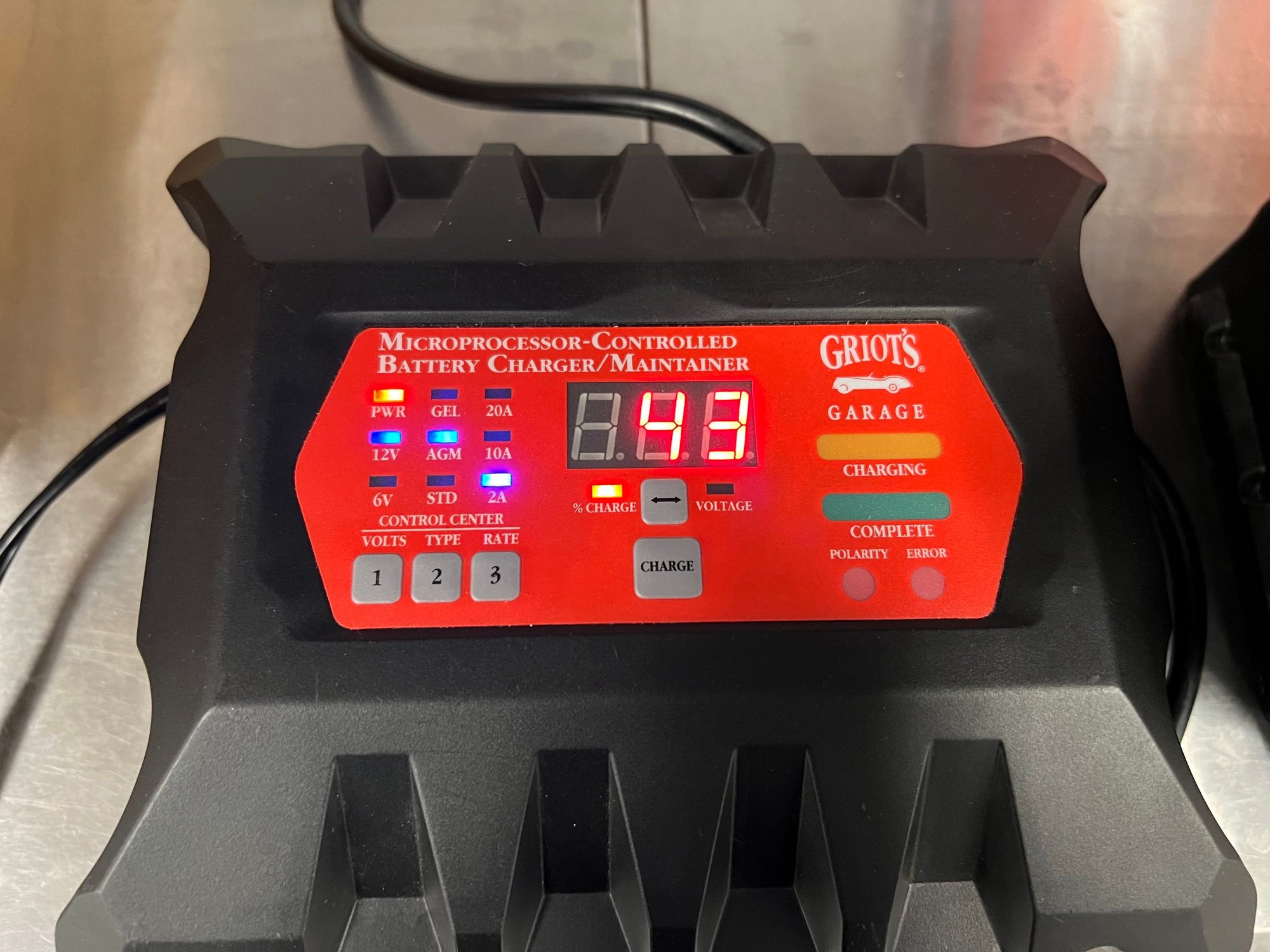

So the last few times I took the ML out, I noticed the hot starts were pretty crappy. Battery seemed weak. Voltage was under 12.0V with the car off and 13.7V running. So I pulled the battery and the terminals didn’t look great, so I cleaned everything up well and gave the battery a deep charge. Reinstalled it all and… no real difference. 🤷‍♂️ So I jumped online and bought a new AGM sealed battery with specs that were as good or better than the OEM MB battery. This time around, I smartened up and pulled the 2 inverted torx bolts at the front of the seat tracks (in addition to popping out the rear bolts) so I was able to move the seat entirely out of the way…. Made for much smoother sailing.
So I yanked out the old battery and threw it on the battery charger and sure enough, only at 43% charge. Glad I ordered a new one! New one sits at 12.9V so that’s a lot better. I dropped the new battery down into the hole and reconnected everything. I plugged in my scanner as I wasn’t sure if I needed to reset any battery management software going on, but didn’t need to. Seems like we’re back in business.

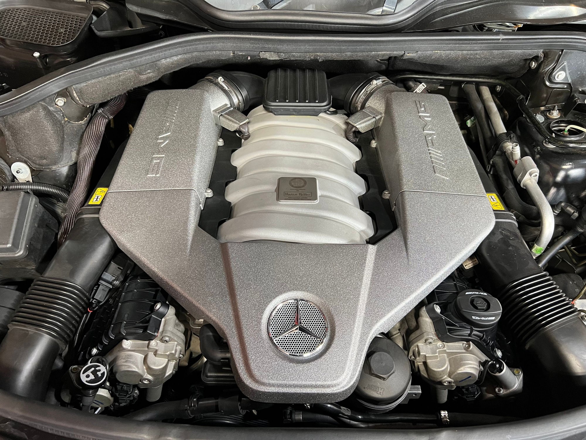

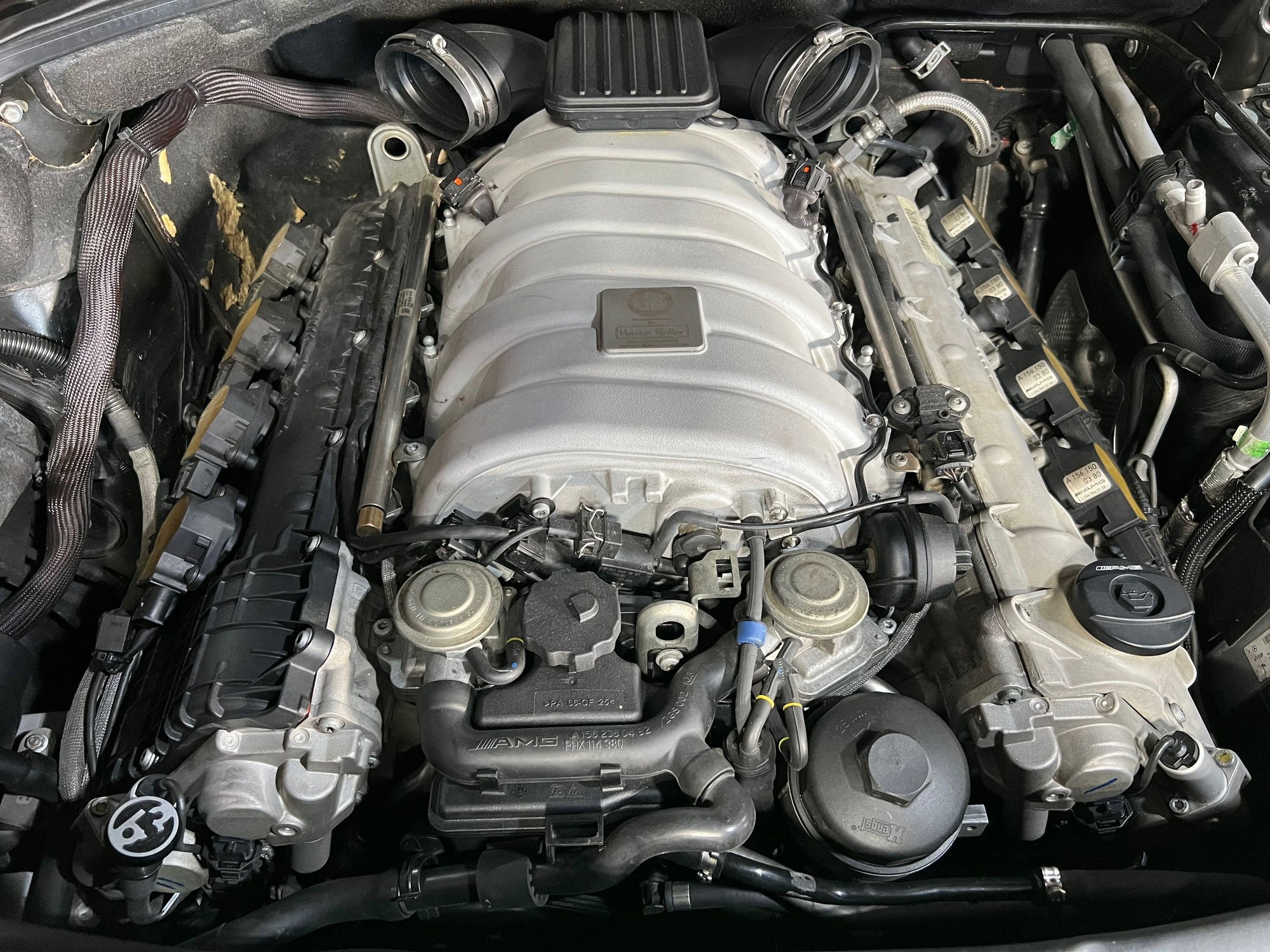

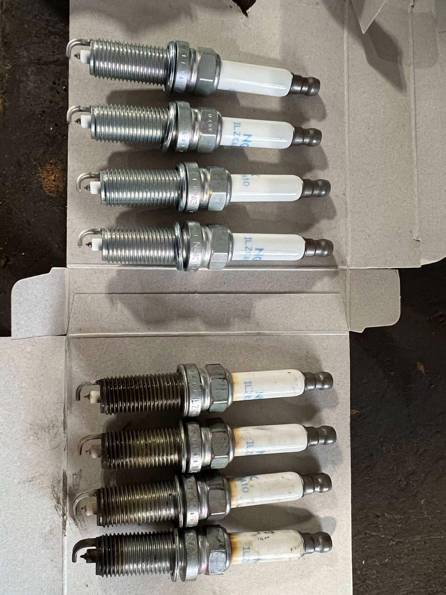

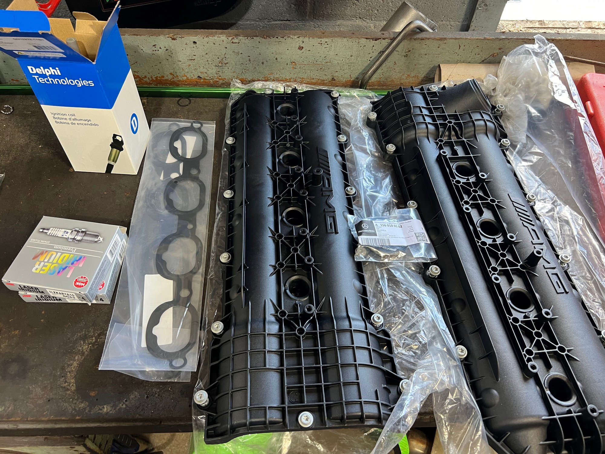

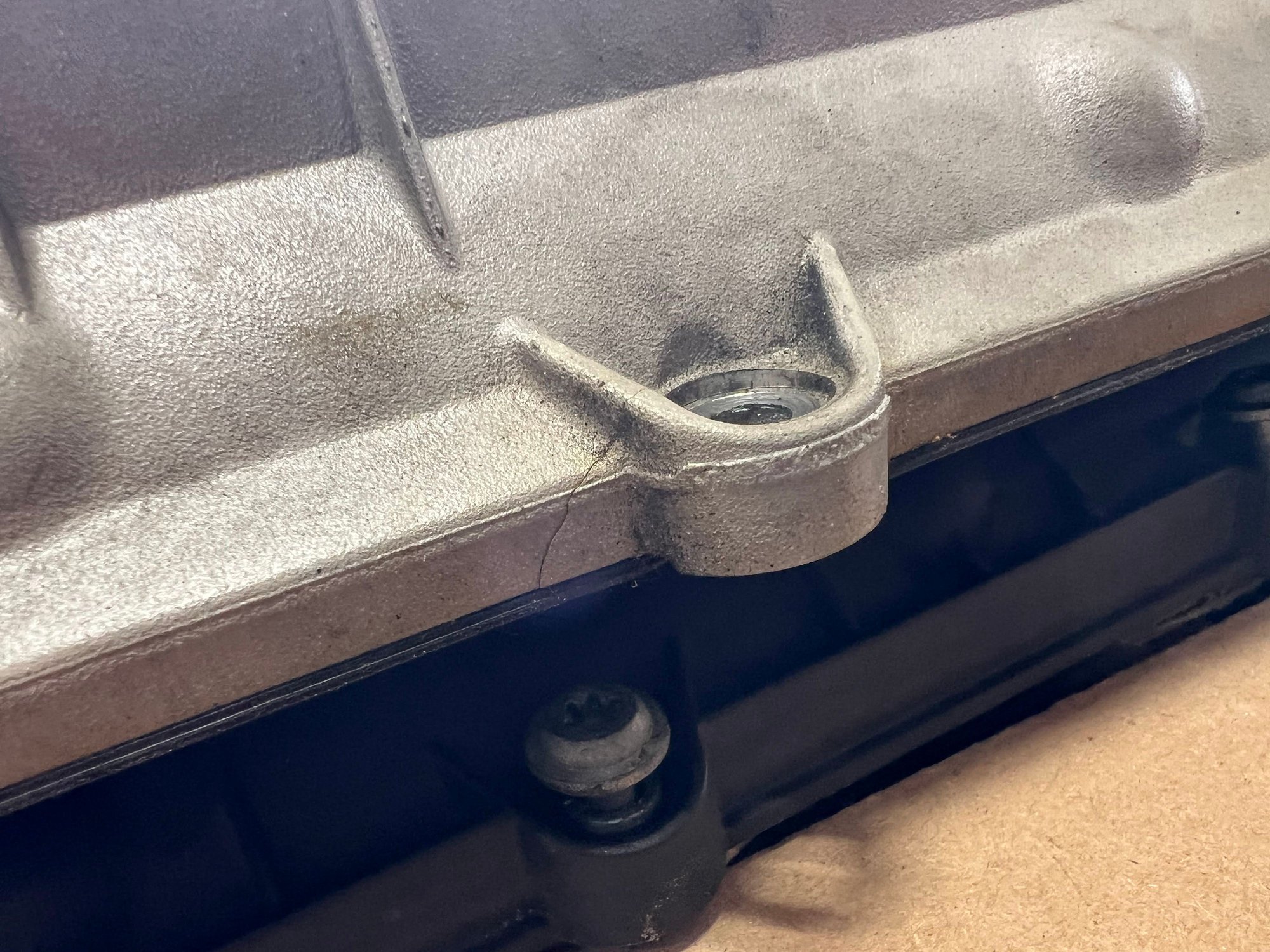

So I noticed recently after backing the ML out of the garage that I was getting some oil on the floor. I showed it to my mechanic and he thought it was probably the valve covers leaking. I put that as a mental note to get the leaks figured out sometime this spring. It irritated me that I had two different valve cover styles too…one early metal style and one newer plastic style. My OCD did not approve. 😂
But while out for a drive recently, I got a very obvious misfire which ended up being in cylinder number one. Figuring we’d have good access to the valve covers while doing plugs and/or coil packs to address the misfire, I decided to do all three things at once. So it went in and we got both new valve covers on, all new NGK OEM plugs, and a new coil pack in cylinder 1. She’s back to running at full power! I’ll give the motor a good cleanup the next nice day we have and hope the oil leaks are fixed too. And best of all, the valve covers match.
Before
Before
New MB valve covers, plugs, and coil pack.
Plugs were definitely getting tired… it’s obvious which plug wasn’t firing lol
Metal valve cover with hairline crack in it.
All buttoned up
All buttoned up

Great thread this one. Im fairly sure they updated the valve covers from magnesium to plastic at some point as the metal ones kept warping and leaking. Sounds like someone's only done one on yours.
Thanks! And now they’re definitely BOTH done haha
