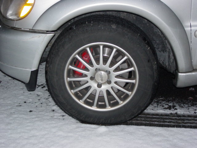

I got a set of Moda R3(maybe R4s) 17X8 wheels and tires from Tirerack.com for winter. I only paid about 125-150 a wheel. They fit on the 55 just fine, this is my second winter with them on the car. I would call tire rack and see what they have. My whole package came to about 1100. I purchased a set of 430 wheels off ebay and they didnt fit. So now I have a set of ML430 wheels and im out 300bucks If you want a picture of the wheel let me know and ill post one... its a 10spoke wheel, not bad for a winter wheel.

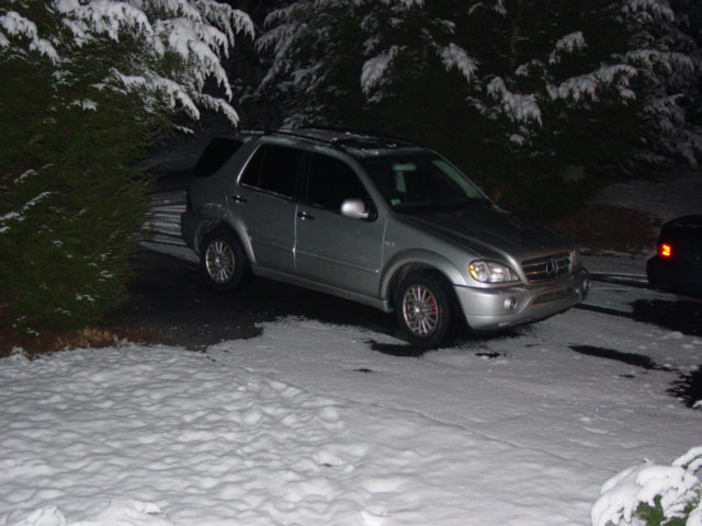

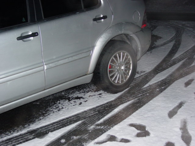

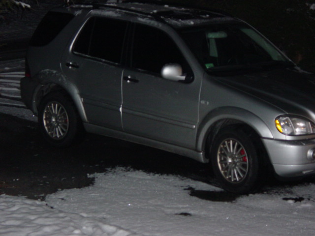

Here yall go, I have posted so much in the last few days I forgot I was asked about what the wheels look like... here are my NASTY winter wheels, joke.
What do yall think was I hosed?
