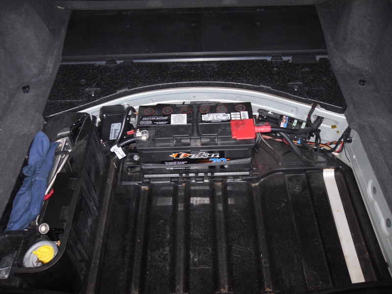

hey is your second issue sounds like you have the center console parts but do you have the rest of the phone system you see in 03 the phone was an option so you need to check your trunk behind the side panels and the eletronic compartment under the trunk carpet for the main part of the phone system if you don't have those parts the parts you have will not work hope this helps

Here are some pics of my center console with phone cradle and trunk area. I think I have the phone option, but am not sure. If I do, I'm still not sure which part I need.

On an '03, with the phone cradle you just need the v60 style puck part #B67875856.
