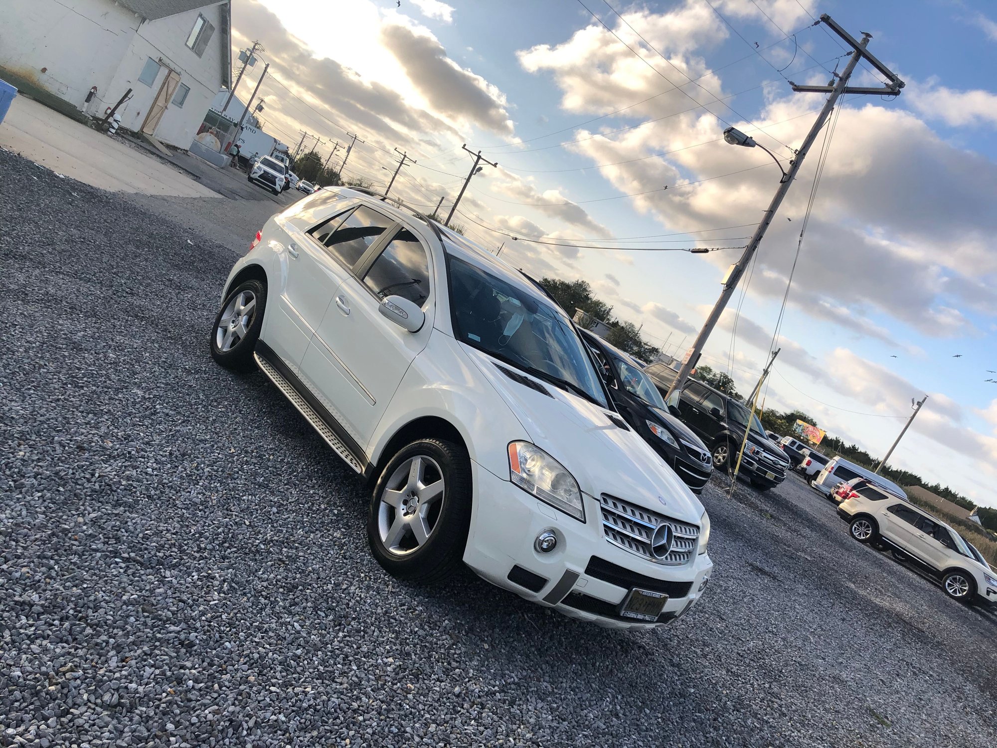

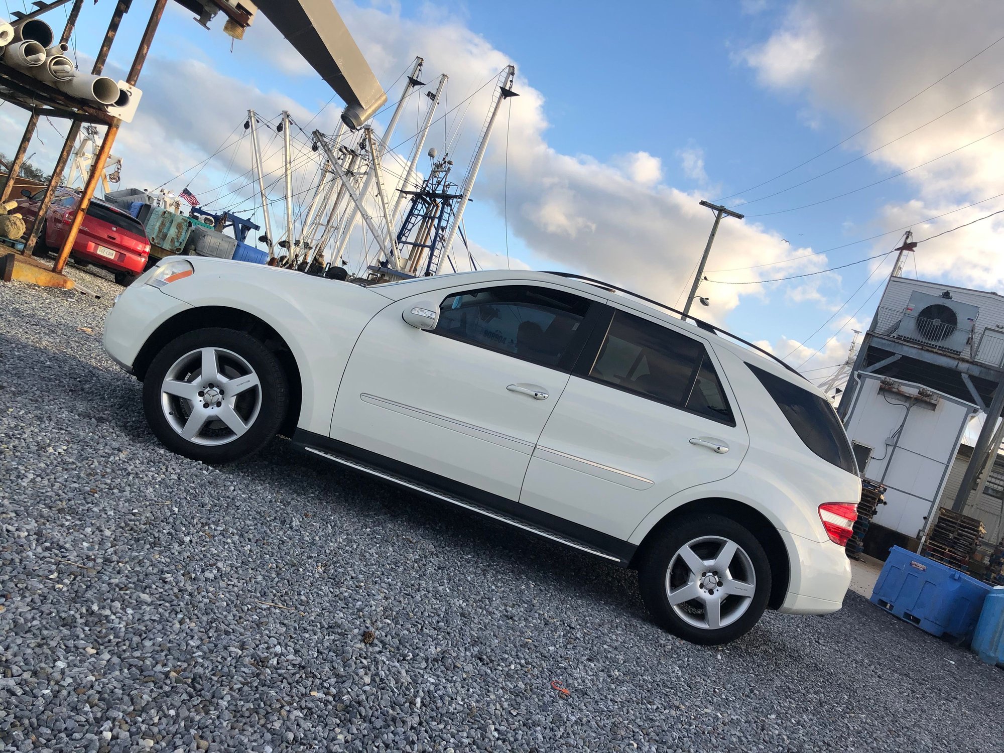

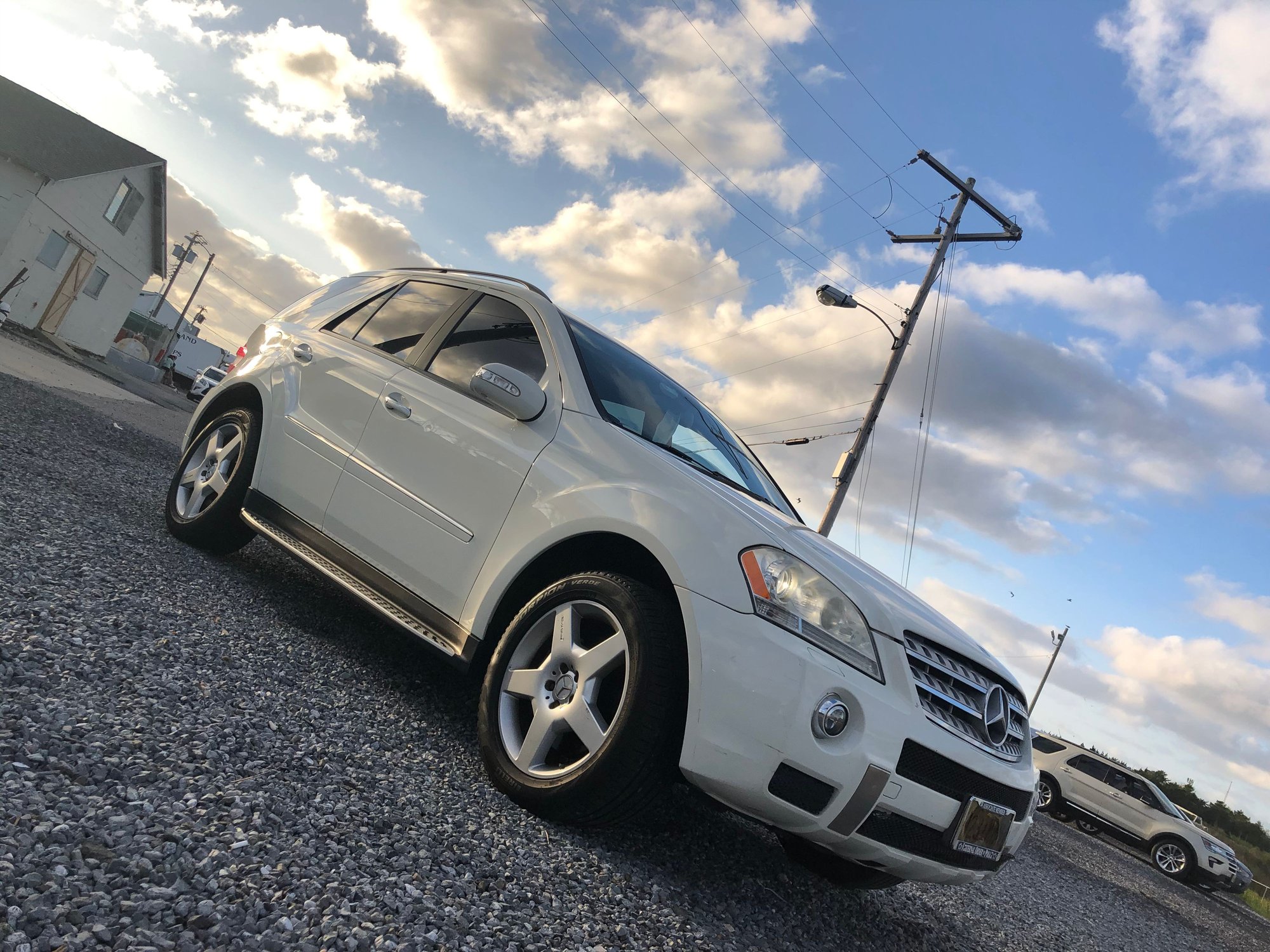

Welcome! Please post a photo of the ML.

Welcome please post picture of your ride

Looks great! Were things working normally when you bought vehicle?
