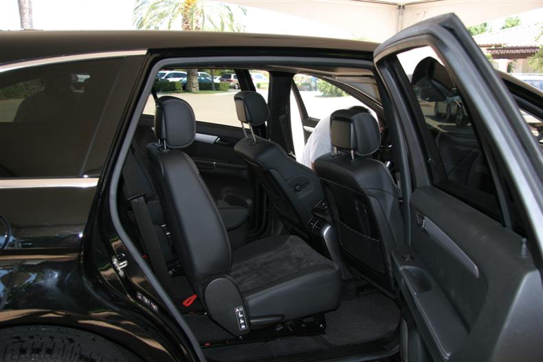

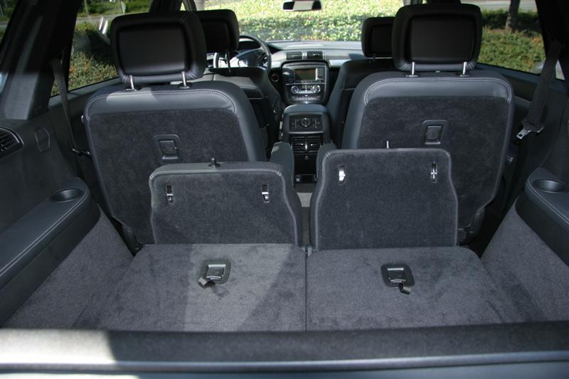

Wow, that definitely is a sunshade...
The Rs I saw today definitely did NOT have this... see pics. guess it's part of some package? these were R500s in these pics, so it's not that those are on a 500 but not a 350.
Attached Thumbnails R Class Sunshades on 2nd Row Windows-img_1013.jpg   R Class Sunshades on 2nd Row Windows-img_0979b.jpg

This looks like the Saks 5th Avenue package they announced. The Sunshade is only on the cars with the Comfort Package selected as an Option per MB in the response above. Again great shots.
