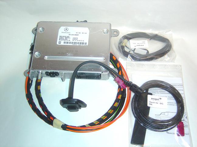

Phone Control Module
I believe that we still need a phone control module which will be connected between the "pre-wired" part and Head Unit.
Here is the parts I think it must be installed onto our "prewired" system.
EL

Thanks for the picture. Now, I understand better after I saw the picture. Currently, I just bought one of those Bluetooth speaker. It works find so far.
