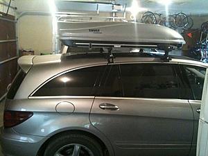

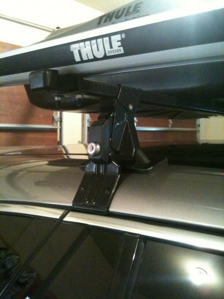

Forget those whimpy factory roof rack mounts...you have a better option...
So my biggest dissapointment with this car has been the stupid factory mount points for roof racks. (Why the heck didn't MB put at least rails on the car so you could mount a rack right!!??)
Well, I've sold and have used Thule stuff for 25+ years and thought I would look for a better way to mount a roof rack. (Afterall, yakima makes a rack that mounts on the R without using the factory points...so why not Thule?)
I figured it out and my system is on and WAAAAAYYY better then using the little factory bolt on points.
I used a standard Thule 400 foot pack, 58 inch load bars, Thule Fit kit 268 (Crystler Minivan) bracket for the rear of the car (you need a super long bracket and the fit kit 268 is perfect!) and also Thule Fit kit from a 2000 VW Golf...(Pretty sure that is #2047).
You will need to do some VERY minor bending of the fit kit lips to align with the door frame...I mean minor as is in a degree or two of angle...easy.
Take a look at the pictures and you will see how simple it is!! Plus the bikes and box and any accessories are mounted back on the car where they belong! No more having your roof box stick 3 feet out past your windshield...that is plain goofy!
The system is totally solid and will allow me to carry MUCH more gear for sure!!
Disclaimer - DO THIS AT YOUR OWN RISK AS THIS IS NOT A THULE 'APPROVED' SYSTEM. It's not rocket science though
Attached Thumbnails Forget those whimpy factory roof rack mounts...you have a better option...-full-car.jpg   Forget those whimpy factory roof rack mounts...you have a better option...-front-clip.jpg   Forget those whimpy factory roof rack mounts...you have a better option...-rear-clip.jpg

Sure, to each there own. The MB OEM rack while made by Thule, allows little for flexability when it comes to being able to use longer bars...you can't. So trying to use a large roof box, bike mounts and wheel mounts is not possible with the factory one. The Thule pads and fit kits are all rubber coated so as long as they and the car are clean, no issus with scratching. Weatherstrip on door..non issue. I bet mine comes off just as fast!! Personally, I sure as heck don't like the thought of a LOADED rack being held on by 4 little threaded bolts. No thanks.
I also like have my roof box mounted back over the roof and not over the windshield...
Anyway, just throwing out another way to do it!

MB Factory roof spoiler, yes...as far as the rack...
I have a HUGE thule roof box AND can carry 4 bikes on the roof with this setup...just makes more sense to me...the factory MB bars just don't give you much option as they are so narrow...I also like the box mounted back on the car and not over the windshield. It simply looks better.
Anyway, pretty happy with my setup.

Yep, my 'Thule' setup allows for a LARGE thule roof box and I can squeeze 4 bikes on the roof...can't do that with a MB rack...nor would I feel comfortable with that weight of stuff being held by 4 little bolts...
Hence I went custom to fit my needs and allow for greater versatility, better looks and allow for a little higher weight loads...

actually, the aero fit kit that you have uses smaller diameter bolts to hold the clamps to the bodywork than the bolts in the 460 podium kit that thule specs for the w251. furthermore, the clamping action that you are using depends on a friction fit rather than a mechanical fastener. i will leave it to the more engineering inclined readers to point out the benefits vs drawbacks of each...that being said, the correct thule podium 460 kit is well engineered, as stout as the OEM bars and can bear some significant weight. i am not saying that your setup won't work, just that both mercedes and thule are perfectly good and each serves a different purpose.

I dont disagree with you at all...I actually started the process with the MB set up that came with the car (sits WAAY to high up on the roof) and then to the Thule 460 set up thinking that would suffice. I just couldn't stand everything being mounted out over the windshield. (Especially the box) It just looks goofy IMO. My 'way' certainly works and my old aero feet have the big allen bolts. That rack ain't budging.
This whole thread was started to simply present another option...to each his own.
