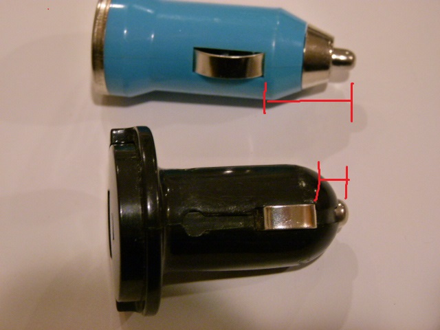

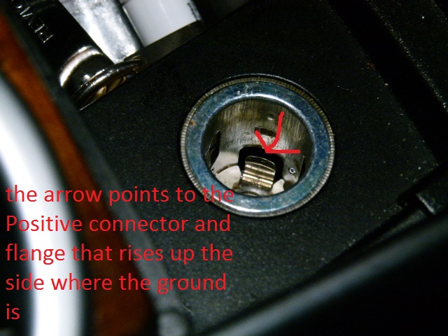

wait ... cigar lighter sockets are different in MB! we have 2 of them and have to be careful what sort of adaptor you put in. There is a positive connection that comes up on the sides and can easily be shorted by adaptors that have ground contacts too low down.
Attached Thumbnails Next issue, cigerette lighter-socket.jpg   Next issue, cigerette lighter-plugs.jpg

does the fuse only blow when you stick a plug in? if so, its what you plug in, not the socket .

Please pay attention to @efzauner. All the socket does is act like a plug in your house... just like your house, if you short circuit a plug it will blow a fuse or breaker.
Like he said, the Mercedes socket is sensitive to the placement of contacts on an adapter. If the outer contact is too close to the base it will short out and cause the fuse to blow. The socket only draws what the device that is plugged into it pulls.
Another way to test your adapter, is to pay attention to the center bar in your socket. Put your adapter in making sure the outer contacts are perpendicular to the center bar. Then turn it... bet the fuse pops once you twist it and the outer contact hits that bar......

@miyanc... its the blue adaptor that is the good one!
Never ever fit bigger fuses! it is ok to replace a 15 amp fuse with a 20 amp, but putting in a 50 amp fuse you are asking for major trouble. Your wiring may heat up and melt the insulation making a total mess of the wiring harness and maybe even causing a fire.
You don't seem to understand the basics of electricity. At this point, do what Josworth suggests: look into the socket and insert the adaptor so that the adaptor ground connection is not touching the socket positive. If you can't solve your problem bring it to a shop.
MB is real screwy on this. I don't understand why they put those positive lugs up the socket.

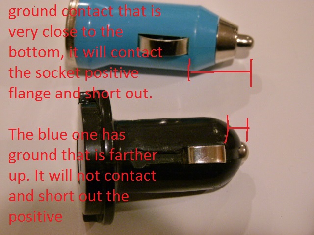

I edited the pictures to explain what is happening. From your statement:
"I have not seen the mb lighter, but I bet it looks like the not blue example you were showing. With the larger flange. This is usually done to prevent the entire thing from going to far in."
you seem to be misunderstanding what issue I am trying to explain. The wider plastic flange is irrelevant to this discussion. It does nothing.
It may not be this, it would be the first thing to check before you open up the center console. Have you tried plugging it into other sockets? You should have more than one! Each has its own fuse.
Do you have any other adaptor to try? The pictures I posted are USB adaptors.
BTW did you try to get the standard Bluetooth puck instead of an aftermarket adaptor? It is fully integrated into the audio system. Very nice actually.
Attached Thumbnails Next issue, cigerette lighter-plugs.jpg   Next issue, cigerette lighter-socket.jpg

So, did you ever figure out your socket issue? I seriously think your adapter is shorting it out. The odds of there being another short in the harness are pretty slim.
