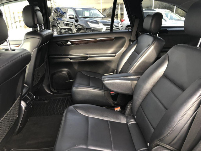

Just purchased a 2012 this month and it has the center console with the cup holders. It also has a drawer pull/handle at the bottom which when pulled easily removes the entire thing. Useful when you want access to the 3rd row from the center.

Would you please snap a photo of this when you get a chance and post it for us to see?
Thanks!

Center Console 2012 R350 4Matic

Originally Posted by Merco-Benz-350
Thank you for that!
I love the color too.
Did the vehicle come equipped with the center console or was it installed by the previous owner?
You'd know by running your VIN through an MB VIN decoder to see the options it was installed with at the factory.
That would likely involve replacing the whole 2nd row.
Which I think nycr350 will have to do to get the same results.
