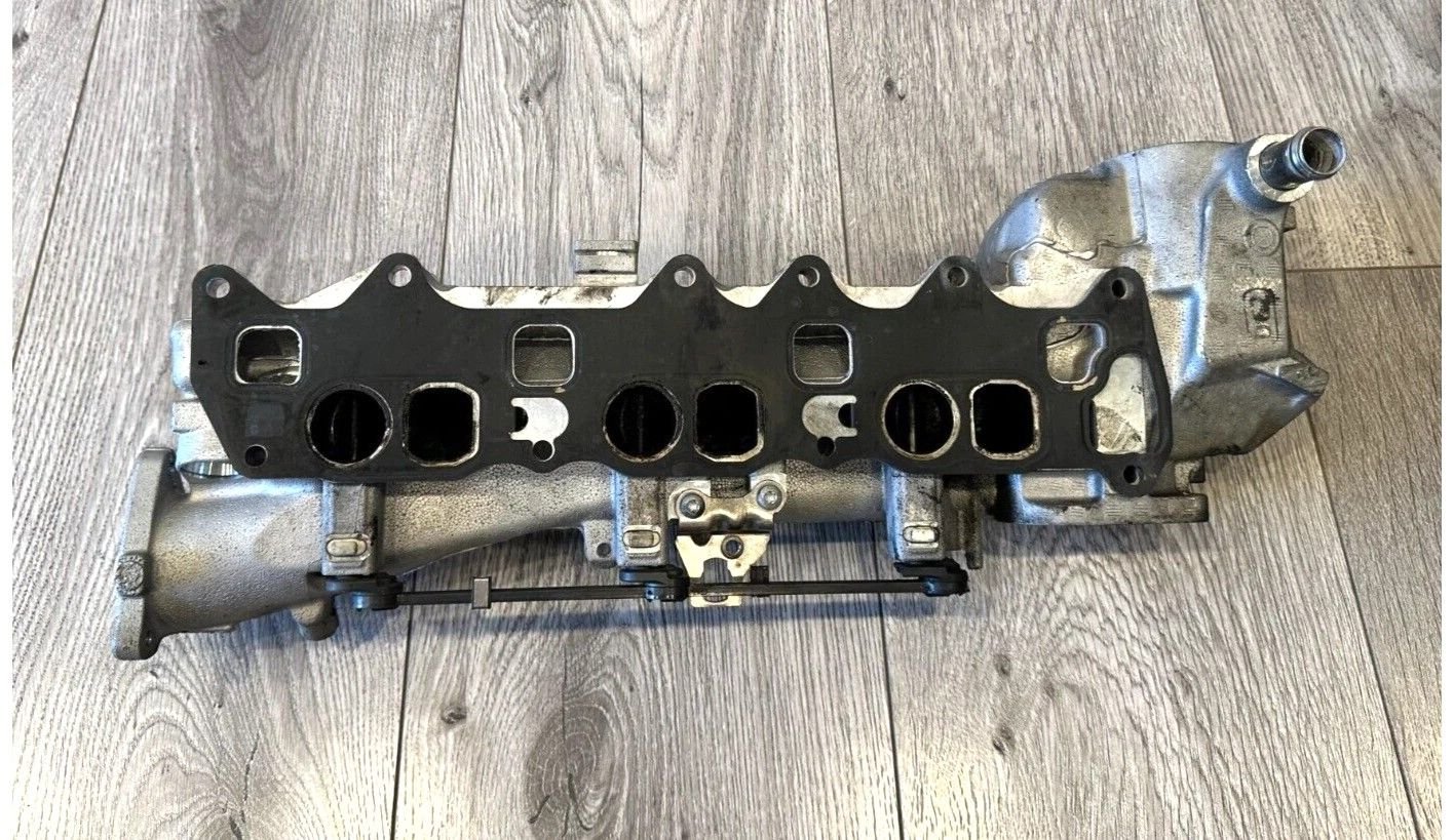

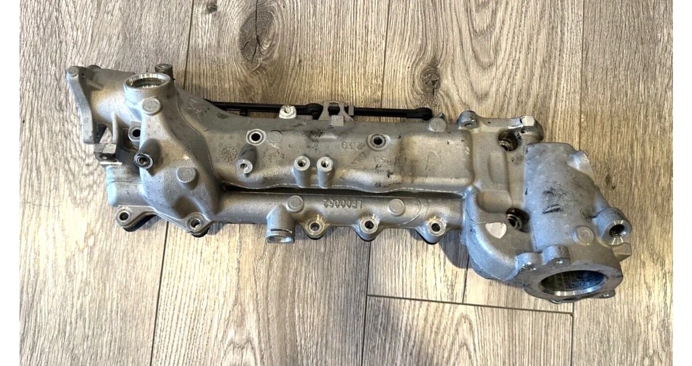

Are these the intake runners that have to be removed? I have looked around for YouTube videos, but found them for the older model years.

In my head it was the two plastic pipes that go from your grill to the engine cover that holds your air filter. Both of them easily snap off with your hands one tube on each side of the engine right in front of your face

So the runners in the photos I sent don't have to come off?
I had the plastic cover off the car and the brace, but I didn't see the coils. I thought I had seen a video or write-up that said the intake had to come off, but I can't find it now.

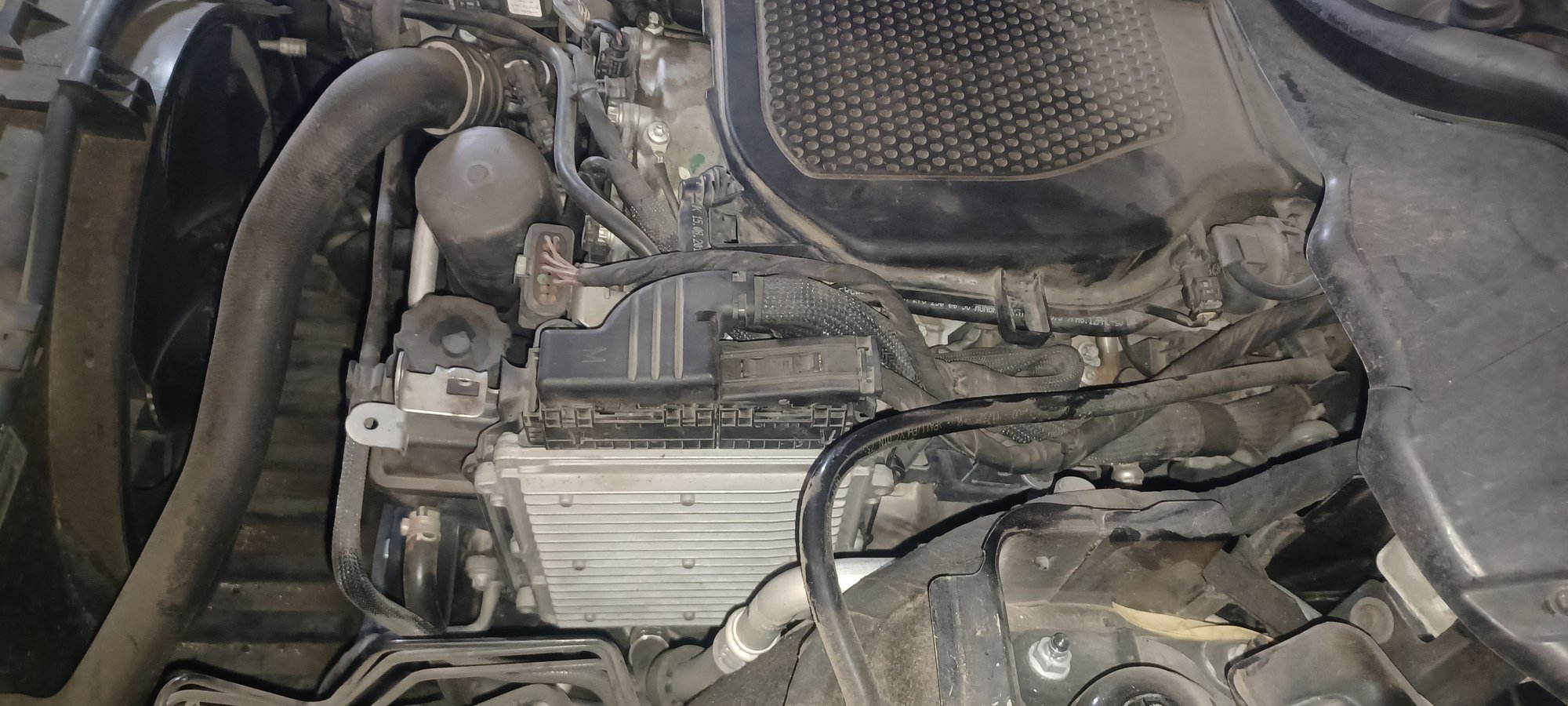

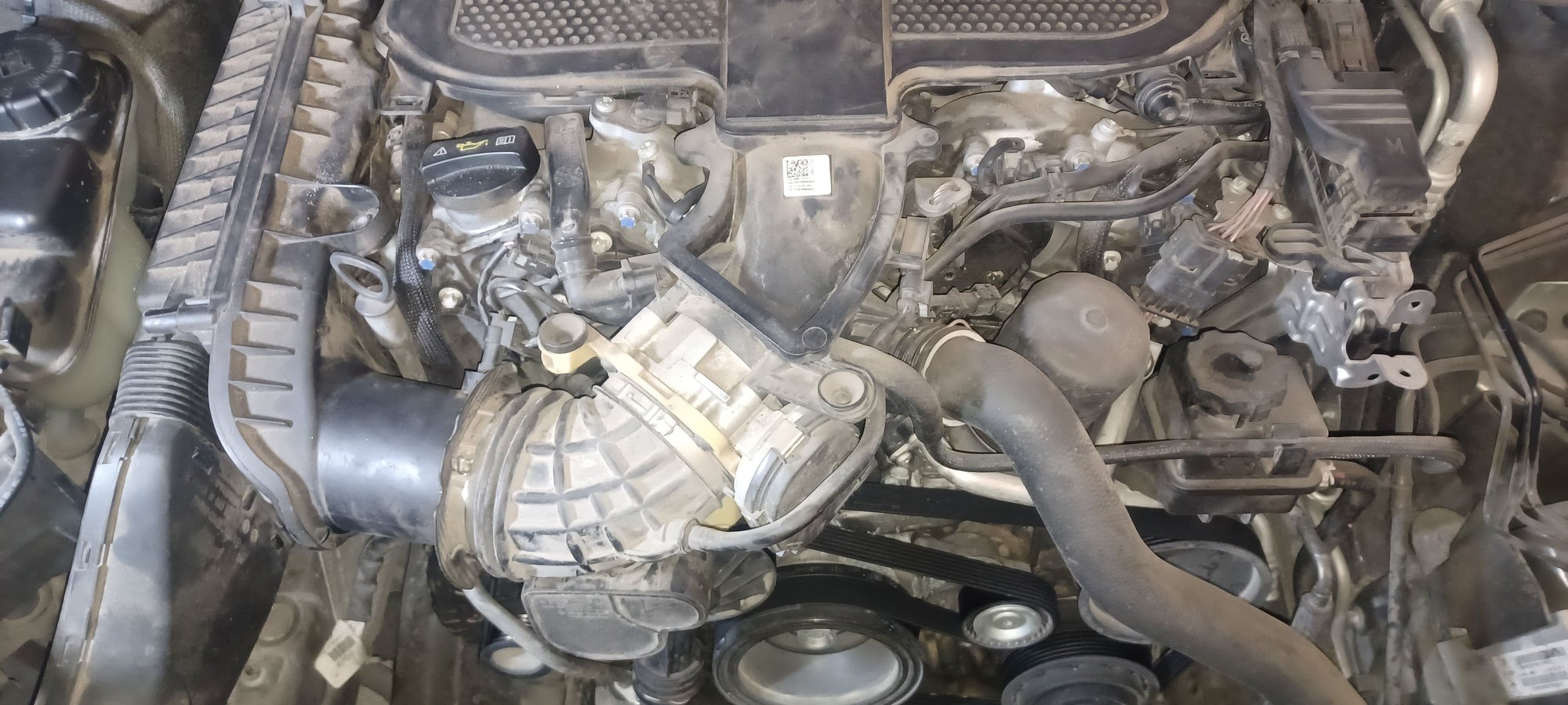

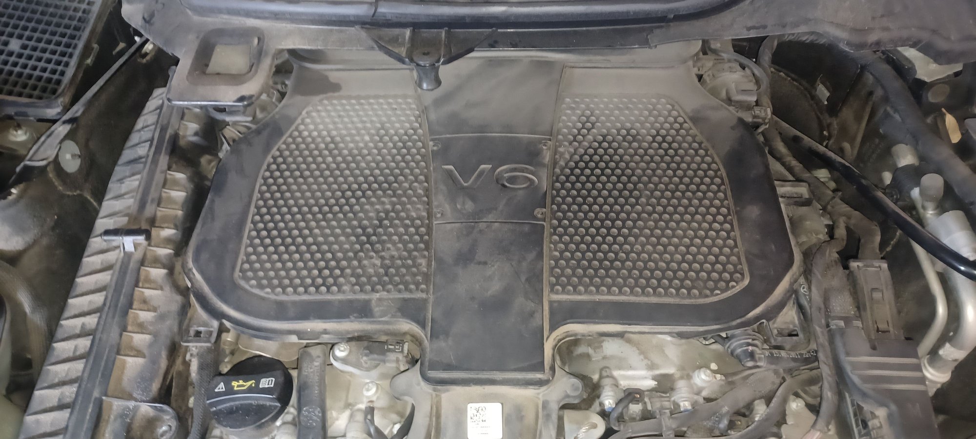

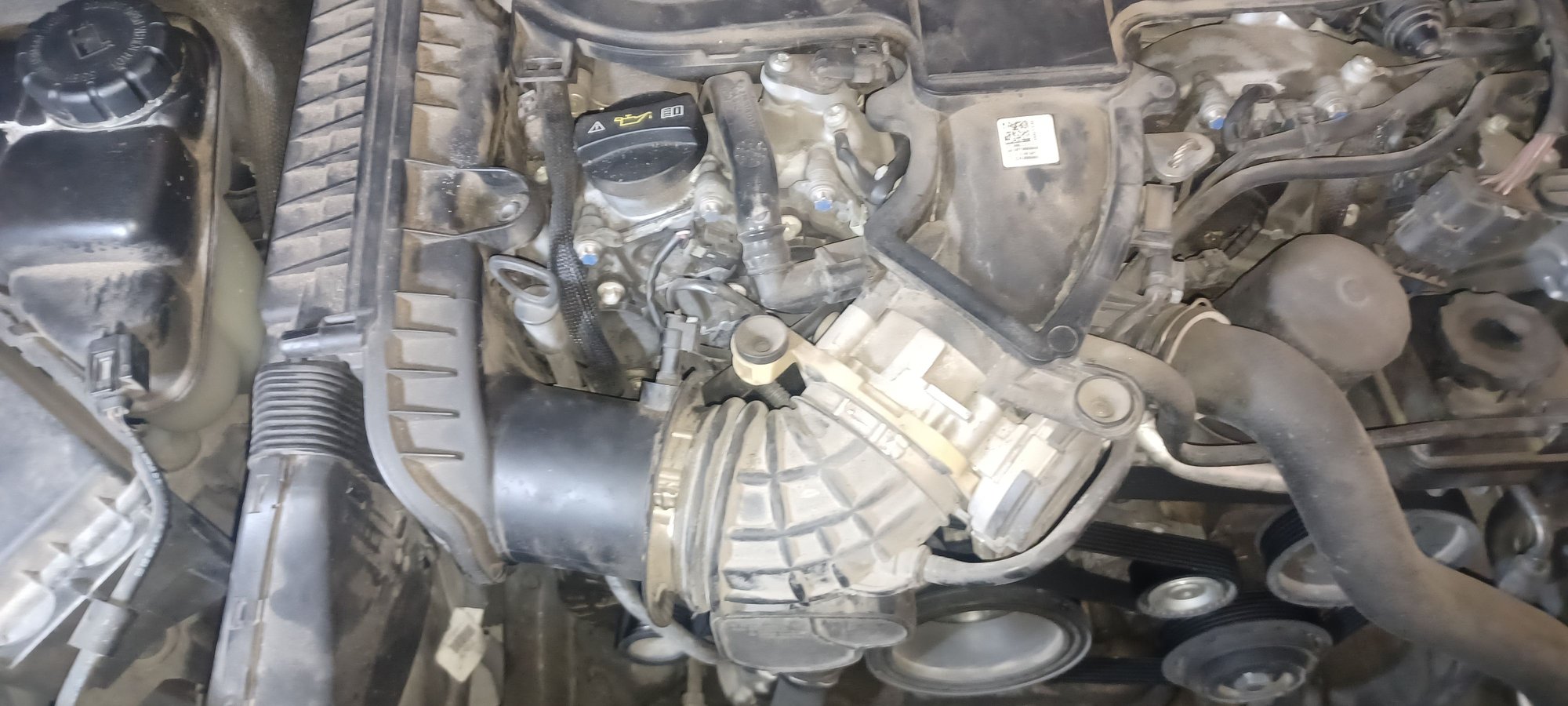

I have been working on various vehicles for 40 years. I have the brace and the plastic covers off. The cover that has V6 on it does not simply pop off. There is one snorkel on the right side of the engine. The air cleaner box to the throttle body to the what appears to be the intake cover (has V6 on it) is a solid piece. I don't see how it is connected to the engine. Please see the attached photos. This may be a different engine than what you have. Thoughts?

I figured it out. This R350 actually has the M276 engine in it.

Yes they were talking about the older V6, I have a 2012 as well it only came with the M276 which is most commonly found in 2011ish E350’s if you are looking for tutorials on YouTube. Ours just sits a little farther back in the engine bay and the cowel covers most of it.
that plastic part with the V6 is the top of the intake manifold/runners which you will need to remove to get to the top of the “V” and access them.
here is a great video walk through same engine different engine bay.
def you need to remove the cowel it’s not hard to do but after that follow the video
