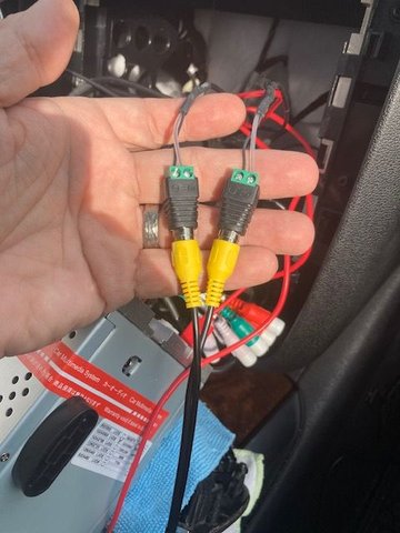

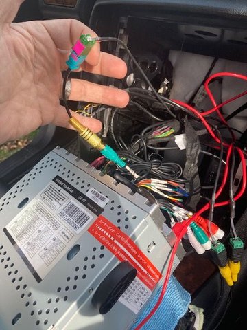

install was fairly easy just click in the big factory connector, but I did have to get some extra pieces.
1.two fakra to sma adapters to use the factory bluetooth and gps antennas
2. a hand full of rca to screw terminal adapters for the rear entertainment wiring, I could have put one on the factory rear camera cable instead of using an adapter but I bought an rca to fakra adapter for the rear camera which was absolutely plug and play no extra wiring needed besides the adapter.
the AM FM has no reception yet, my car didn't have the factory am fm anteanna double fakra cable that would just plug into the back of the new HU so awaiting the 15'fakra male to fakra female for the radio antenna to route from the sirus module to the radio although I kinda want to try and integrate the sirus module properly, dunno if it's possible integrating the sirus reciever to the android headunit.

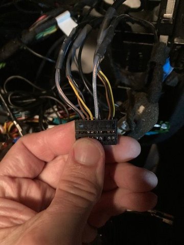

I haven't gotten the headrest displays working yet. I don't know if it is a connection issue, the amazon usb to rca adapter I got is bad, or a setting issue.
I have an official erisin usb to rca adapter coming incase the amazon adapter is the isssue.
my understanding is the plug in the pic is the headrest monitor connections with video and audio for both monitors and the two clear teflon wires are the video while the brown and yellow are the sound and all the associated black common wires. is this correct?

The erisin ES102 USB-RCA-Converter came in and now the rear monitors work. Use the remote to set each monitor to the command unit up front (I don't recall the exact term but set it to the oe head unit) and it displays what is on the head unit screen.
