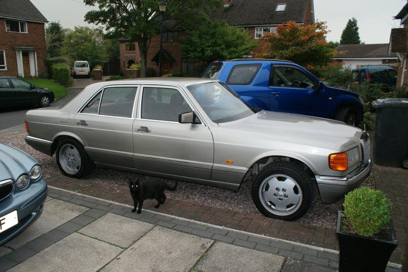

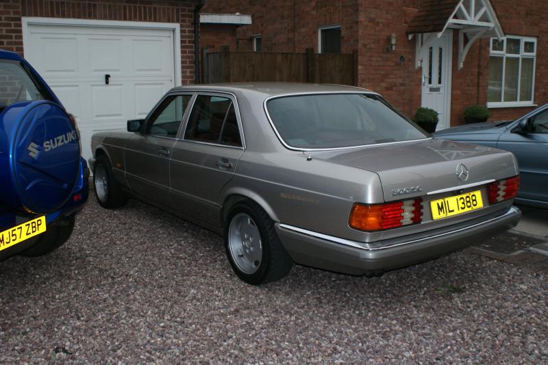

just picked up the Merc after 4 weeks in the shop. $2000 later and she rolled out sounding great. Low miles has not helped her. valve stem seals replaced. New water pump and pipes, prop shaft rubbers and other bits and pieces. Anyway here is a shot with some wheels I put on yesterday, retro aftermarket. flash makes them look a little small but they are 17 inch with an offset of 11
Nick
