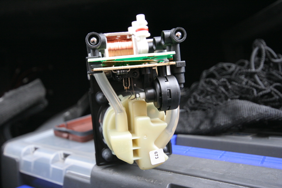

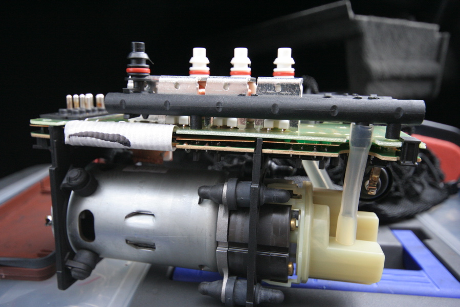

I do not have the V12 article, but for adjusting the cut off pressure of the Close Assist;
1. Find the pump under the carpet in front of the fuel tank,
left-hand side when viewing into the trunk. Its encased in foam.
This is a Coupe variant, with fewer lines;
2. Carefully disconnect the lines with a small spanner to help.
3. Remove the cover. If I remember correctly, to remove, use
a flat screwdriver on the gap between the bottom and the cover.
Possibly also remove the 2 top screws.
4. Reconnect the lines (no need to reconnect the vent line) and operate
soft-close while watching the pressure cut off seen here;
5. If it does not active, and the pump runs for 10s and time out;
Turn the hex adjusting bolt outward for the pump to shutoff at lower pressure.
6. Make sure that the door actually closes fully before the shutoff pressure is reached.
Hope that helps.
