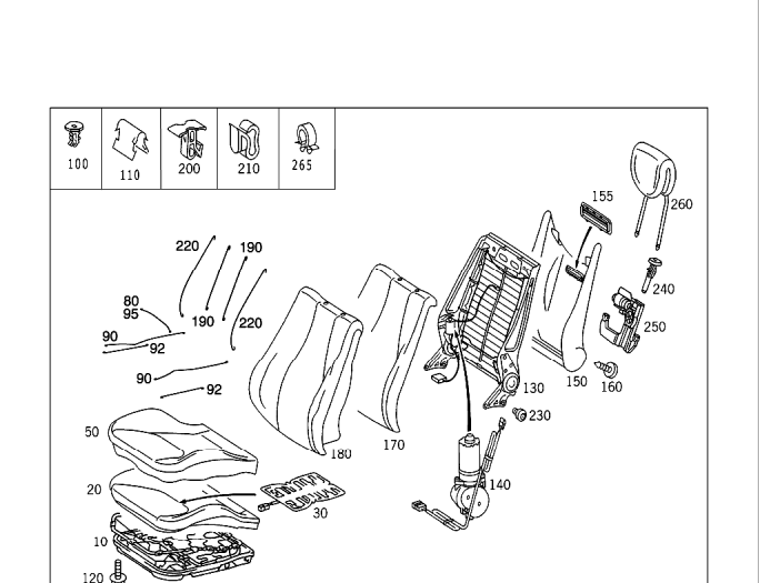

My passenger seat headrest rattles. Makes me nuts, actually when driving over uneven pavement (lots of it here in Dallas), and my passenger door makes a rattle when you close it. Something inside it maybe? Before I tear into things, has anyone experienced these same issues and fixed them? I'm a bit reluctant to pull the door panel since the car is so nice. Same for that passenger seat.............

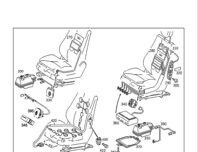

Look at these diagrams closely. Your ratles could be coming from these clips and pins 100, 110, 160, 200, 210, 265, one of those clips could be loose and vibrates on rough terrain.
Attached Thumbnails Fixing rattle in passenger seat and door.....-seat1.gif   Fixing rattle in passenger seat and door.....-seat2.gif
