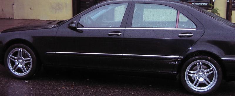

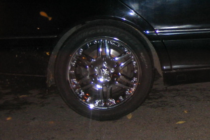

I have a question for all, would your suspension have anything to do with this problem. I recently upgrade to 18in from stock and also notice that when the car is on an uneven road or bump the rear wheel would rub the outside of the tire and also there's some vibration when traveling at mile that exceed 60 mph and sometimes uncontrollable pulling (left to right or right to left).
I when with the spec that tire rack suggested: 245/45/18 front and 275/40/18 rear.

the offset seems off your rim looks like it sticking out on those 18" wheels

yes that is exactly what is happenieng to my car
the back right wheel sticks out and it rubs on the arches.
I have exactly the same wheels I think its cos they are replicas.
I suggest changing for some originals

These are some Rennen wheels and I found out that the offset is 38. MB recommend that you use an offset between 35 and 42 so i'm not sure why these don't fit. Did you take yours off and went with some originals?
