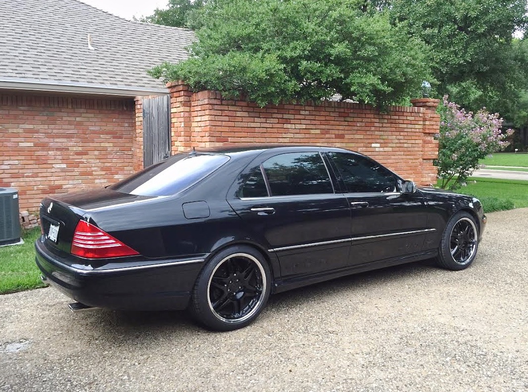

20" Brabus VI
Attached Thumbnails OFFICIAL: w220 Wheel/Tire THREAD!-brabus_1b.jpg
Old Jun 21, 2015 | 04:30 PM
  #32
e55dallas's Avatar
Joined: Mar 2010
Posts: 89
S500
fronts are pushing the limits of height.
Attached Thumbnails OFFICIAL: w220 Wheel/Tire THREAD!-brabus_4b.jpg
