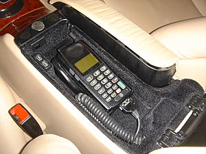

sorry to threadjack, but do i follow the same writeup for my setup if my 2000 S430 is equipped with this phone?

Yes that is exactly what I had in my car. just change PSE and get cradle or eliminator cable sync phone done

thanks! only 3 parts needed?
- universal PSE
- cradle eliminator cable
- BT puck
Old Dec 23, 2010 | 02:18 PM
la22bay's Avatar
Posts: 129
From: New Jersey
2014 S550 4matic 2003 SL500 2009 CLS550 2008 CLK350 2002 L320 2006 E350
- universal PSE
- BT puck
that's all you need, if your desire I have a contact that sell v60 cradle it's $125.00 but eliminator cable 49.99. I bought both like cradle better. you can remove old phone leave cradle, put cable eliminator in, use velcro strip on bottom of puck and old cradle to hold in place, works and looks neat under console.
