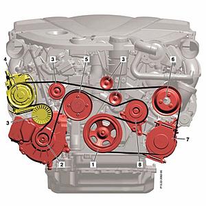

I've got an excellent routing drawing with the dvd star service for the car and i've checked and checked. All the pulleys, Alt, crank, a/c, power steering, hydraulic, wp are grooved. All the idlers (2) plus a tensioner are smooth. It's odd that the belt rides on one idler on the face (grooved side) but the drawing couldn't be clearer. And anyway, if you routed the belt on the back (smooth side) for both idlers, the belt would touch itself going in opposite directions. It couldn't work. And the first belt last months, the others days.
I've carefully checked the wp and all other pulleys for problems and they are fine. When I run the rpms, everything looks fine. The only funky thing, possibly, is the tensioner. As you goose it to 3-4K rpms, it moves an close to 2 inches. I've got an e320 and it barely moves.

Here's the diagram
Old Jul 31, 2011 | 10:16 AM
LewS's Avatar
Joined: Aug 2003
Posts: 98
2004 s600
Actually mine is slightly different. Those two items in gold/yellow are optional and not on my car.

which idler is grooved
Originally Posted by LewS
No. Yesterday I replaced the tensioner and then threw a belt within an hour. It's high rpms when with damage happens and the back side of the belt (the smooth side) is simply ground away in a methodically manner. I'm at a total loss. The only thing I can think of is to insulate all projections near the crank pulley because that seems to be the area where the damage occurs.
in the diagram you posted which idler #3 that is in contact with the back side of the belt is grooved? im assuming that the tensioner was replaced as an assyembly and not just the pulley.so that component is ruled out. if one of the accessorys had excessive drag as you throttle up it should squeal, as you back off the tensioner should absorb the belt slack rapidly. is it possible that an incorrect idler was installed grooved instead of smooth in the wrong position?. if the belt that was originally replaced prior to this had a couple years of service on it and was not worn than it is absolutely your routing. is the tensioner in mid stroke when the belt is installed?

Actually the mercedes part no on the two idlers are the same. They run the grooved side against the idler and the idler itself is grooved.
I may have found it though. In closely examining the alternator pulley, I looks like somehow the face has be pushed in at a spot so the first groove has been collapsed. I couldn't get the pulley off without damaging it and taking the alternator off seems like a huge problem (it's water cooled - whoever heard of such a thing). So I've repaired it. I think the damage to the smooth side was throwing me off. I think that damage occurred when the edge of the belt would get damaged by the bad pulley and then one of the reinforcement strings of the belt who start fraying and it would snag on something and pull off the back of the belt. It seems that these strings are integrated into the belt in a spiral pattern and you can pull it like a string on a fishing reel. I can't be certain yet but drove it at high rpms for a long time and it seems fine. If that doesn't do it, then I'll replace the steering pump.
