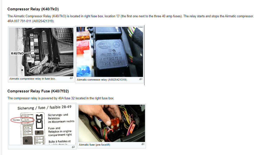

Anyone knows where is the Airmatic compressor RELAY and fuse located?

77 views and nobody can answer this guys easy question?? It is under the hood. Pop the hood and look at pass. side right below windshield. There is a fuse box there.. Open it and there will be a line of square relays in the middle. It's the one on the end closest to radiator (front of the car)

look at the w220 wiki its all there
https://w220.wiki/
