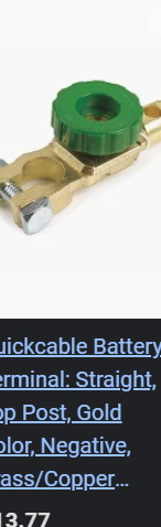

Even with no excessive drain these cars will kill their battery after 2-3 weeks of non use . You can’t keep one of these cars stored and expecting to start up unless you install a remote control battery disconnect . See pic from Amazon attached . Just click the remote And the battery is disconnected and can’t drain
I put these on all my rarely used cars and it solves the issue

oh i got a disconnct thing too for the battery however i got a simpler one

[QUOTE=tusabes;9045478]Even with no excessive drain these cars will kill their battery after 2-3 weeks of non use . You can’t keep one of these cars stored and expecting to start up unless you install a remote control battery disconnect . See pic from Amazon attached . Just click the remote And the battery is disconnected and can’t drain
/QUOTE]
dude i did not know that it can drain. makes sense though. mine runs out in 2 days, so i got disconnecter for battery. however does not that mean the car has to relearn everything EACH time i disconnect battery it appears
It relearns everything after a few minutes of driving and running the windows all the way up and down . The manual disconnect is stupid because you have to open the trunk every time . Get the remote control battery disconnect so you just click the button on the keyfob to disconnect and reconnect
