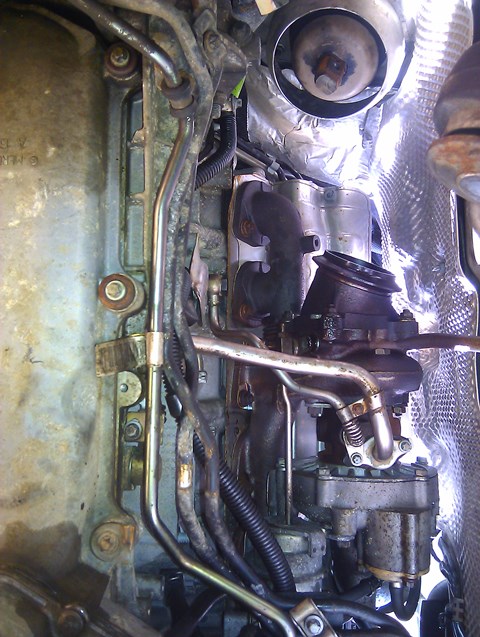

Have any of you guys pulled the turbos yet? Is that possible if you drop the subframe? I think I have one with a bad seal (smoking), so was trying to decide how to tackle it.
Old Feb 3, 2017 | 05:32 PM
  #253
Welwynnick's Avatar
Joined: Nov 2010
Posts: 2,605
Likes: 343
From: Welwyn, Herts, UK
2006 S600
I sure have. I might be able to help you. There are some ground rules with turbos:
Modern turbos are generally robust, and the M275 turbos are particularly well protected.
When a turbo fails, its usually due to an external reason, such as inadequate lubrication or cooling. When you replace or rebuild a turbo, you have to fix the cause, otherwise they'll fail again.
With twin turbo engines, if one turbo fails, the other will usually be close behind. They should be treated as a pair - you don't want them working out of balance.
Turbo rebuild kits are cheap and readily available. A surprisingly small number of kits service the majority of turbos. When I rebuilt mine, there were no kits available, but some people have figured it out now.
Turbos do have seals, but they're not oil seals in the usual sense. They're like piston rings, and are there to keep the high pressure exhaust and charge air out of the center housing, oil chamber and hence crankcase.
Oil is kept away from the "piston rings" by oil thrower rings - nothing else - so long as the centre housing doesn't flood with oil.
V12 turbos have compressor wheels balanced separately, so you don't have to re-balance them when you re-assemble.
The compressor wheel nuts are tightened anti-clockwise, and to a very low and exacting torque. You'll need a special torque wrench (but surprisingly few other special tools).

Awesome, thank you for the information. I plan to start in on this in the next couple of weeks and will drop the subframe to get to them. Since there aren't rebuild kits available do you happen to have a list of the parts needed, or a link to that information? Any help is appreciated.
Old Mar 1, 2017 | 02:03 PM
  #261
Welwynnick's Avatar
Joined: Nov 2010
Posts: 2,605
Likes: 343
2006 S600
Yes, there are rebuild kits available, and they're cheap - search for "mercedes v12 turbo rebuild kit".
It's a generic KKK K24 rebuild kit, like many ordinary cars, but there's one critical piece of information you need to need to know.
It's a small bearing K24 turbo, not a large bearing K24 turbo. I had to figure it out the hard way, but that's all you need to know, and it's for free.
You can't get 360 degree thrust bearings by the way.
