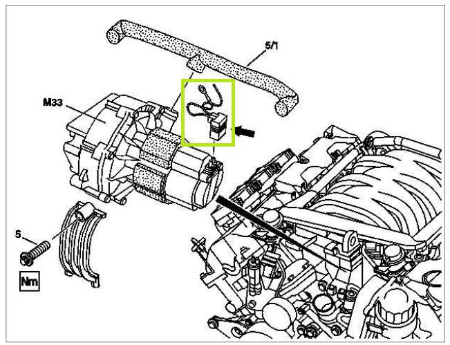

Hi, can anyone know the part number for the connector?
Today, I changed the Coolant Temperature Sensor. Beforehand, I removed the 2nd air pump - every thing is successful.
However, when I reinstalled the pump, the connector cracked and now I use head tube with zip tie as a workaround.
I spent something to look up the part number for this connecter but ain't found it. Thanks.

That is just a simple electrical connector for the ground/earth connection. A replacement should be available at any auto parts store - it doesn't have to be visually identical.
Thanks - I just need the plastic cover - now it's okay but not nice. For safe, I may tea dielectric grease to the connector to safeguard no short circuit/spark or sth.
Next Monday, I check the supplier nearby and see if stock is available. I read the underneath photo at ebay, but cannot see the part no. cleary.

post your vin
or send it by PM

VIN# WDB 210 0622 B 232815
Old Nov 22, 2020 | 02:33 AM
BenzNinja's Avatar
Former Vendor
iTrader: (5)
Posts: 2,973
Likes: 955
here you go
